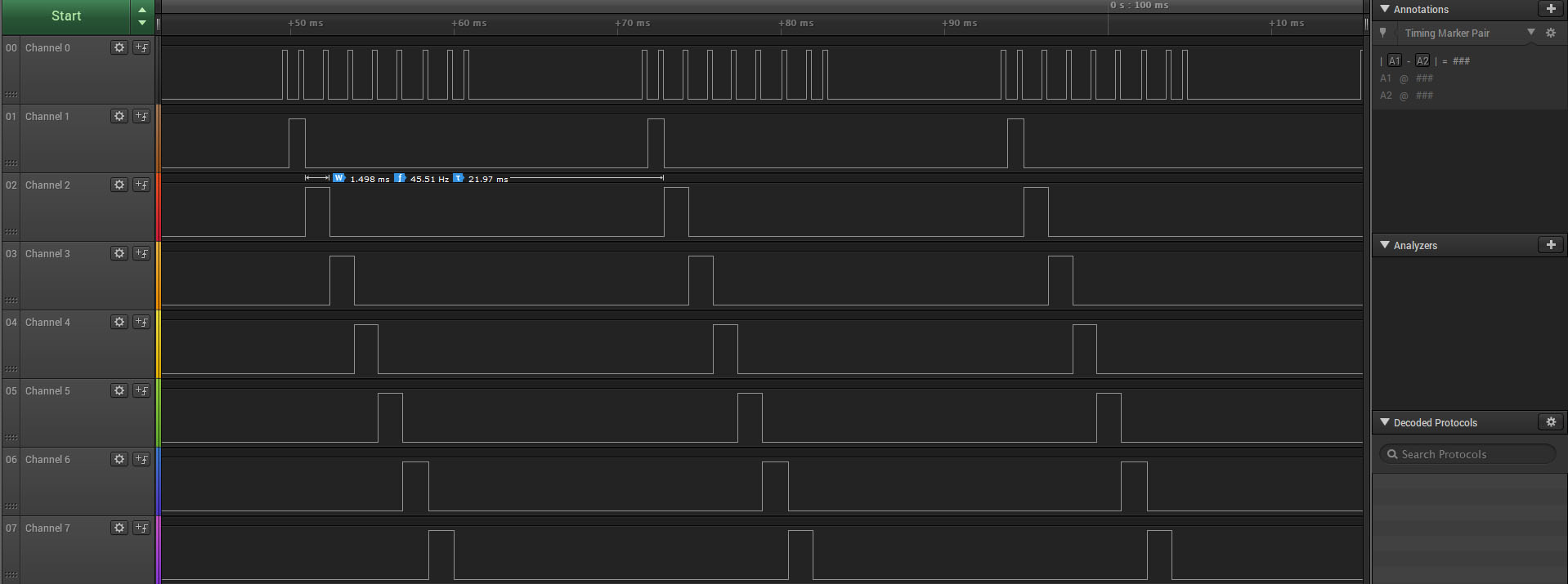

My scope seems to be having some difficulty locking onto a stable PPM output display. I can still see the pulse train, but it's almost like the timing isn't stable enough for the scope to lock in the display. Could this be the difference between timing with a resonator versus a crystal? Or am I on the wrong track?Phil_G wrote: 30 Apr 2020, 10:51 Reds are great for experimenting but the DIY-More Strong board is the best we've found so far, its smaller, its integrated, it uses a crystal rather than the 16mhz resonator on the Nanos,

Phil_G wrote: 01 May 2020, 10:05 To display stable PPM on a scope you need a sync per frame - my siglent has 'trigger on interval' which I set to 3ms. That gives a rock-steady display. You cant trigger on pulses as they're not contiguous.
Alternatively get the encoder to output a separate momentary trigger pulse on a spare pin during the sync.
I just got a Hantek DSO5102P scope a few weeks ago, and I'm still learning to use it. In fact, this conversion project was the perfect excuse to finally buy a scope. I'll look for the "trigger on interval" function instead of relying on the "Autoset" button.

I often use either a cheap logic analyser or a Picoscope digital storage scope, both are USB devices that you connect to your PC and can save traces to disk so that you can view the ppm frames afterwards, though I appreciate the logic analyser can't view in real-time. But as the logic analysers only cost around £12 from a UK seller, I think they are an affordable option. In fact, you can get them for around £6 from Banggood, if you shop around and don't mind waiting.
https://www.ebay.co.uk/itm/Logic-Analys ... accbae84ea
The Picoscope's are a lot more expensive though! You can pick up working second-hand ones on eBay for a reasonable price, the latest software still supports all their models including all the old ones and I can't fault mine, though I would love one of their newer and faster models.
Both can decode SPI, I2C, serial (and hence S-BUS) etc, so are very versatile. Where my Picoscope loses out is that it is only 4 channels and 20MHz, any faster and the old "steam-powered" Tektronix scope has to come off the shelf.
