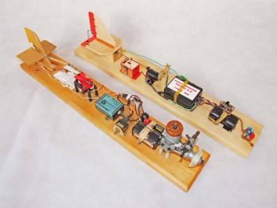

Here's a couple of demo rigs we use when we give our talks and demos... Always a source of amusement to the younger modellers who think it's a bad case of interference. :lol:
Rand and a home made Mighty Midget Actuator plus a rare REP one
Demo rigs showing the full airborne compliment of equipment required

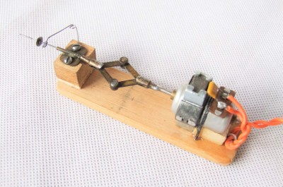

Home made Flyball Actuator
A home brewed Fly Ball actuator. Surprisingly powerful but wasn't a batteries friend. This was a very early design capable of proportional output

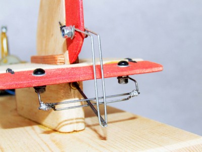

The tail end wire work, known as the birdcage for the Mighty Midget set up
Known as the Bird Cage, this wire bending was necessary  to translate the motion of the Mighty Midget motor to rudded and elevator movements
