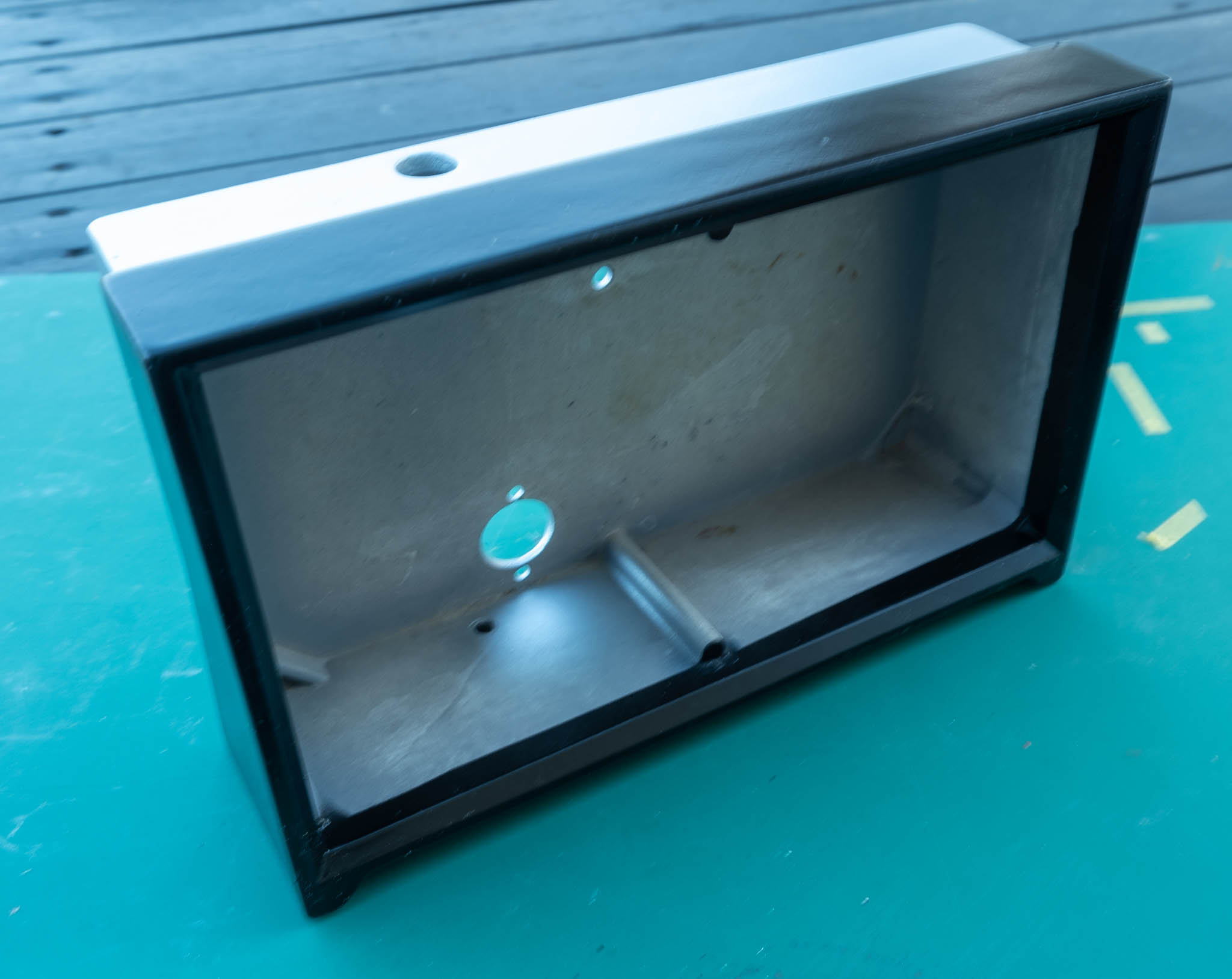

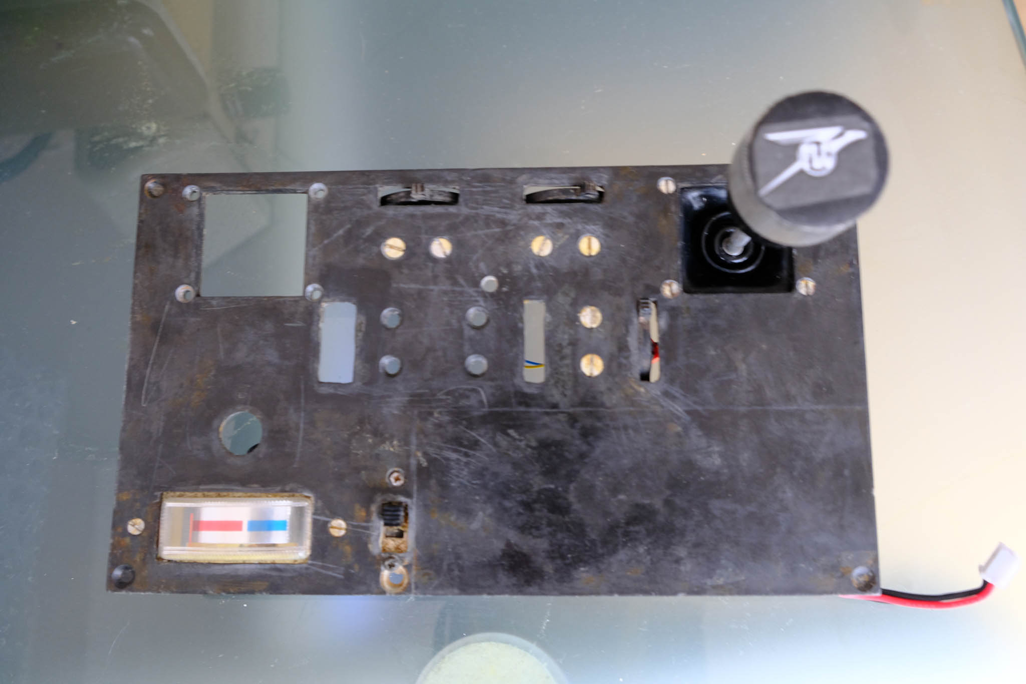

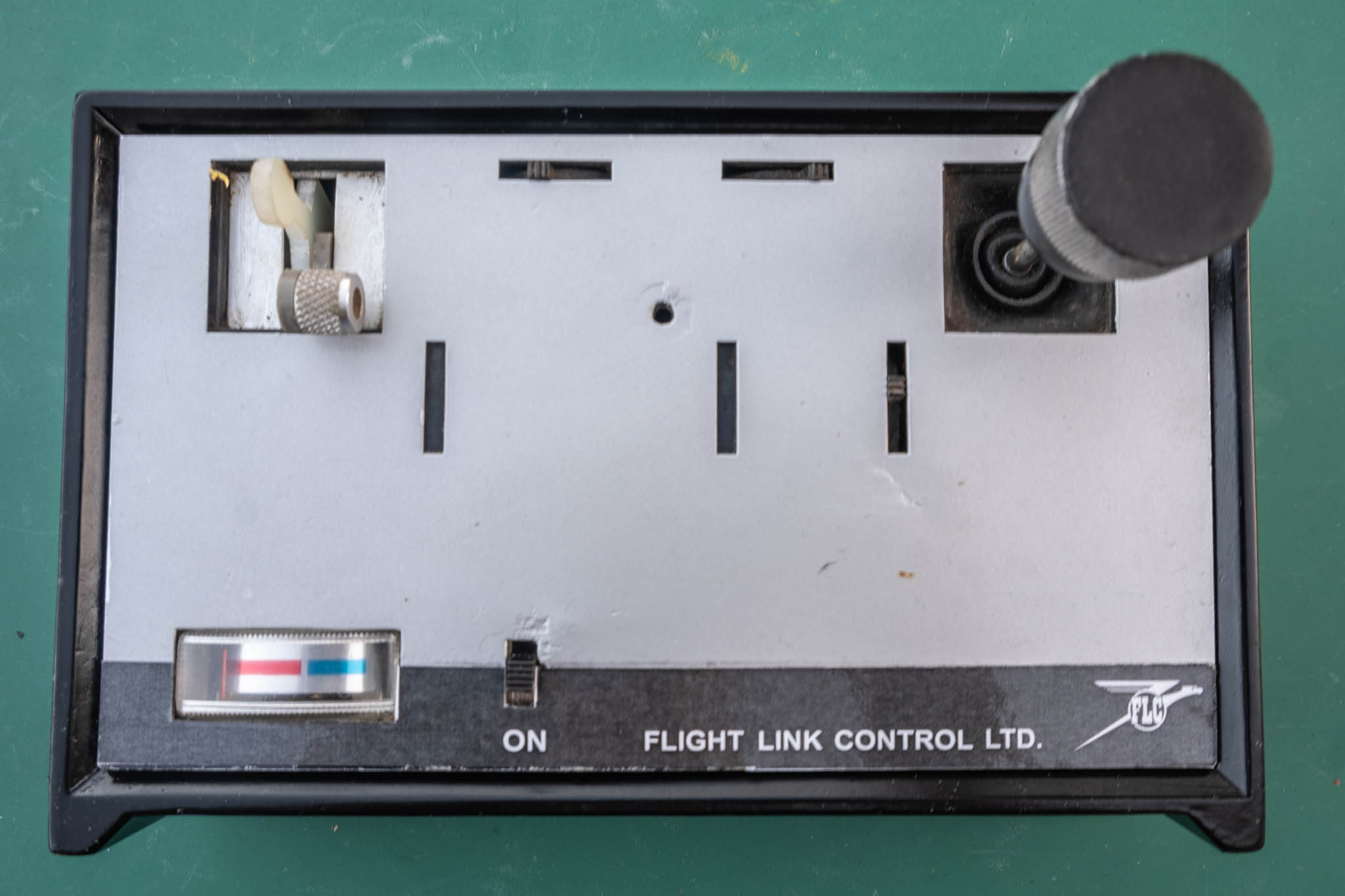

Unmasking to reveal the Satin Black and couldnt resist inserting the mechanics into the case for a bit of a Reveal and see the overall effect of the case refurb!
Now to crack on and finish the pot to encoder wiring and RF module install....
- Posts: 591
Re: Flight Link Control Series 4 Restoration

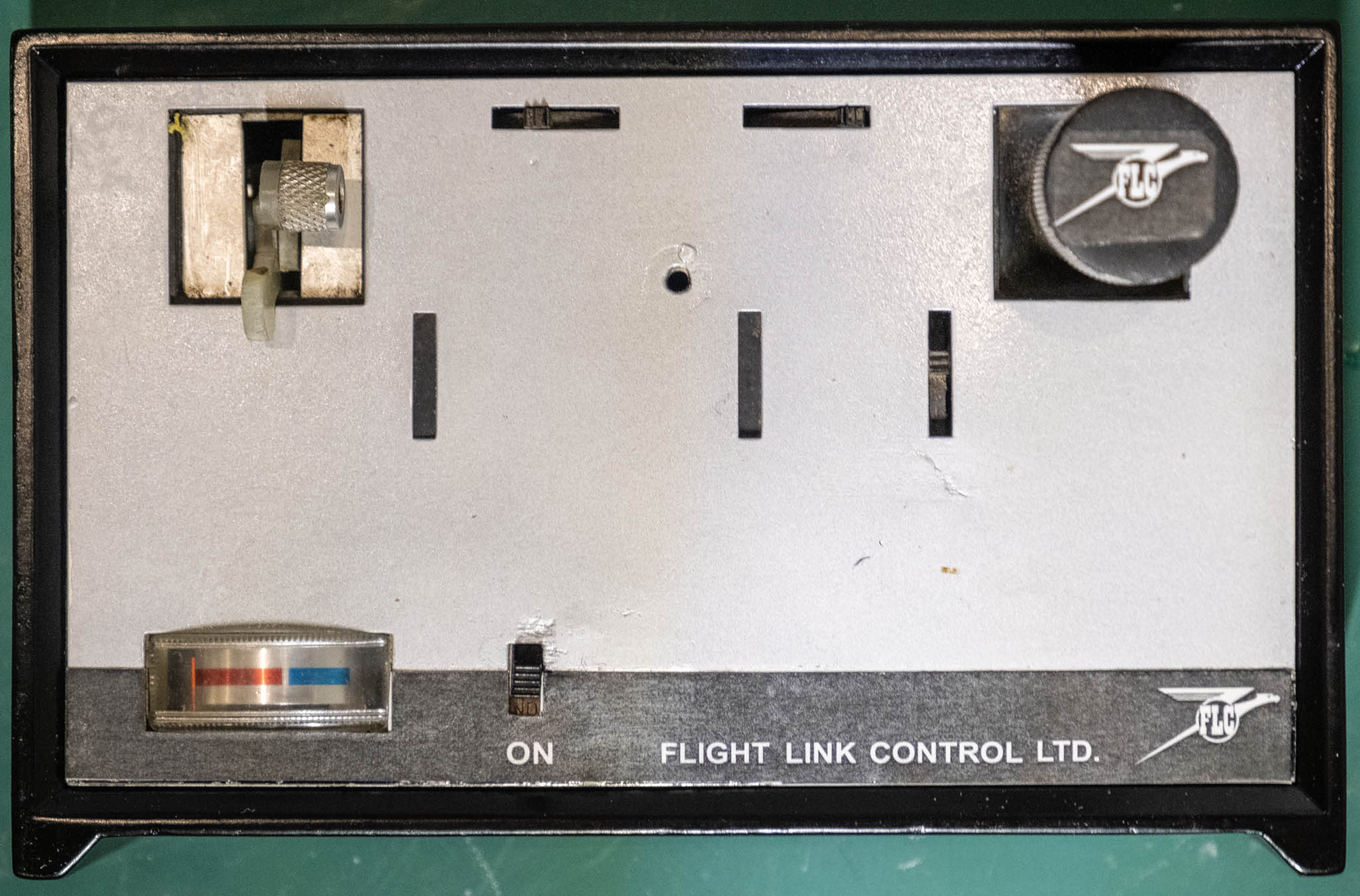

Oops I forgot to add the sticker on the end of the stick!

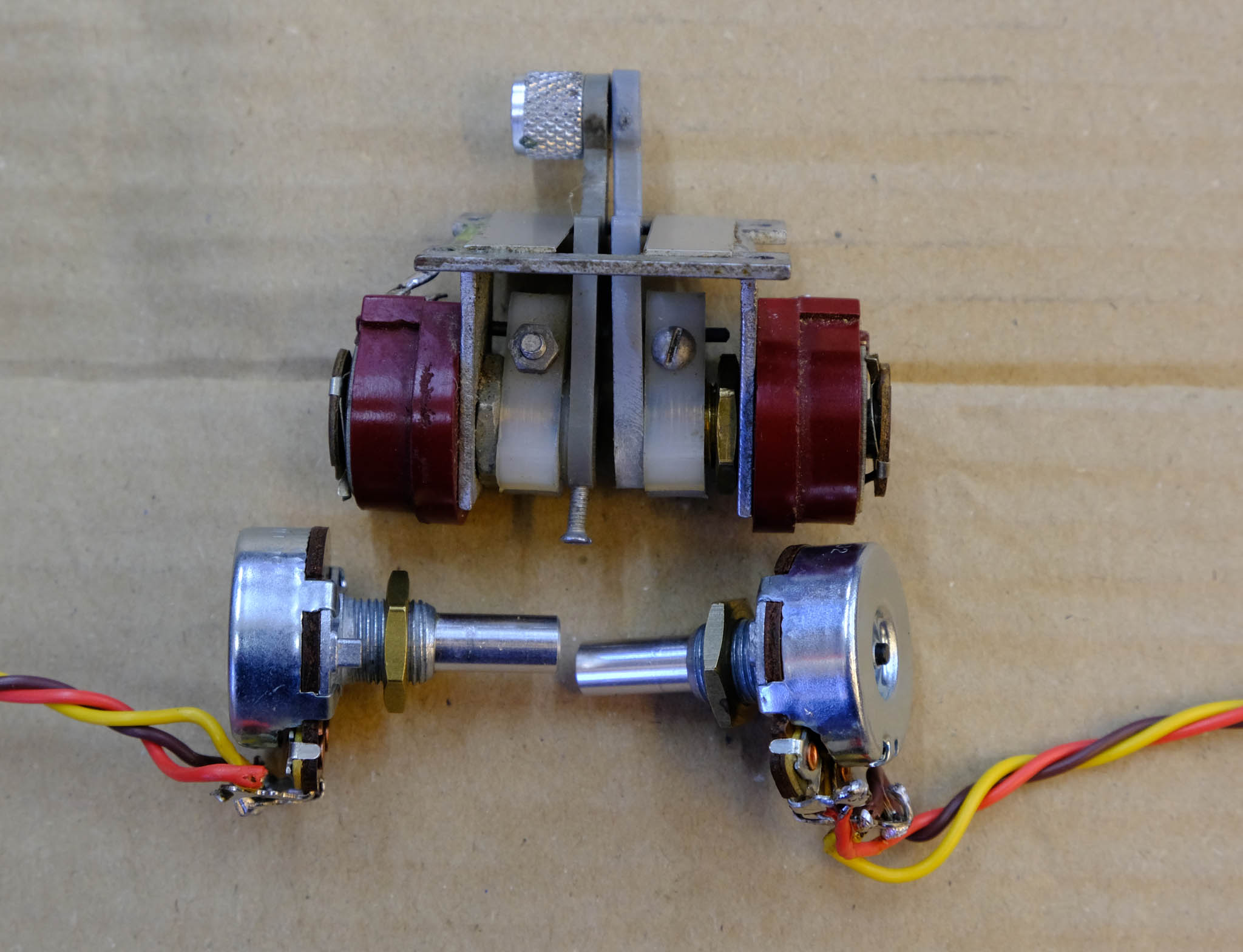

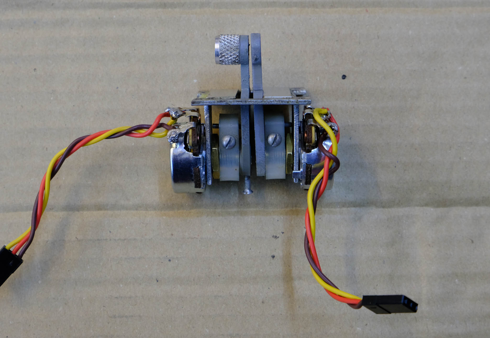

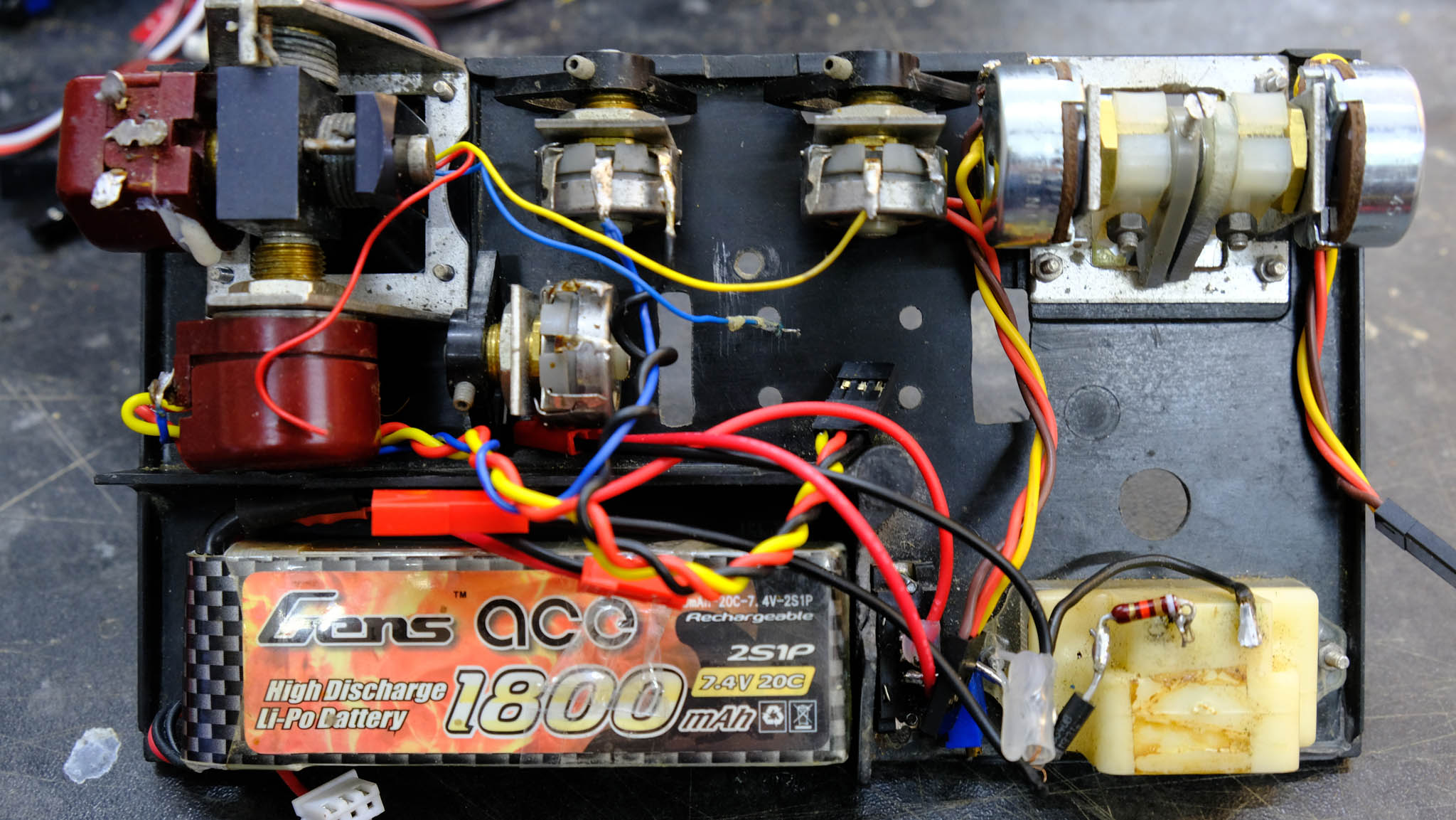

Slowish progress on the mechanics, it looks like the Flight Link throttle and aux pots are either broken or designed to be 30 Megaohm at one end!!
So new pots were installed after much discussion with Mike K
The three axis sticks are 10K so will require some tweaking of the ballast resistor values to get the trims working correctly.....so thanlks to Mike and his calculator, have some 10K resistors on order....
Anyway here is the latest on the mechanics, probly not a lot of visual difference apart form being cleaner and tidied up all round.....oh and the meter works full scale on the 2s Lipo
