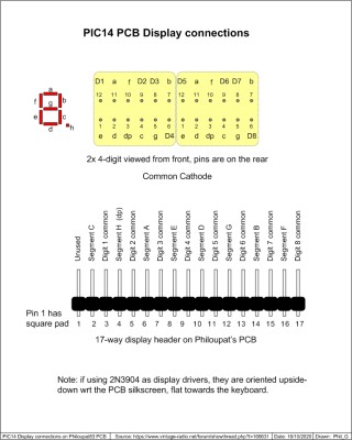

Edit. I should have checked before ordering. Philoupat's (877) board is laid out to take the vintage Antex SK-3-307 9-digit 7-segment calculator display module. I'm going to have to make an adapter board to unscramble its 17 pins to suit more modern (and cheaper) displays. I think I'll go for eight separate 0.28-inch 7-segment displays.
I'll let you know when they arrive. The smaller ones cost me about £4.50 each, and the larger ones just over £6 each.
If you know anyone else who wants one of either type, let them know I've got some on the way...

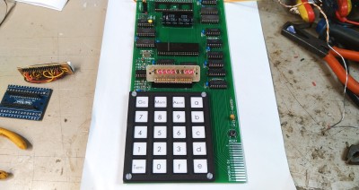

Re: SC/MP National Industrial Basic Language (NIBL) Retro
No its ok we use a display board that takes these displays: https://www.ebay.co.uk/itm/265676476236
Chris Oddy does the display PCB, free with any other purchase, about halfway down this page:
https://www.theoddys.com/acorn/shop/mk1 ... _shop.html
The SIP pinout is standard, most old common cathode calculators Texet etc fit. Note the very left pin isnt used.
Its usual to fit a header so the display can be unplugged.

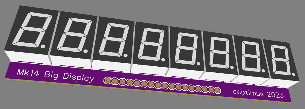

- Posts: 787
Oops. I'd already designed and ordered this monstrosity before I saw your post.
But perhaps it's just as well, because I'd already ordered some of the correct size for that (0.28-inch) 7-segment displays.
The board is 104mm wide by 25mm high. So wider than the Mk14 itself - the PIC version anyway, and I guess the vintage one too. I'll bend the header pins so it sits at a comfortable angle to the main board for viewing - I don't think it will clash with any other components or connectors - but I could always raise it up higher if necessary.
It was a cheap board, so I've ordered twenty of them - just in case any venerable Mk14 programmers with ailing eyesight might want one!

- Posts: 787
No problem Tim, once the bits have arrived (it might be after Christmas now, for some of the components from China) I'll build some display modules and post some pictures/YouTube videos of them working in this thread.
Then I can post one to you, and to anyone else who wants one.
Mine are sockets on the PCB, pins on the display.
I'm not sure if Trevor Hamblett ever posted his display gerbers, or if its just an agreement with Chris.
It does make a very neat job with .28" displays.

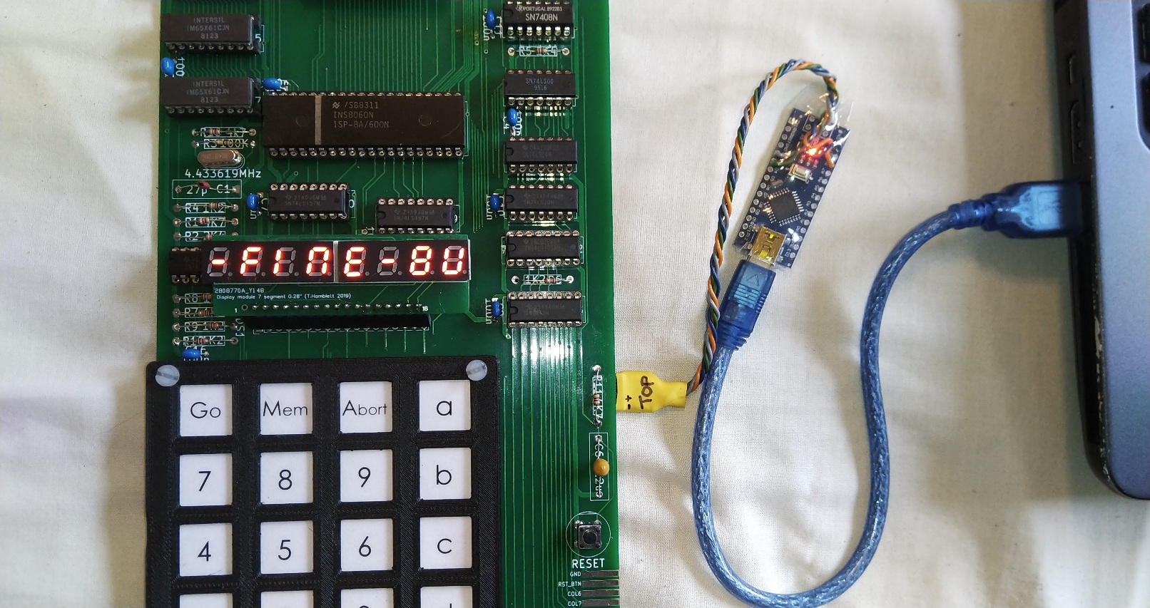

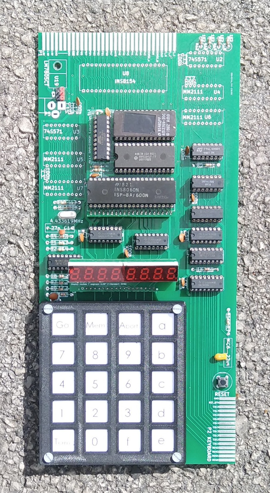

- Posts: 787
All the bits arrived, and I got them working.
I forgot to peel the protective film off my 'Big Display' 7-segment LEDS before I filmed that.
It's easily the clearest one to read in real life, though it doesn't look like that in the video.
For the Philoupat design I swapped out the BC547 NPN transistors (common cathode display drive, and keypad column select) for N-channel MOSFETs after reading Karen's comments about display ghosting when running some programs - and her recommended fix of fitting 10nF capacitors across the base resistors to make the transistors switch faster. The FETs switch really fast, and there's no need to fit base resisitors - I just fitted wire links.
Simon Merrifield's design has a ULN2803 Darlington driver chip in place of the transistors, and I built the Budgetronics kit up as supplied with the standard BC547 transistors and no 'base capacitors'.
Let me know what bits you'd like, guys. I've got 4 spare PCBs for each of the Simon Merrifield and Philoupat designs, and 19 spare 'Big Display' PCBs. I also have enough 7-segment displays, FETs, chips, etc. to build up some short kits, or assembled boards, if that's what people want. I'll work out some prices if there's any interest. I'm not looking to make any money from these - just recover the cost of the parts.
