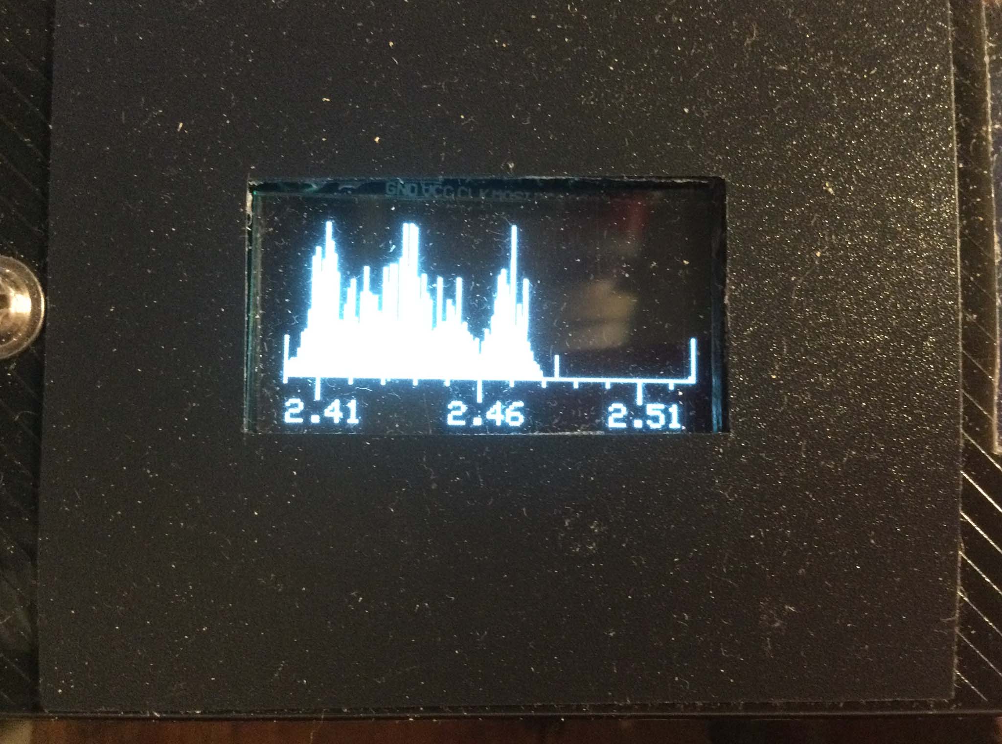

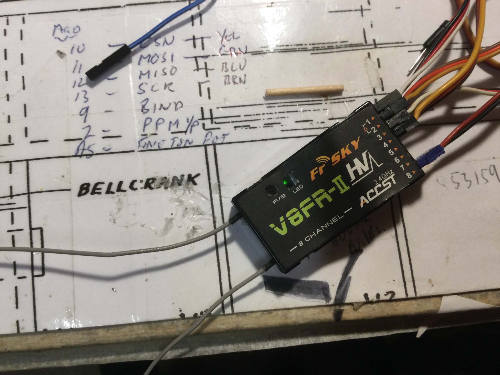

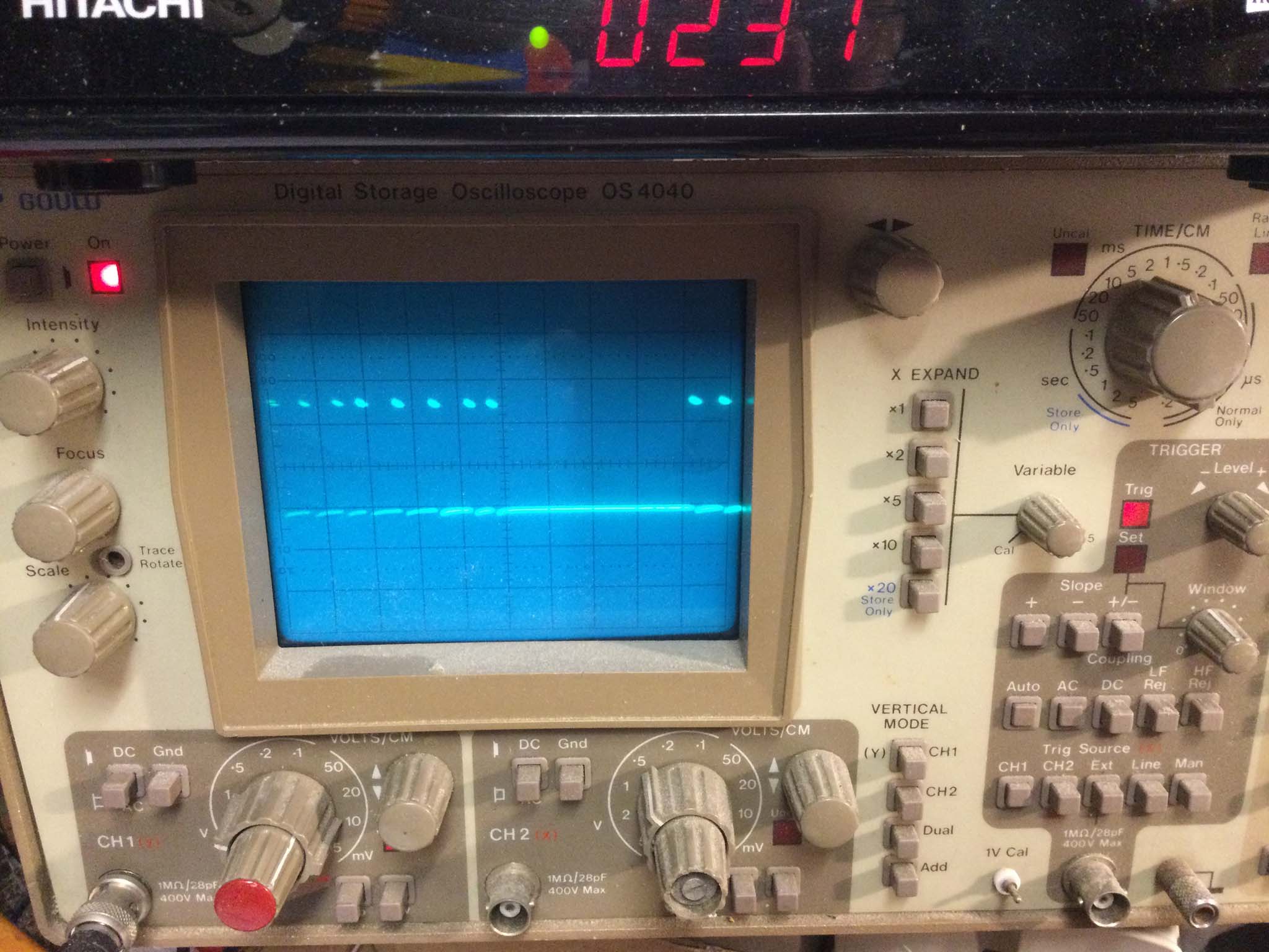

Still not having luck here with this.
Set up for serial monitor ok but no indication of channel ppm input with either Taranis or A Phil G encoder input.
3 attached pics show a good bind to the CC2500, a good 2.4GHz output on scanner and a good ppm pulse train input to arduino.
Scope settings are 200 microsecs/cm (giving a pulse frame duration of 1800 microsecs) and 1v per cm pulse amplitude (2.5v pulse).
Scope shows pulse width variation with pot movement but no movement of servos on receiver.
