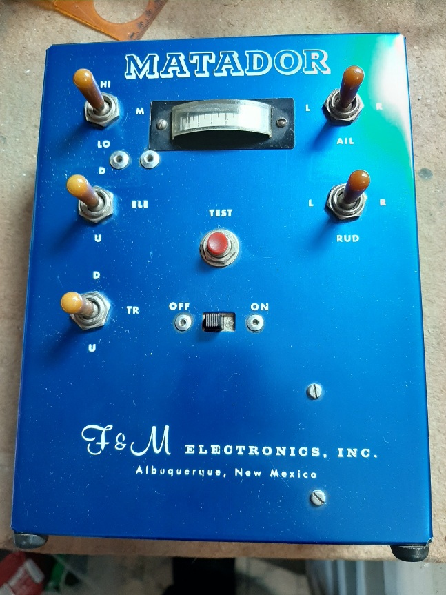

I Have a F&M Matador Tx with a Midas Rx and Boner Servos, I am trying to make it work but found some of the frequencies overlap.
I would like to know if is there a safe and preferred procedure for tuning the radio.?

Hello Luis,
Take the rear cover off and identify the 10 pots that adjust the 10 tones. You may want to mark them to make adjustments easier.
The pots can get noisy/dirty with time so sometimes they will need to be cleaned using de-oxit and rotated to "exercise" them. But before you do that, identify which toggle switches are actuating their respective reeds properly, and focus on the ones that are not. There is some overlap between the adjustments so normally all you have to do is re-adjust one, or maybe two of the pots. Each pot is padded with a tone capacitor, and sometimes, the caps can get leaky and cause the tone to drift so far that the pot cannot bring it back on frequency, so you may have to replace the corresponding cap.
