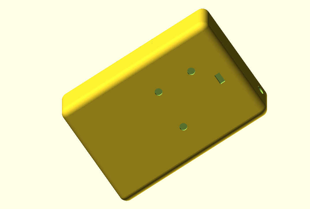

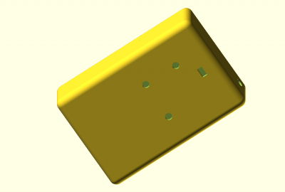

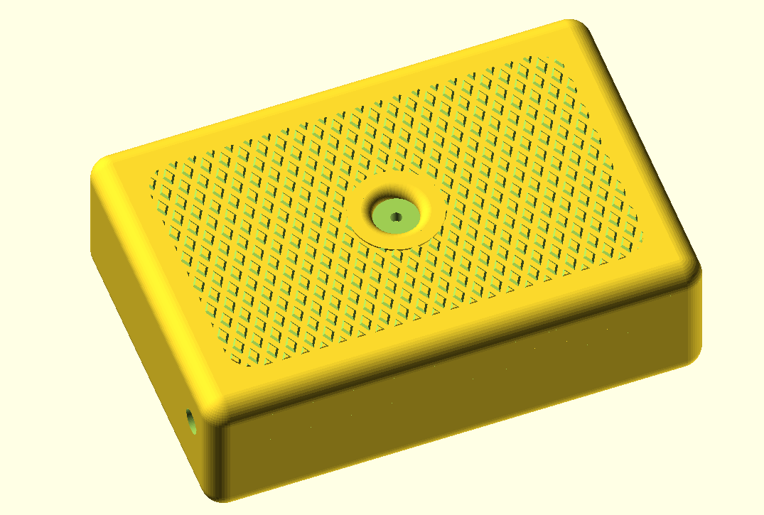

Without knowing the actual measurements I estimated the size of the case and made a drawing for 3-D print.
As soon as the actual size is known, I will revise the drawing. Cheers

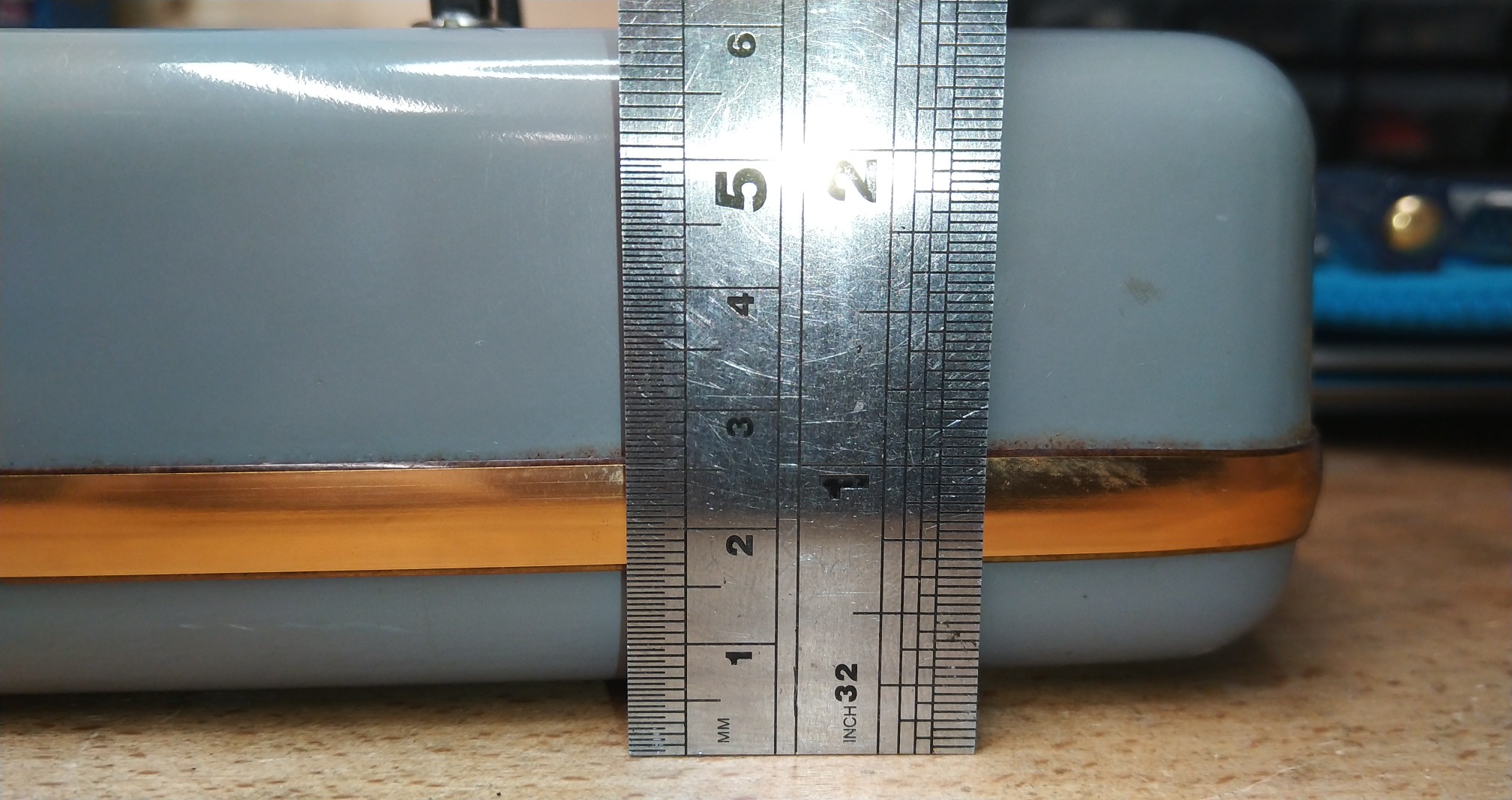

For Frank, the dimensions are 180mm x118mm and 60mm deep.

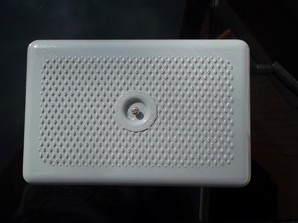

The rear has a pattern of raised things like dimples but outwards, that I dont know the word for - so I'm going to call then undimples
They project a couple of mm. The rounded corners are about 10mm radius.
Here's the brass band joining the two halves, this is laid flat in the bench supported by the undimples

Phil, when you have the time, could you please give me the size of the Ariel 6 transmitter that I can dimension my replica accordingly.

Thanks Phil, got it.
The drawing is resized and available in the 3-D print section.
However I do not have a printed example for the time.
viewtopic.php?f=72&t=1218

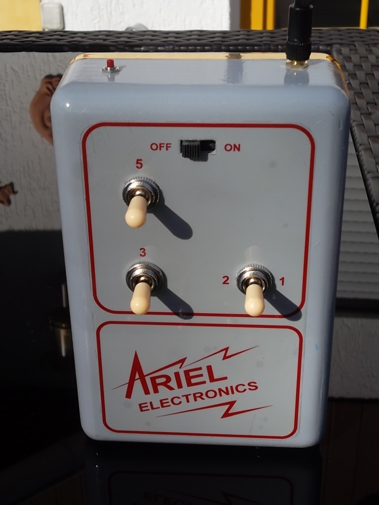

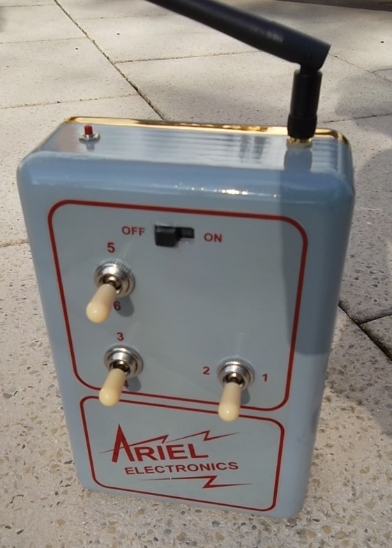

The Ariel 6 channel reeds Tx with the 3D-printed case is finished.
I made two versions, one with the NRF24 HF unit and the other with the new Lemon DSMX module.
Both work great. They are basic 6-channel reeds sets, no gimmics beside servo-reverse and low voltage alert.
Test flights are already finished using my old Graupner Kadett. No problems at all. Cheers

That’s a lovely construction Frank , can you divulge your secret of making such splendid finish on the 3D printed case ?
- Posts: 406
Re: Ariel 6-Channel Reed Set
The finish is by far not perfect. It´s just two layers of sanding primer and three layers of grey spray paint sandet in between.
The decal is printed on self-adhesive transparent vinyl. That´s it.
