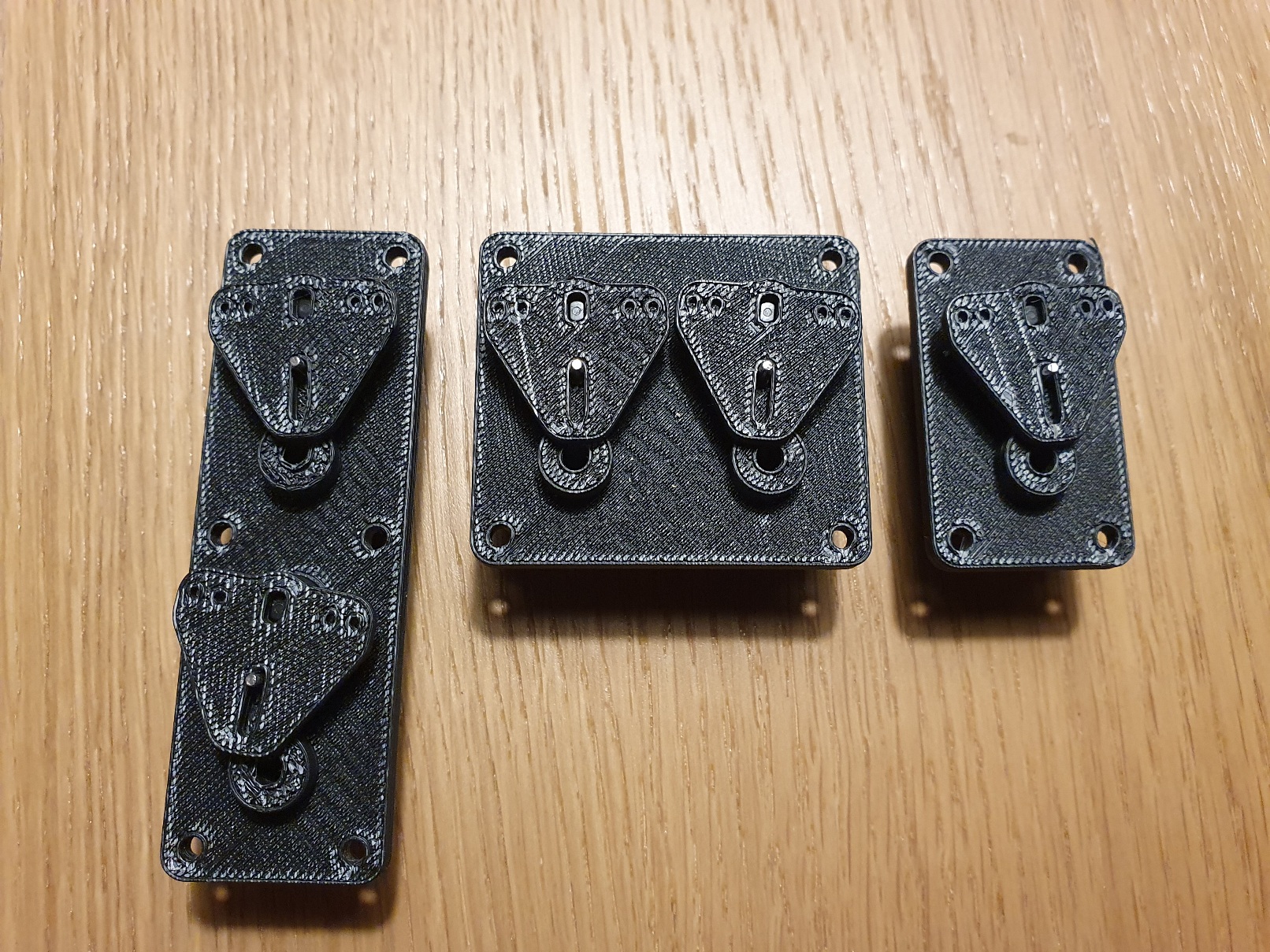

The ProPo project, a DIY proportional servo

Re: The ProPo project, a DIY proportional servo
To Paul:
.stp files are not suitable for printing just for CAD work but they can be converted in a CAD program to .stl files which are files your slicer will work with. I have included here the proper files as a curiosity as I can only guaranty they will be right in my printer and with ABS which for this one I use a high end printer. See PM
To Phil:
One of my "easy peasy" are strain wave/harmonic drive gearboxes as I have use them in several Med Tech & URV's project in robotics and I have a few solutions which are unique and proprietary unfortunately but maybe one day...the key is that they will hold position w/o any power and works as good in booth directions. Some of the older Bonner Digimite RS utilized a strain wave gearbox and was one of the reasons Bonner closed down, patent litigation. They were used by the military contractors of the time in "sight system" as they are extremely precise and no play.
To Martin:
This project is based on simplicity and with just 2 moving parts and everything else from over the counter. ..and yes I have a linear one in the pipe also that one extremely simple. Here follows a PID-based servo amp
To Mike:
I found an old Futaba servo and running it's amp and it work fine
Tobe - I really like the 2 dual-servo configurations you've shared, something very retro but practical/serviceable about them ;)
