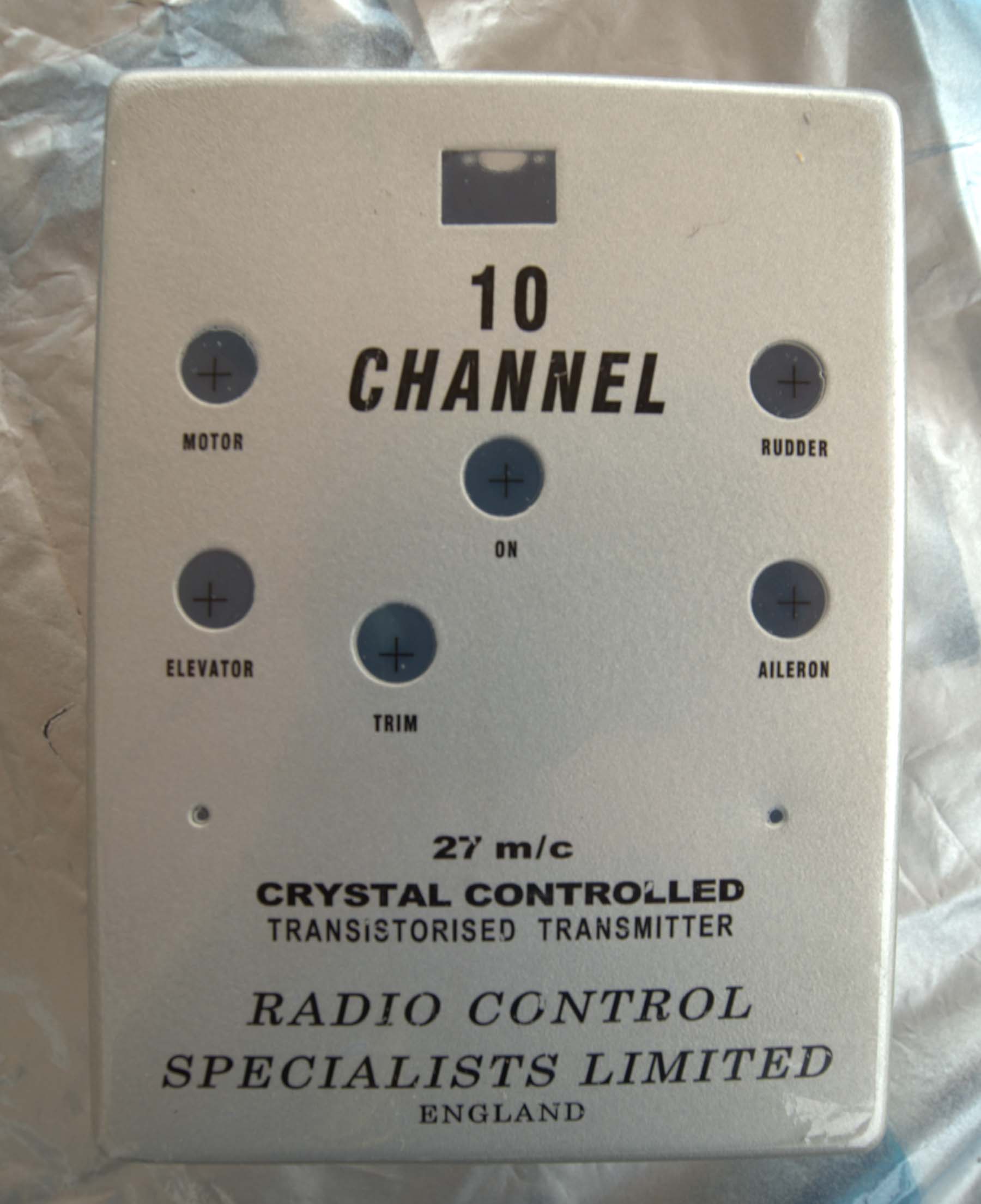

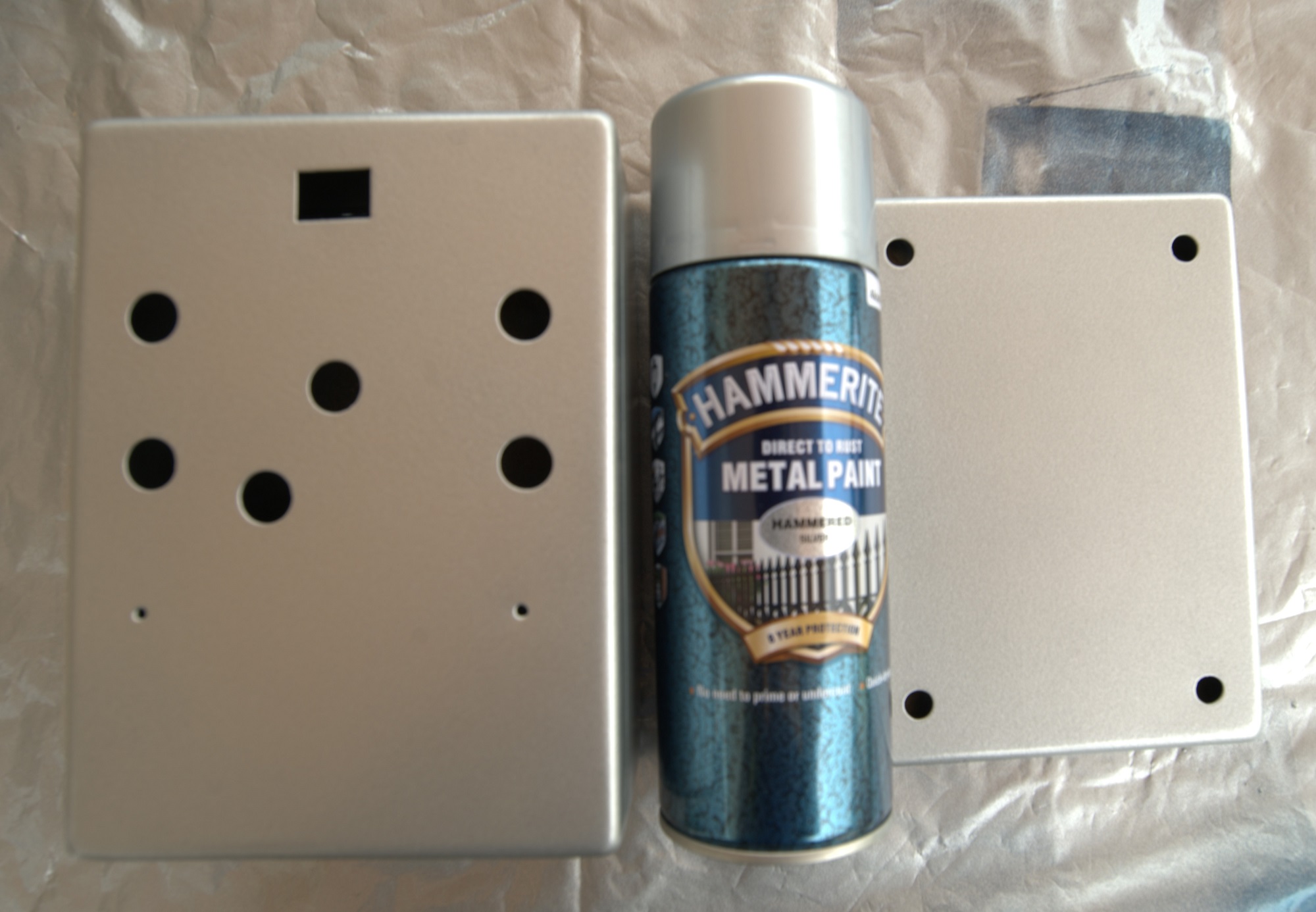

Wasnt happy with my brushed Hammerite finish, so a rattle can was procured, all the paint sanded off the exterior using a orbital sander and then primed, cooked in the oven for an hour, at 50C, followed by two coats of the spray Hammerite silver, oven baked for half an hour at 70C and then the laser printed decal applied, results are as below!

Looks like a new one. Well done.

That’s looking good Stuart , hammerite is not one of the easiest paints to apply and your results are excellent..
Are the decals printed on a clear sheet and applied as one ? Or individual?
- Posts: 596
Re: RCS 10 Channel
Single sheet, trimmed to size, applied using drop[ of washing up liquid in a spray, left to dry, then another clear sheet laminated over the top to protect the laser print.RobertC wrote: 04 Jun 2021, 21:00 Are the decals printed on a clear sheet and applied as one ? Or individual?

Re: RCS 10 Channel
They have turned out well , laminated sheets are very good and cannot see anything of them at all..
Brilliant Job
Brilliant Job

Re: RCS 10 Channel
Would there be a link to the sheets at all..??

You'll be ready to start switch twitching in no time Stu.
Re the decal the other option is to apply the laser printed vinyl sheet to the tx than spray the whole case including the decal in clear polyeurothane varnish. My RCS 10 tx is around 10 years old now (it uses the mk 1 pic encoder) and it still looks as good as new.
No chance of air bubbles this way (when laminating the second sheet of clear vinyl on) and it's thinner.
In fact it had an outing yesterday when Phil, another pal and I went slope soaring to Baildon. I gave my new Graupner Amigo an airing on Reeds.

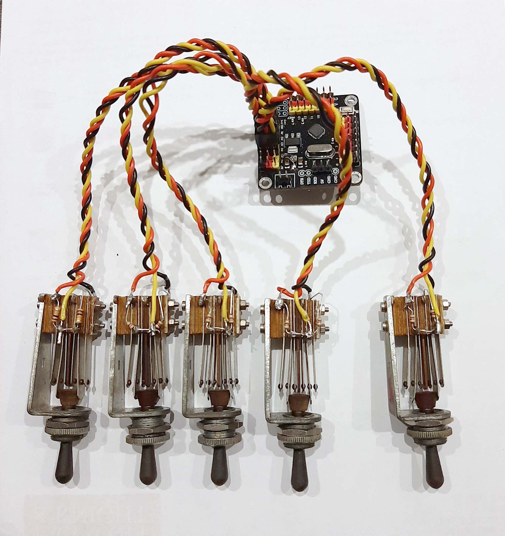

Re: RCS 10 Channel
Started on the wiring tonight, thanks to Phil and Mike for pointers and pics which sped everything along nicely.
