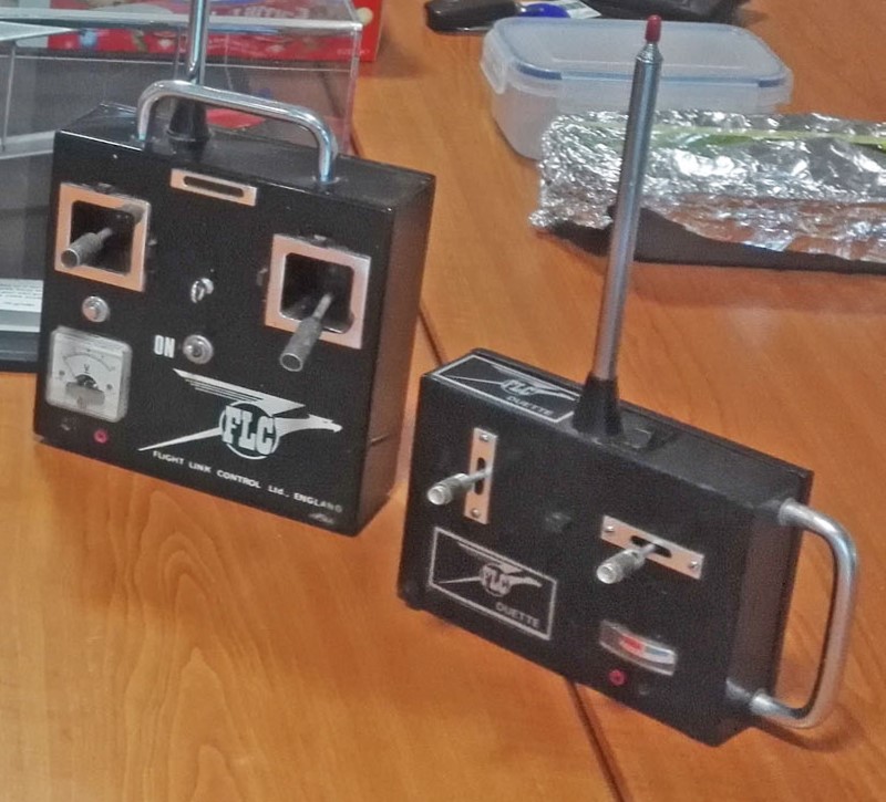

Also Phil thrust his Fablon covered Duette into my hands at Ponty, with me promising to return it to him in "Restomod" form in due course.
We had a bit of a discussion about the handle fitted to one side, with me believing it to be an after-market mod by a previous owner, well searching the forum, I see that Mike Kitchen's Duette is also equipped with such a cupboard door handle as Phil's Tx, so I am left thinking that it was either a factory mod for the boat modellers not wanting to drop their Tx into the Oggin or a complete co-incidence that Rudder and Throttle equipped Duettes were fitted with a handle. The restored one doesnt have any sign of it being fitted and also has a self centring left hand stick, so maybe aircraft ones were without and surface Tx had them fitted by the factory???
Anyone with more info on this quirk??

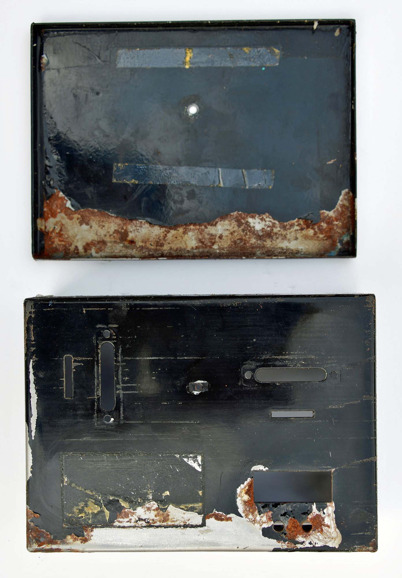

Here is Phil's Duette after a strip down and before a visit to the powder coaters

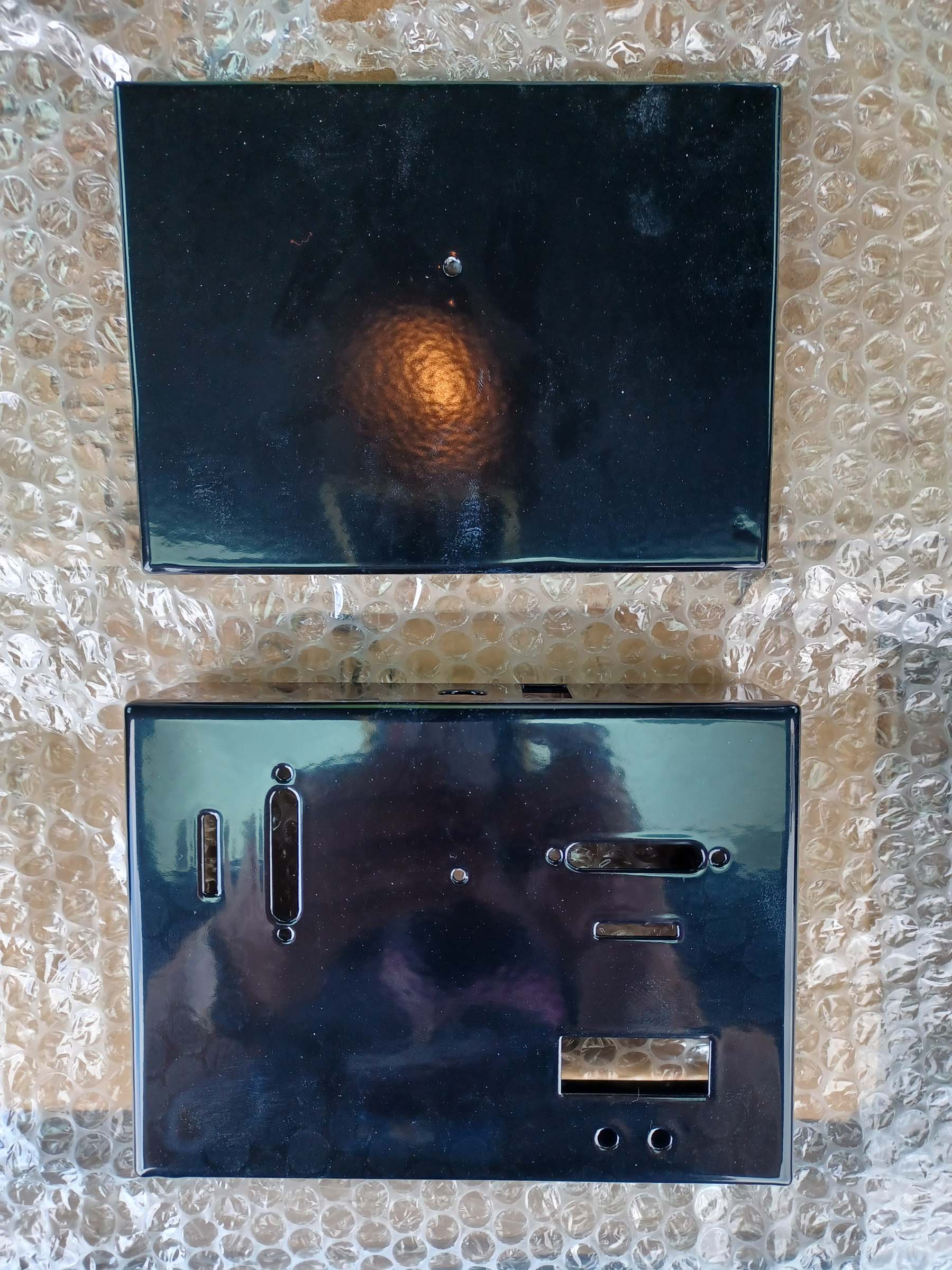

Just collected Phil's Duette from the powder coaters

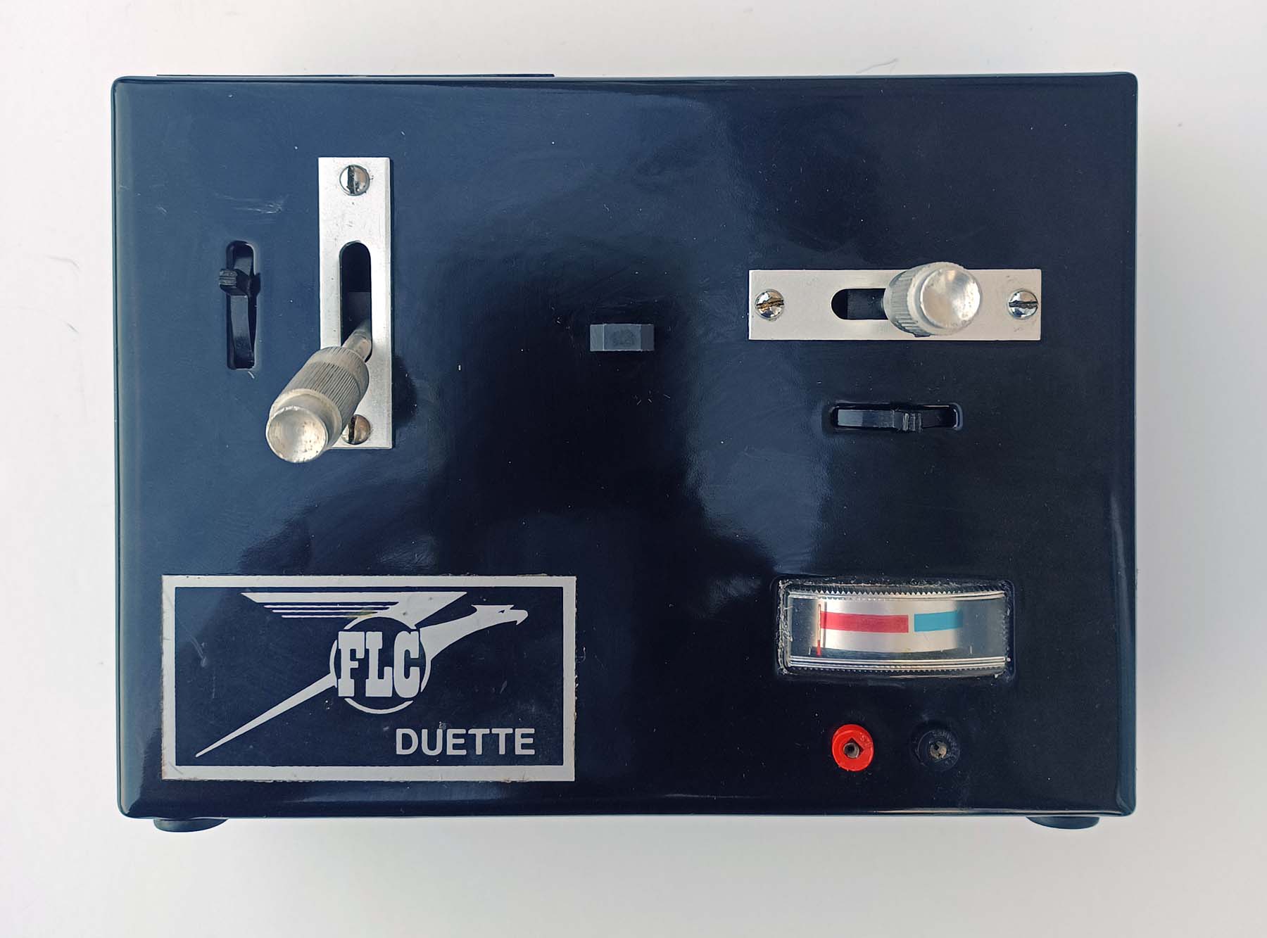

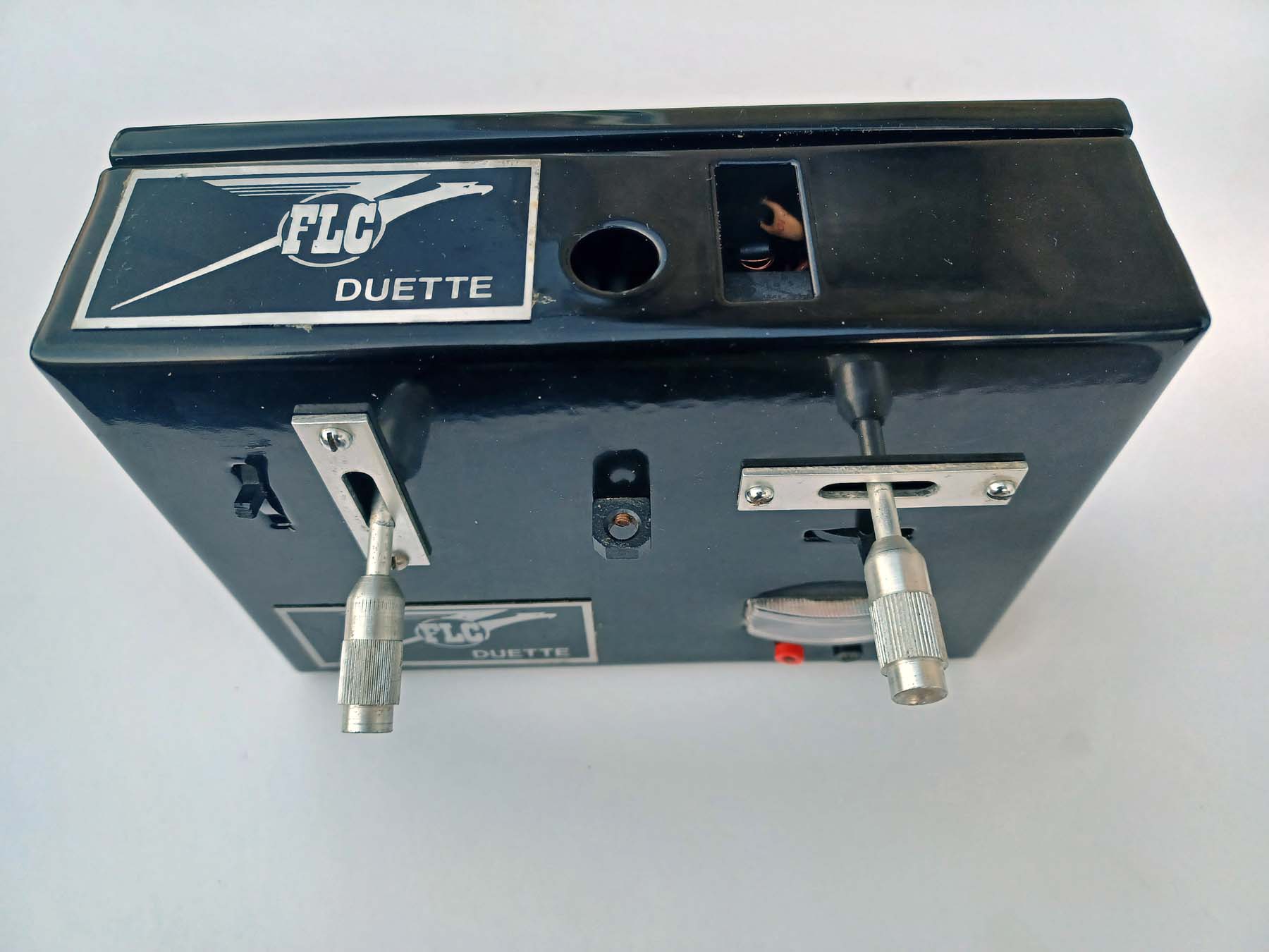

Over to you now Phil for some NRF magic!

Wow. looks really good - especially after seeing the before pics.

What a fantastic turnaround and renovation Stuart, bloomin great , I bet your chuffed Phil ?
Your opinion please on the finish and quality of powder coating to original stove enamelling ..
- Posts: 596
Re: FlightLink Control Duette
Thanks Rob! Hopefully Phil will be able to comment more as the Duette should now be back in his possessionRobertC wrote: 14 Jun 2022, 12:19 Your opinion please on the finish and quality of powder coating to original stove enamelling ..
Powder coating has a thicker film thickness that stove enamelling doesn't seem to have and a skilled painter is needed to avoid orange peel in the finish. Stoving gives a more even coating but probably not such a good edge coverage as powder. Gloss finish of powder is pretty indistinguishable compared to something like my sovereign or series 3 transmitters which are stoved.
Powder feels like a more durable finish but that is purely subjective and certainly has more chip resistance than my other Flightlink txs.
Hope this answers your question?
