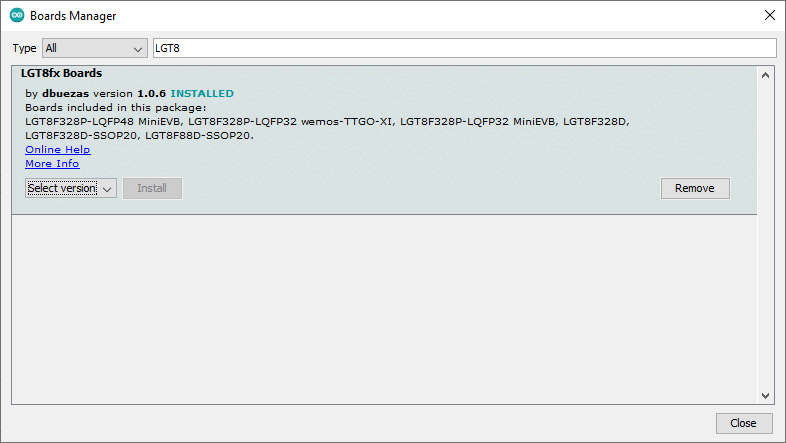

Menu bar => Tools => Board => Boards Manager...
In the text box near the top that says 'Filter your search...' type LGT8
You should see LGT8fx Boards by dbuezas. Install the latest version. It was 1.0.6 at the time I wrote this. Click image for larger view.
Click the Close button to close the Boards Manager window.

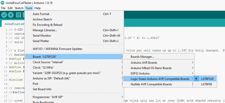

Menu bar => Tools => Board: choose the options shown below. Click image for larger view.
You may not see 'ESP32 Arduino' and other options unless you've already installed additional board managers for those. 'Arduino AVR boards' is there by default (and you'll choose that to go back to programming normal Nanos, Unos, etc.) and the one you need here is the 'Logic Green Arduino AVR Compatible Boards'.
Choose the Board: option first, and then the other Options for Clock Source, Clock, Variant, etc. will appear. Set them as shown in the image above. Make sure you set the Programmer: option to 'AVR ISP', and NOT 'LGTSWD mkII as ISP'.
If you're using the board with the square chip with pins along all four sides, then Variant: should instead be set to '328P-LQFP32 (e.g. MiniEVB nano-style and WAVGAT)'.

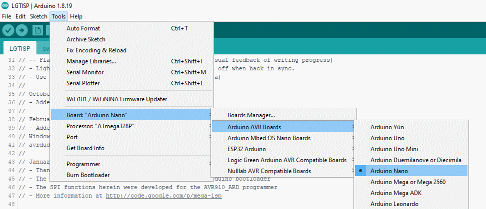

  1. If you set up your Arduino IDE for LGT8F boards, turn it back to the normal Nano for now (click image for larger view).

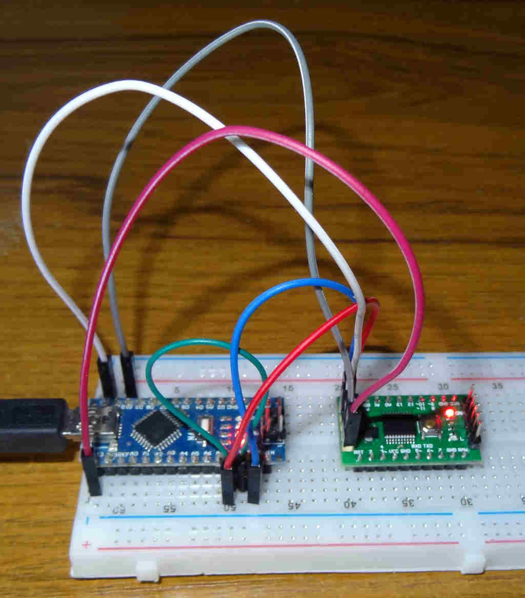

  5. Now set your Arduino IDE back to being configured for the LGT8F328P, as described in my previous post, and open the nickelFourCellTester sketch, ready to upload to the target LGT8F328P board. The 'Port' option under the Tools menu should still be set to the port of your LGTISP programmer (your Nano).
  6. Link the Nano's own RST pin to its own 5V (VCC) pin (green wire in my photo).
  7. Link the Nano's D10 to RST on the target LGT8F238P board (grey wire in my photo).
  8. Link the Nano's D12 to SWD on the target LGT8F328P board (white wire in my photo).
  9. Link the Nano's D13 to SWC on the target LGT8F328P board (purple in my photo).
  10. Link the Nano's GND to GND on the target LGT8F328P board (blue wire in my photo).
  11. If the target LGT8F328P board is not powered separately, link the Nano's 5V (VCC) to VCC on the target LGT8F328P board (red wire in my photo).
    Click for larger view.
  12. All the necessary pins on the target board are available on its 'programming' connector. If you're only programming the battery checker sketch, there's no need to solder a connector in - just hold the wires temporarily in place. The pins on the LTT8F328P connector are labelled on the back of the board. In my photo, front to back, they go: SWC, RST, SWD, VCC, GND.
  13. From the Sketch menu, use the option 'Upload Using Programmer', and the sketch should upload.
  14. If it won't upload, use the 'Burn Bootloader' option from the Tools menu.
  15. If Burn Bootloader fails (I've seen this with 'fresh out-of-the-box boards), hold down the reset button on the LGT8F328P board, and release it just before the bootloader burning process starts. When you get the timing right, it should work. Once you've burned the bootloader once, you should have no further need to use the reset button for subsequent programming.
  16. You can tell a LGT8F328P board that has the bootloader but hasn't yet been programmed serially, because the default bootloader 'sketch' repeatedly does three quick flashes of the onboard LED, followed by about a two-second pause.

Martin wrote: 20 Aug 2022, 10:45 Setting up the Arduino IDE to work with the LGT8F328P
Martin, doesn't appear to be an "Image above" to cover these settings......
Possible to run through the process for using this one that you showed earlier.....

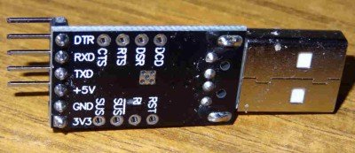

Using a serial interface, such as the one pictured, is straightforward once the LGT8F board has a bootloader installed. The boards may be delivered with a bootloader already installed, and then you just connect your serial interface like this:
Code: Select all
Serial interface        LGT8F328P board
    DTR ------------------ DTR
    RXD ------------------ TX0
    TXD ------------------ RXI
    +5V ------------------ VCC
    GND ------------------ GND
    3V3 -- not connected
With the serial board pictured, and the SSOP20 version of the LGT8F board I used, the row of connections along one end of the board is in exactly the right order for that serial board to plug straight in, as pictured in the fourth post of this thread.
You install and set up the Arduino IDE as I described a few posts ago in my post titled 'Setting up the Arduino IDE to work with the LGT8F328P', in the Tools menu you choose the COM port of your serial interface (COM3 or whatever it happens to be on your computer), and then just upload your sketch (nickelFourCellTester for this project) in the usual Arduino way - by clicking the right-pointing arrow under the Arduino IDE title bar.

Re: Simple 8-LED battery checker using Arduino clone board
Post by bluejets »
Thanks Martin,
I guess I'll have to do a search for the post you mention.
There is still the matter of ...
"Choose the Board: option first, and then the other Options for Clock Source, Clock, Variant, etc. will appear. Set them as shown in the image above. Make sure you set the Programmer: option to 'AVR ISP', and NOT 'LGTSWD mkII as ISP'.
or did I miss something somewhere...?? Cheers Jeff
You can set those options regardless of the programming method (serial interface or other Arduino as programmer). The programmer option will make no difference when you're doing a serial upload, but you might as well set it anyway while you're doing the other settings.
bluejets
Posts: 349
Joined: 19 Jun 2019, 04:09
Post by bluejets »
Point being you said set them as in image above....there was no image above for the settings...
No worries...I'll sort it..... cheers Jeff
I can see the image, Jeff. :?: This one (click on the original of that image in the post above, for a larger view):
The settings are shown in the main drop-down from the Tools menu (not the sub-menus under the 'Board:' menu item:
Board: "LGT8F328"
Clock Source: "Internal"
Clock: "32 MHz"
Variant: "328P-SSOP20 (e.g. green pseudo pro mini)"
Arduino as ISP: "Default (64)"
Port: *
Programmer: "AVR ISP"
* You can't see the port in the image, but it will be different for each user anyway - it's either the COM port number of your serial interface, or the COM port number of the other Arduino that you're using as a programming board).
bluejets
Posts: 349
Post by bluejets »
Martin wrote: 20 Aug 2022, 10:45 and then the other Options for Clock Source, Clock, Variant, etc. will appear. Set them as shown in the image above.
Not in my screen..... :D ...never mind...as I said I'll sort it out.
