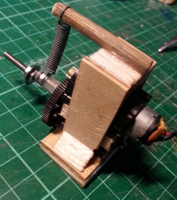

My progress in making a Mighty Midget type GG actuator (a "twitcherator"??) has been slower than I would have liked, but such is life! I've now got all the bits to make the repo mighty midget or Twitcher Rand (as Shaun christened it), thanks to David's detailed explanation/instructions.
While waiting for the last of the bits to arrive I did some experimenting with a GWS motor & gearbox saved from a worn out GWS Lite Stick (remember them?). I've now got it running happily on one of Phil's pulse propo emulators (as meant for Ace magnetic actuators).
Next, I've got to make a Rand emulator to then try it with the converted GWS unit. Interestingly, even though the GWS unit was meant to run on 6 or 7 NiMh cells, on a 2s pack it over rotates, but when powered on 3.3 - 3.7v through a regulator, it runs very nicely with plenty of torque. This seems to parallel David's experiences with his Mighty Midget clones.

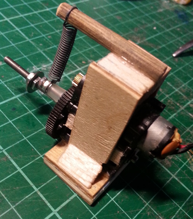

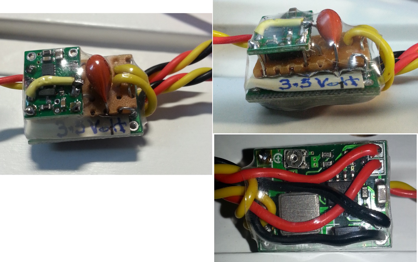

Well I've now made another of Phil's GG emulators, this one with an integral 3.5v regulated supply. The converted GWS mighty midget clone initially ran very happily on it - you little rippa I thought!!

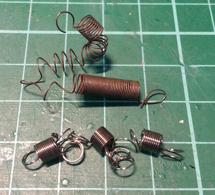

I decided to be safe & give it a 'burn in' on the bench. At 12 minutes, the spring broke. I replaced it with a lighter spring of the same length, but it stretched & distorted. OK, try another replacement the same as the first. This one broke at 10 minutes. Clearly I was doing something wrong, but what?
Remember, I've never seen a MM type actuator "in the flesh", so had nothing to compare the GWS unit to - other than a few seconds of footage of the Mangled Wot waiting to take off @ Ponty, I don't know what good/correct MM actuator operation looks like!
Time for some investigation & methodical experimenting with springs. Several more springs were sacrificed on the Mighty Midget altar to the GG god before I sussed several of my mistakes:

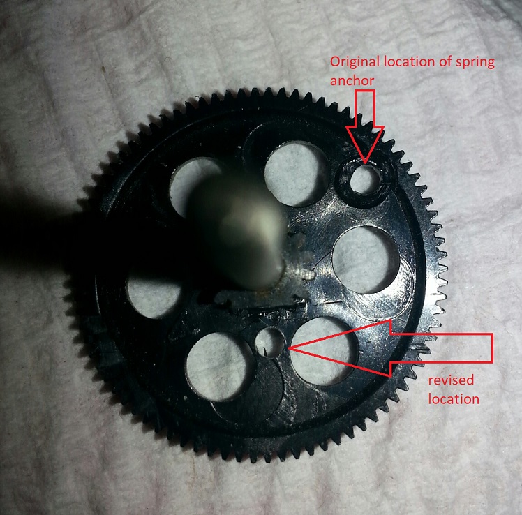

- Initially I had the spring anchor point close to the outer radius of the gear. By moving it in closer to the axis, I reduced the travel & hence the amount the spring had to stretch. The resultant reduced force to stretch the spring also reduced the current drawn by the unit.
- Typical current draw is 300-350mah but when moving the stick around this can momentarily go up to over 800mah. Is this normal?

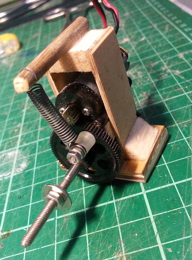

- By placing a short length of silicon fuel tubing over the output shaft, it protects the spring, stops that source of metal-to-metal noise and stops the spring from binding on the shaft
- I had inadvertently over tightened the spring anchor bolt on the big gear, so the spring was flexing at the same point every rotation rather than rotating as needed about the anchor point = fatigue failure.

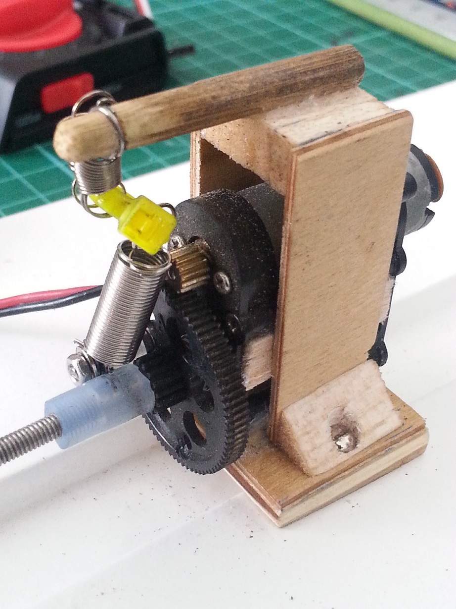

- The GWS unit seems very sensitive to spring tension. I suspect it also has more rotational travel than is normal(?) I made this short video in the hope that those more knowledgeable/experienced could review and provide feedback.
Please let me know your thoughts.

The actuator looks like it is over rotating. MM actuators usually go 270 deg end to end and have mechanical stops. I use springs from ball point pens and use brass tube sleeves on bolts for the springs to run on as a bearing surface. Rubber bands also work well. You don't need a lot of tension . It isn't necessary for the spring/band to centre the actuator.

1. your actuator is going like the demented clappers. Why not try reducing the input voltage to slow it down and restrict the rotation to 270 degrees? And I haven't used, or found the need for mechanical stops, although I know the guys used to back in the 60's. Just tweaking the voltage did it for me.
2. if the rotational speed is right the return spring/rubber band need only be VERY light, i.e., virtually no tension at all when the shaft is in the middle position, and just helping the shaft back to centre from the extremes. It definitely does not need to be twanging it back under high tension.
Finding the right spring can be difficult but if you PM me your address in Oz I'll send you one. There are sources here in the UK and I'm sure there must be down there as well. If you have internet suppliers to the model robotics guys, they often have them. Alternatively, remember those loom bands that were all the rage a year or two ago? They do the job well but need frequent replacement. A couple of flying sessions at most.
3. You've got the attachment point on the shaft positioned spot-on. That's where it needs to be (see above). A light metal spring will work perfectly well with a final loop just hooked over a wire hook bound and soldered to the shaft. I'll try to do some photos of the embarrassingly crude arrangement I've used and post them here.

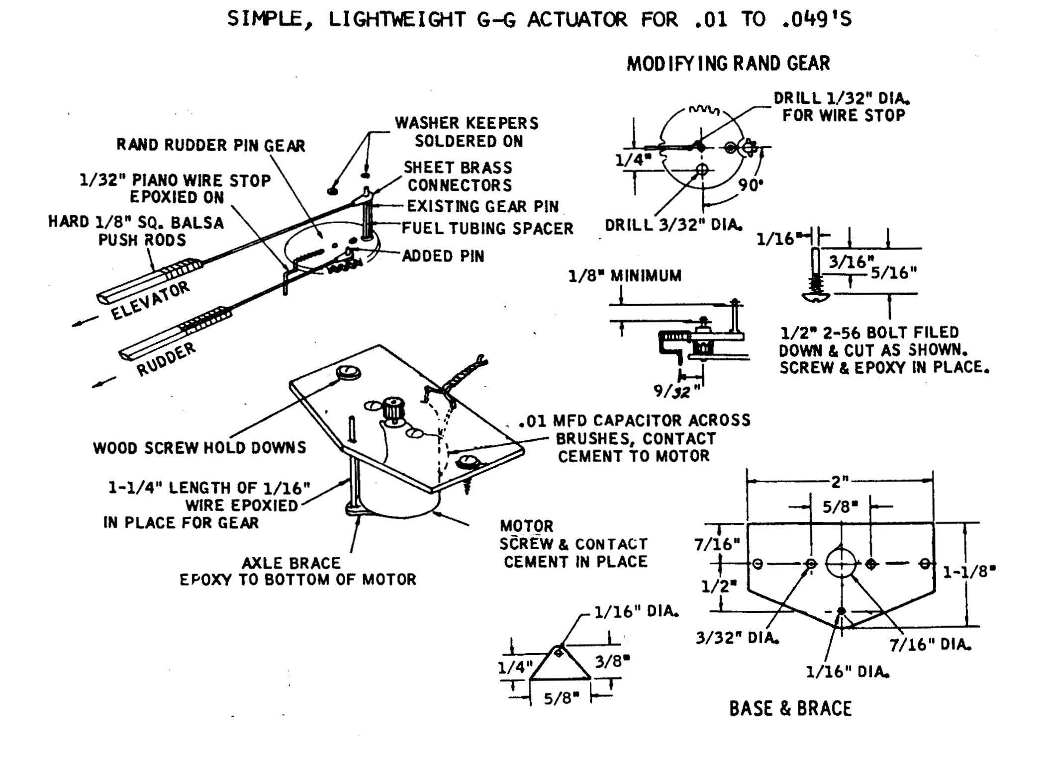

Theres an actuator build pdf amongst the files on Phils site "ACE mini GG actuator " that shows a unit using push/pull setup - looks simple enough to make, and this coupled with Martins pot adjustable decoder would be easy to setup.
