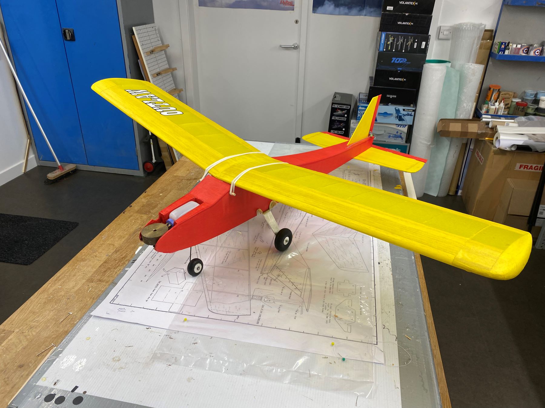

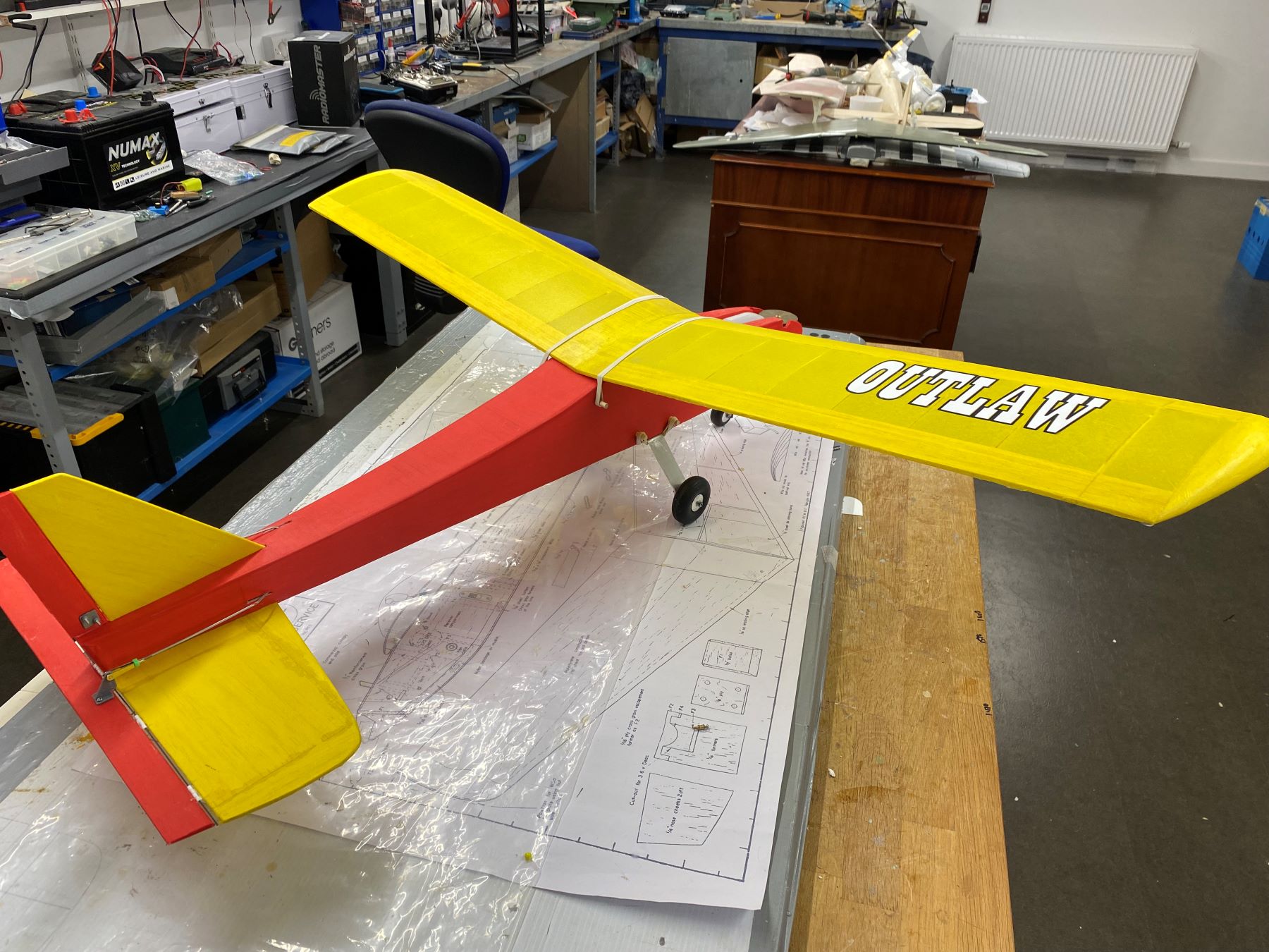

Here's a couple of pictures of the diesel version of the Outlaw - all ready to add the PAW 1.49 RC, once I'm comfortable that the engine will be ready to start and keep going - still got some work with it in the test stand to be sure of that.
I opted for the original tricycle configuration for the diesel version and needed to cut down the only dural undercarrisage that was anywhere close to the dimensions on the plan. I stayed with the banded on undercarriage and we'll see how that goes - on the electric version it flips on every landing, no matter how gentle I am. Outlaw -E is blue, Outlaw-D is red - both use the same wing,
