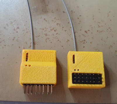

MiTo system has now been updated to a full blown up 8 channels system with the new Rx, you might remember that the first one was introduced with my 6 channels Rx.
This 8ch Rx will run down to 1s, the servos runs on +Batt so 2s servos are no issues as to run from 5 NiMh or 2 LiFe which was not possible with my earlier Rx as this one it has both voltage regulator as reverse polarity protection.
It uses a nRF24L01 module that has PA and a pass band filter to guarantee maximum range.
The pin header 3+3+2 (spacing between each group of pin headers to facilitate installation/removal of each servo lead) ...and if it's not on you YouTube it doesn't exist so here it is
.....I know it's a poor video but one-handed I can't do better!

Excellent work pal..

Very impressive! Love that small RX. And those little servos are great too. Most amazing scratch built radio I've ever seen!
