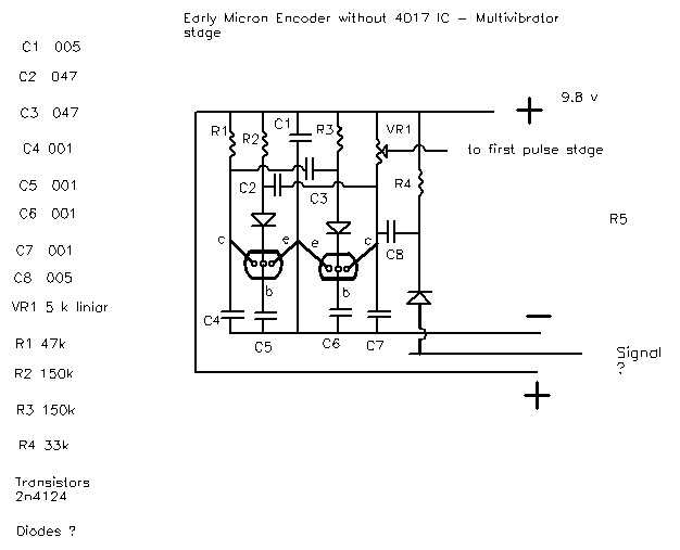

Voltage appeas on the rails when I plug things in. Circuit shows no mA drain or voltage sag. Transistors pass diode test. One end of stick pot is positive. I will go and check the rest. In the meantime, here is a rough schematic of the MV stage. Caps C2 and C3 are incorrectly marked at 047, when they should be .01... and I can't spell linear....
