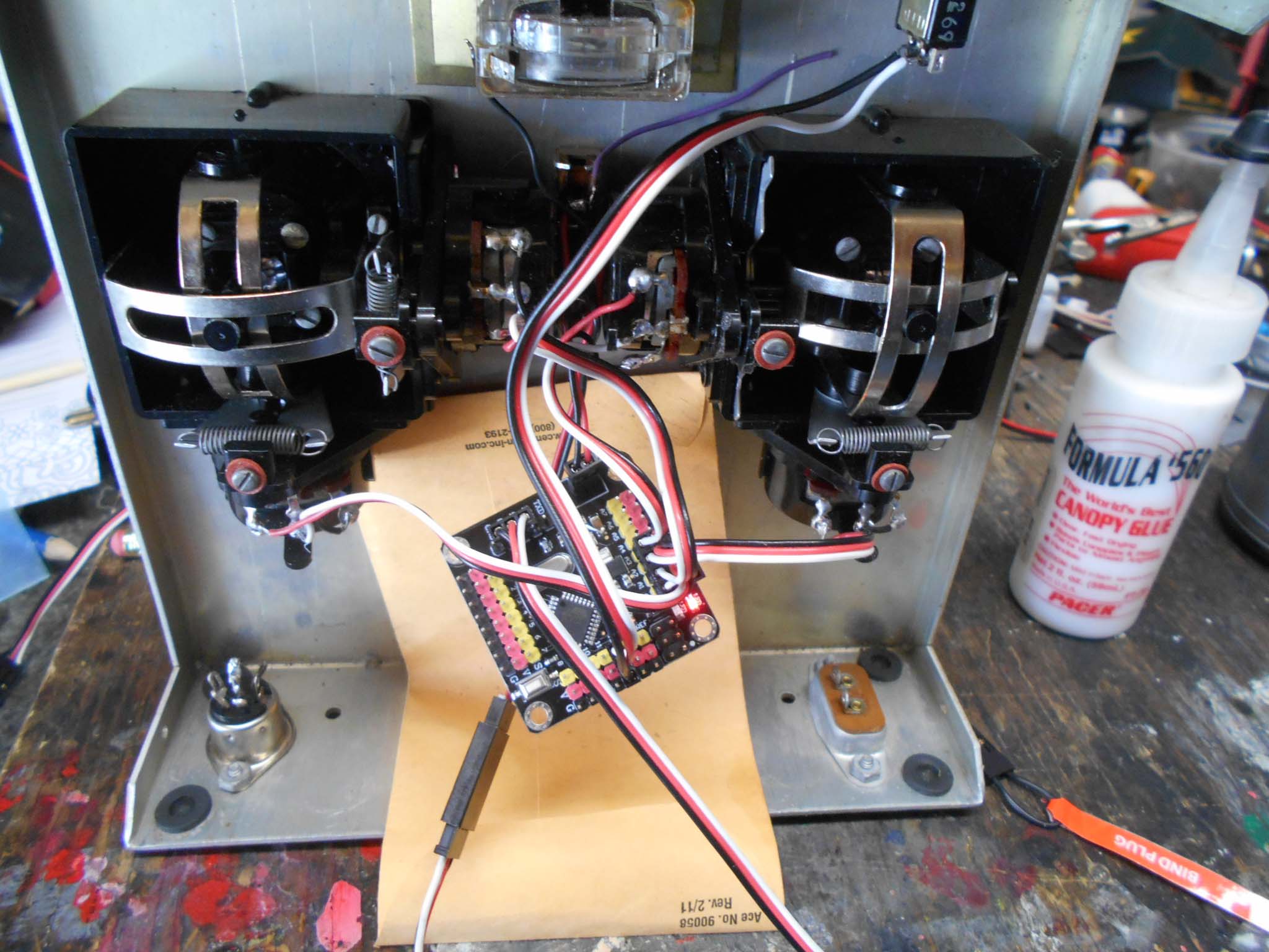

Thanks for the jumper definitions Flynn, I copied them.

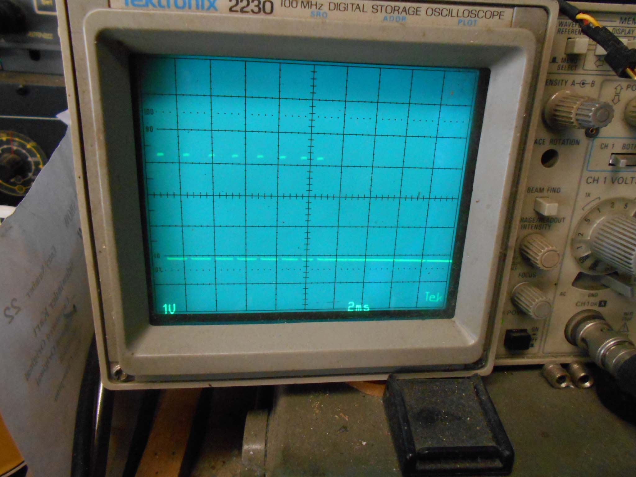

Now, the board is wired up, but when powered up no PPM output. I get 3.3 volts on one end of each of the pots and about half of that voltage on the pot center wipers, voltage changes when I move the sticks. I put in one of Phil G's pro mini boards and it works fine. Apparently the 3.3 volt version I have is either not compatible, or dead. Tried the calibration, no joy either,
Jay
Jay
- Posts: 167
- Joined: 18 Feb 2018, 23:07
It's now working, well sort of...
I did some poking around and found that D13 has the PPM signal, but for some reason it's not at RXD on the the other header where I did the mod to have it get the supply voltage for the module. Do I need to modify the program line that tells it where to put the PPM output? The channel 7 toggle does not do anything either, but the switch is working (D11)
Jay
Jay

Jay - this is the 7 channel encoder sketch - right?.. line 30 is the one you want to change....
static int ppm = 13, ppmPulse = 300, neutralPulse = 1200; //normally set pin 13 as ppm
I think if you want the PPM stream out on RXD then you need to change the 13 to 0
The default pin for the channel 7 toggle is D12... static int sw_tog = 12; // toggle channel 7
is that why you can't get it to work?

Well, it took me long enough did it not? Without the help from Phil and you guys, I finally was able to get the Pro Mini Strong 3.3V 8MHz boards working. I had just about given up and they were in my waste bin but you guys saved them, and me. Was able to change the output from D13 to RXD (D0), and used 32 as a value to get one second response on the slow channel 7.

As a newbie who has been playing with Arduino for less than a week, I was never able to figure out how to get the USBasp programmer to work with the Arduino IDE program on my Windows 10 PC. Yesterday I stumbled onto this thread, did what Flynn said, and PRESTO! I'm finally able to program the Nano from the USBasp programmer!
Today was another milestone where I was able to upload Phil's 7 Channel Encoder sketch into a Nano on a breadboard, use the sticks on a gutted Heathkit GD-19 as the analog inputs to the encoder, output the signal to an Anylink2, and then watch the servos respond and move on a Tactic receiver. It was a huge thrill to see it finally work!
