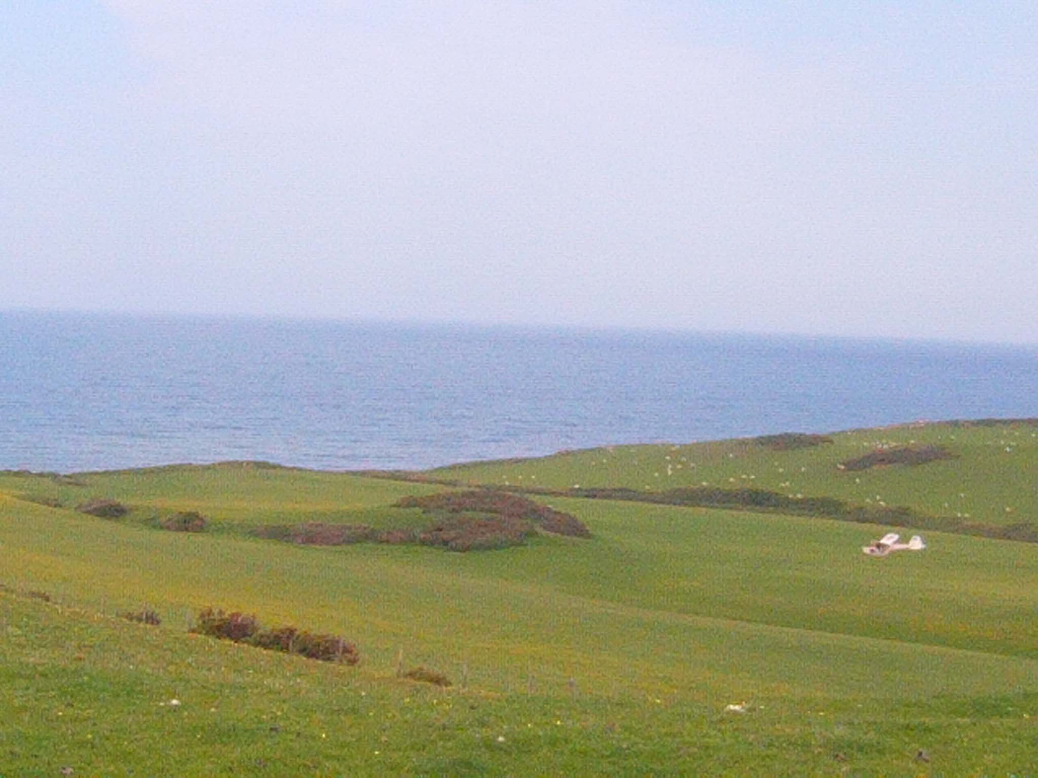

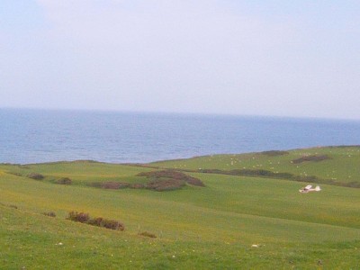

Happily being nudged around the sky..

It's plain to see that this has been photoshopped and these are cardboard sheep - I think this is a ruse by Mr Garrity to sell more Pulstar parts - it's probably not even taken in Yorkshire n'either

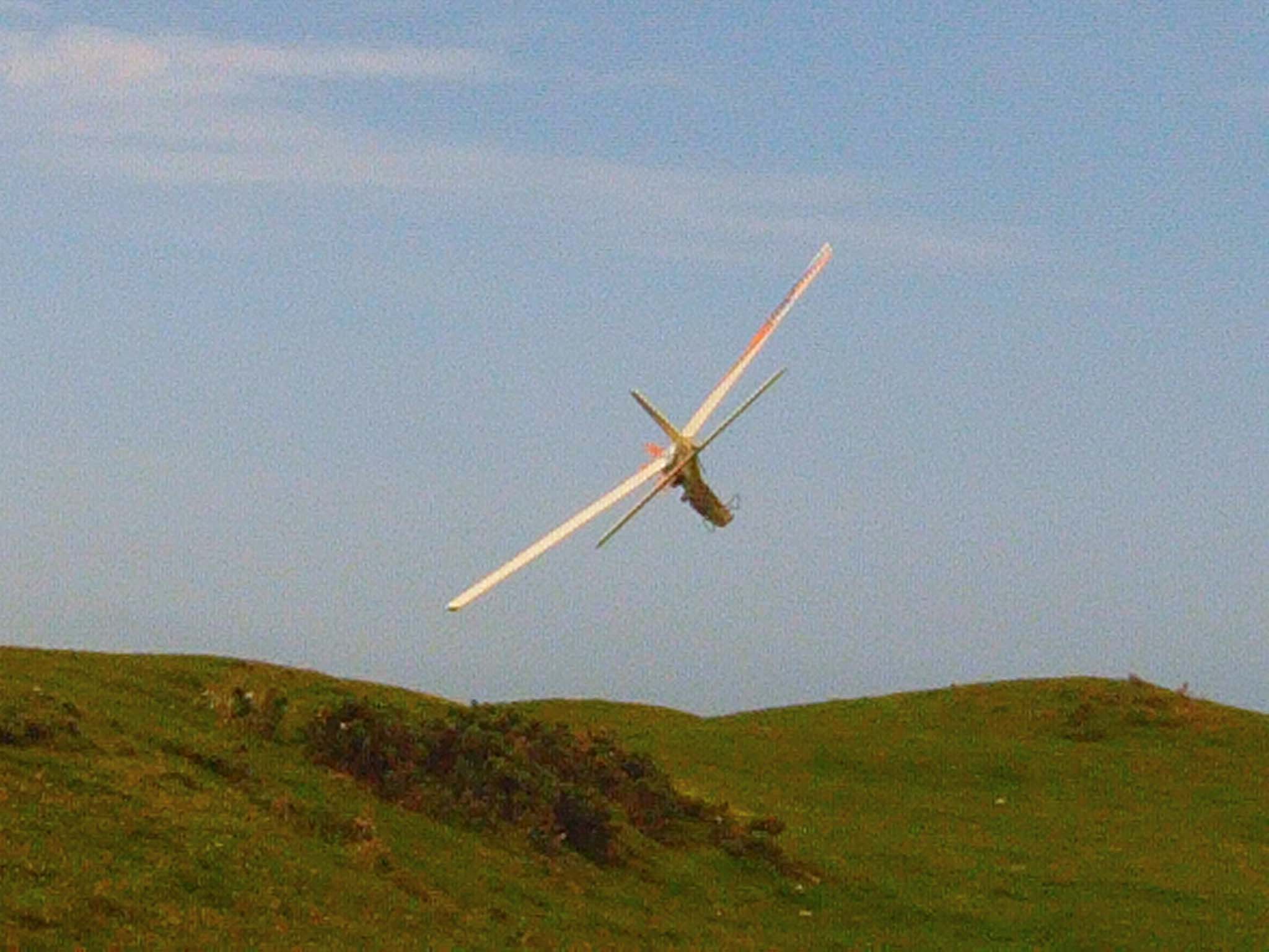

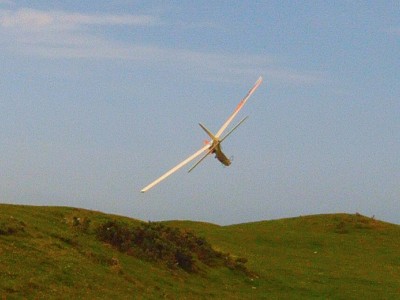

Yes pal, pulse rudder. I love the look on new world modellers faces when they see it clacking away.
I have increased the rudder area by about 25% tonight as an experiment but it was flyable as designed by Vic.I'll try it again tomorrow.
I would use 1/16" ply dihedral braces if you want to chuck it about and make the center rib from 3/16" or 1/4"....
Neil... I photographed it while flying hands off... It's very stable and would no doubt make a great model for free flight.

I think you are onto something Neil!
Having just been sitting watching teli with some of the grand-kids, I'd swear that the background in that picture is from Shaun the Sheep (what else could it be?????

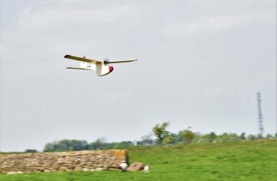

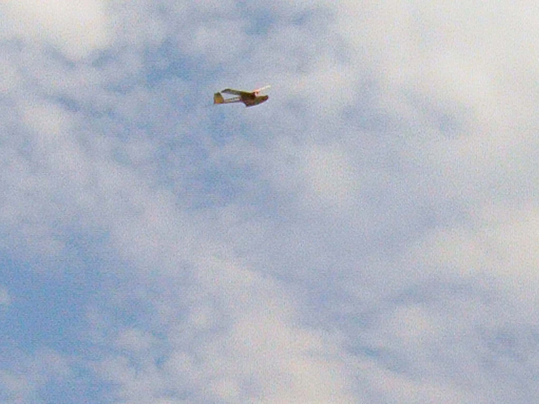

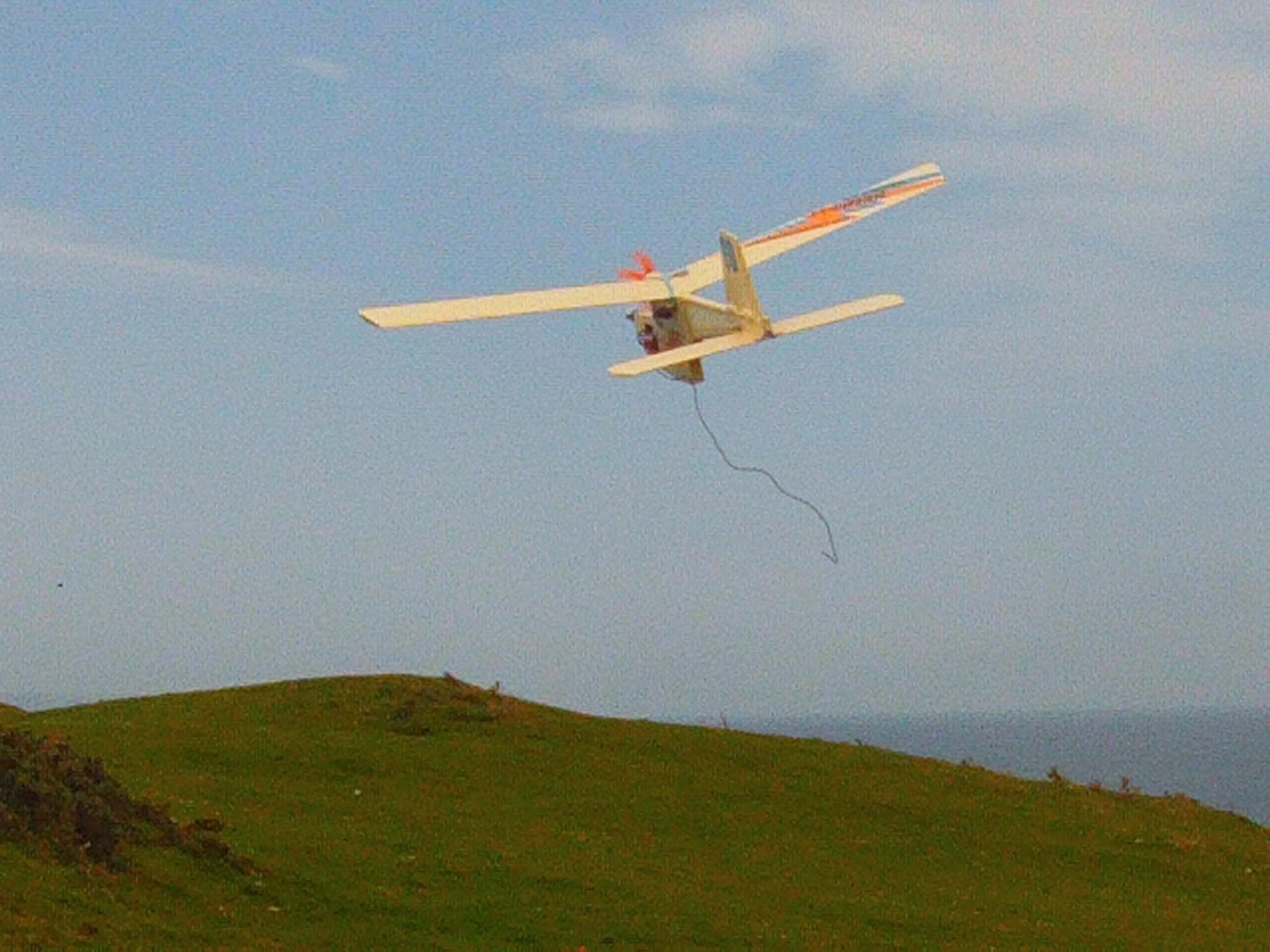

After flying my little Pageboy for a while and finding it a little breezy for it, I decided to test glide the Pulstar. Some may remember my Mattel equipped version was badly damaged on it's first test glide
but now the damage is repaired ready for a motor. What I'd also decided was to build a second fuselage using more modern, lightweight radio gear as I felt with my lack of piloting experience I would find it easier and then try flying the Mattel one at a later stage.
I had the motor probably between 50 and 75% and launched into the breeze and it was clear it was tail heavy as it climbed, stalled, dropped, climbed, stalled, dropped,climbed, stalled, dropped..... I had no option but to try and get control and managed to get it down without too much of a thump
The good news is that my second fuselage proved to be very tough
Added some weight on the nose (blue tack) and went for launch number 2 and decided to just fly it
and it was much better, but still required a little more nose weight. Some more blue tack and launch number 3 - PERFECT! Had great fun flying it as it was happy with the level of breeze. I could even bring it down with a soft landing on its belly
not far from where I was standing.
I'm using the exact same power setup as Shaun, but with my own 2S lipo and found it plenty powerful enough. As I need nose weight I'll make space for a larger 2S lipo and get the benefit of longer flights. My rudder throw was deliberately set for small movement and it could do with increasing. I used the shortest servo arm, and will swap that for the next one up in length and see how that goes next time.
This was a great experience for me being a novice pilot and has helped me to see that a bigger, heavier model (compared to the Pageboy) is so much easier to fly at the site I use. I reckon the Pulstar will be a good trainer for me to try flying of the slope at the same site.
Here's a few pictures taken with my action cam mounted on my cap. I need to position it to point a little more up as I miss a lot of shots when the model comes in close to me.
