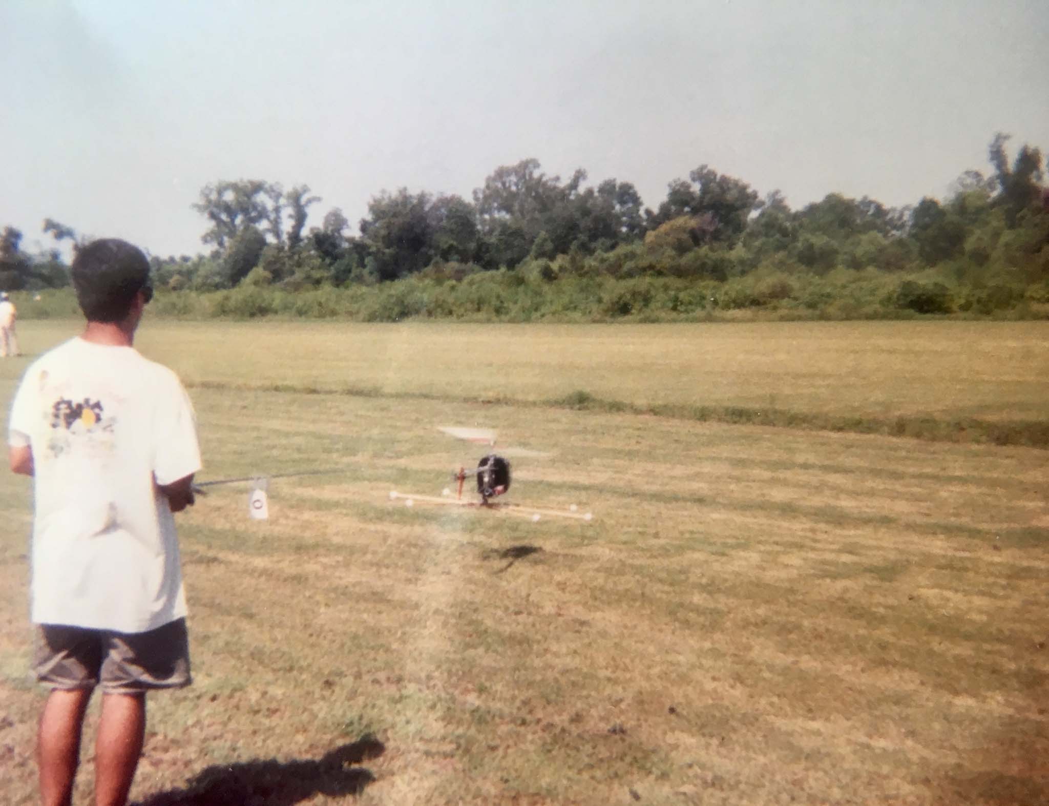

Pete, your posts got me digging about, and I actually found an old photo of my fixed pitch MFA Sport 500. Guessing 1990 or 1991. I was in my mid 20's and still had black hair. Must have been the first time I hovered her, as I see I am holding a two stick tranny. I switched to a single stick JR which was loads of fun and eventually moved on with Hirobo Shuttles and Kyosho Concept 30's.

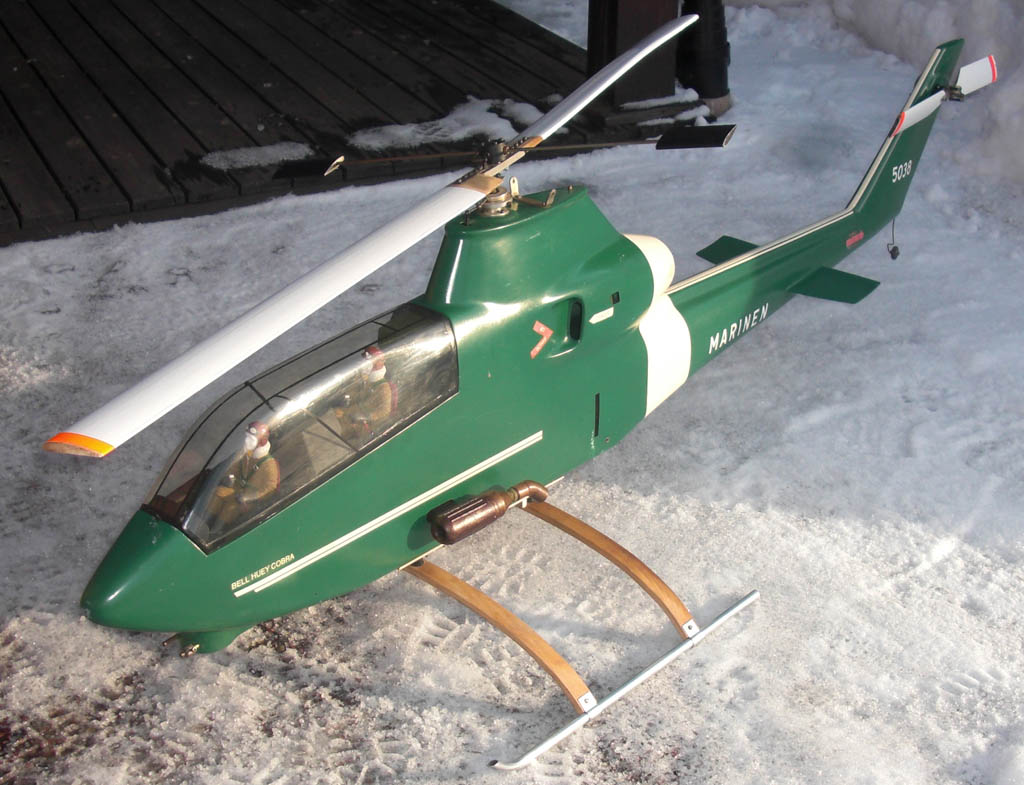

My Hegi Huey Cobra (built in 1972-73, by another person then me):

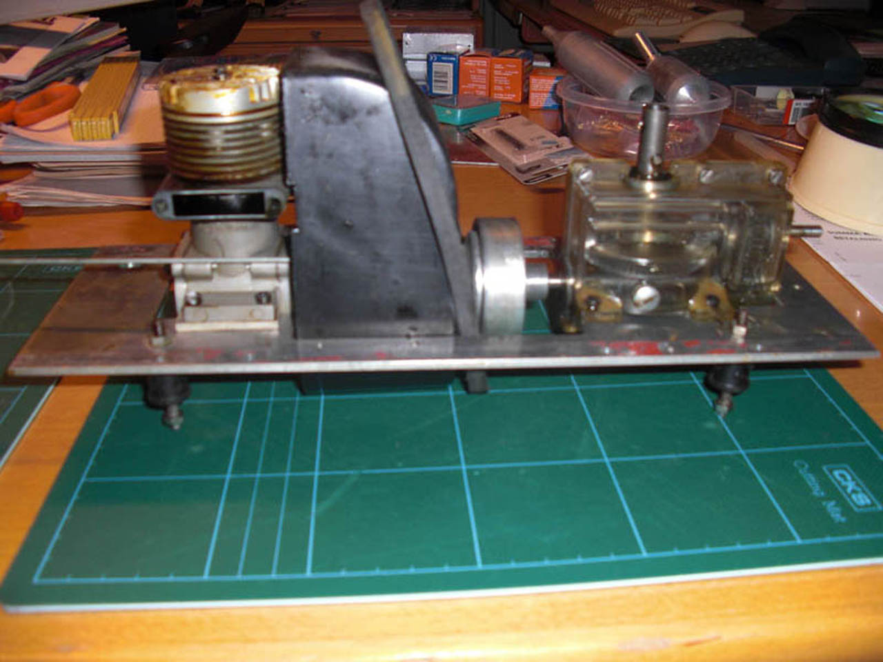

The engine (Veco 61) and gearbox in my Cobra:

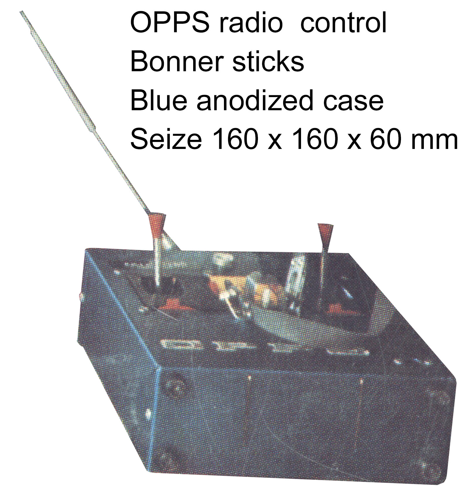

This is the brand of radio that was originally in my Cobra, that was used at the helicopter competition, the brand was OPPS and was made in Sweden (very expensive radio at that time, avaliable in 3-6 ch):

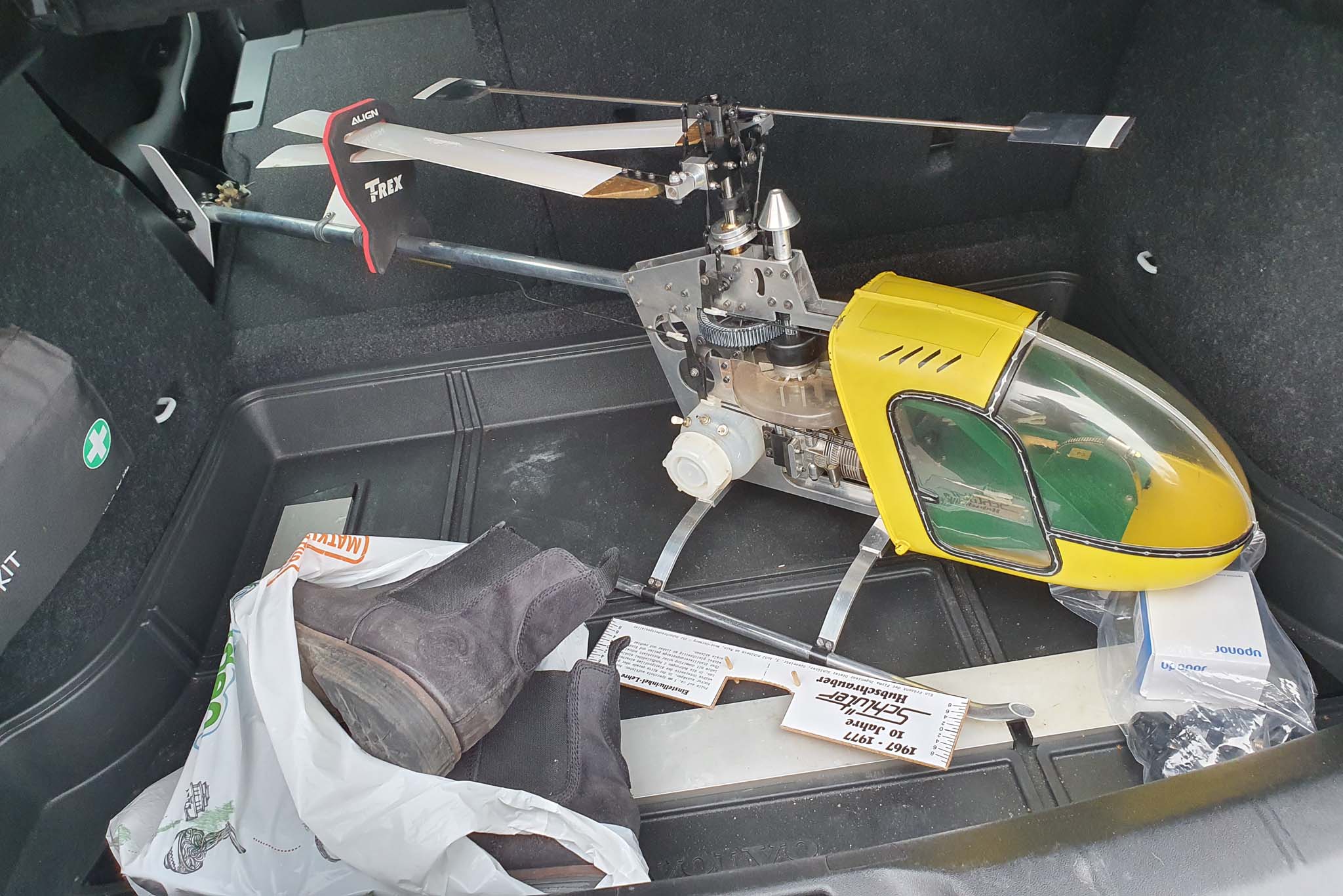

Today I picked up, bought back my old Schluter Heli Boy that I sold 35 years ago from the same guy that bought it at the same price. The guy never flew it or cranked up the motor but kept it immaculate so now I have a dilemma! Shall I keep it IC and fly it with the original Kraft transmitter as helicopter radio is not needed as the mixing throttle/pitch is mechanical or shall I go electric and fly it with a modern radio?
I would in either case replace the old mechanical gyro with a faithful Futaba GY 401 with relative servo as my left hand is no longer up to speed.
FYI I still have the original fix pitch head option together with the collective pitch one so there I also have choice.
From my original collection of Schluter is only missing the Heli Baby now. I have the Mini Boy, Heli Boy with both training canopy as the Bell 222 fuselage and Heli Star. All are in flying condtion and original with IC engines...but I have installed proper rail gyros
