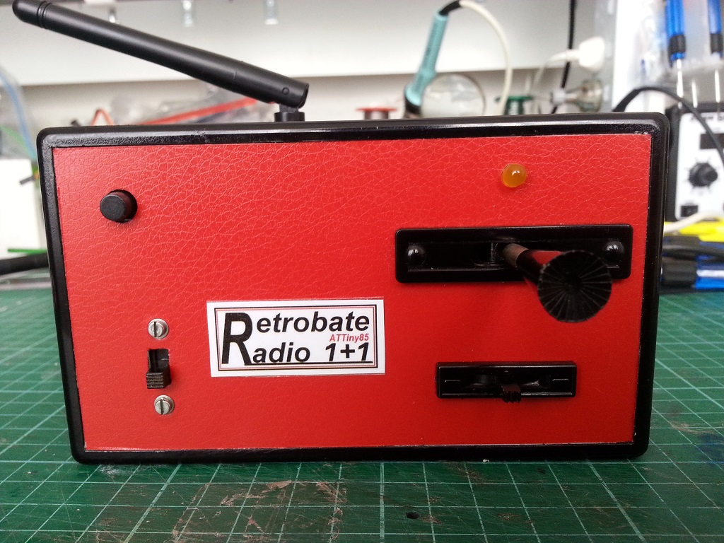

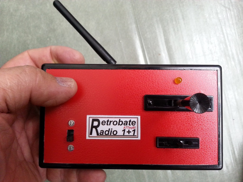

I've just had some forced 'down time' while recovering from some minor surgery. Rather then be bored or waste away watching the idiot box, I put the time to good use by making another 1+1 Tx :) .
For this version, I turned the case on it's side, my thinking being 2-fold:
1. I can comfortably hold the Tx in my left hand with my left thumb over the throttle button while launching, then hold the Tx with both hands while flying --> pseudo Mode 2 - right thumb steers while left thumb controls the throttle.
2. its a little different :P
I can comfortably hold the Tx in my left hand while launching.
The case is a bland neutral coloured cheap plastic job off 'the bay'. Since it has a shallow recess on the front, I inserted red stick-on auto vinyl in the recess after painting the case black. This colour combination reminds me of a 7ch Micron Tx I have tucked away in a box in storage. I used a D&R stick with a separate D&R trim pot. The encoder is Phil's ATtiny 1+1 Mk2
1+1 Tx #2
1+1 Tx #2

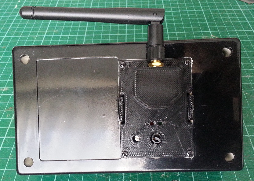

Rather than use an internal Frsky module as is my normal practice, this Tx has a plug in Multi-Module (from Banggood), operating a FlySky Rx.
fitted with a multi-module operating in FlySky mode

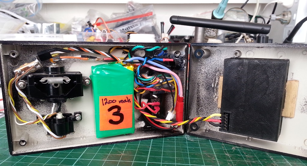

over-spray from painting the case exterior makes the internals look worse than they really do ;-)
This is my first ATtiny 1+1 Tx retro-fitted with a D&R stick. Works a treat!

Looks fantastic Wayne, I like the inlaid vinyl idea. Where are the 'D&R' sticks from?

Thanks Phil :D
Phil_G wrote: 14 Jul 2018, 15:00 ........ Where are the 'D&R' sticks from?
The sticks and trims came from Ace. I bought a lot of Tx hardware, pcb's & servo mechanics from them back in the late 70's & early 80's. They were always great to deal with.

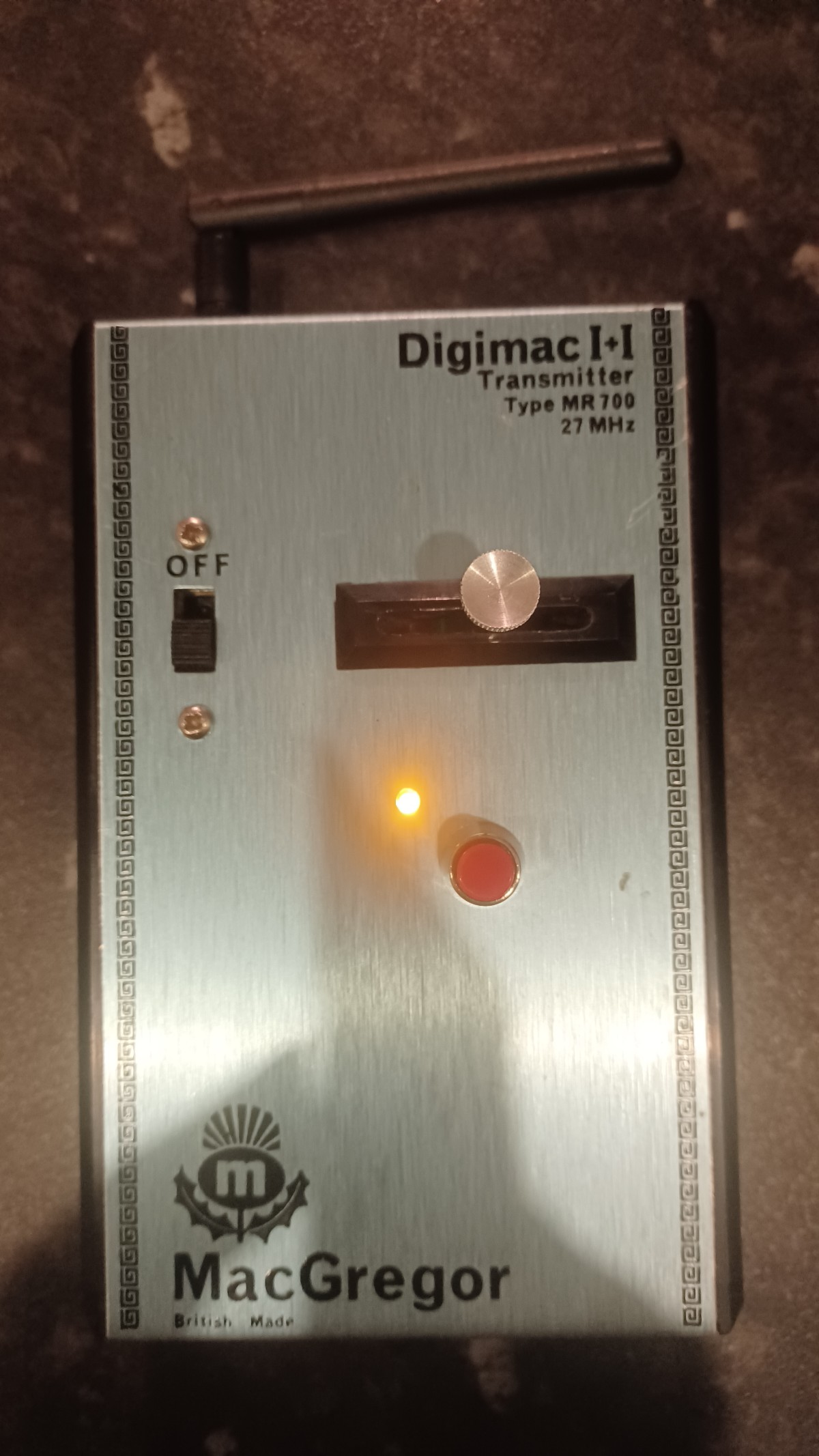

A long overdue conversion using phil's excellent digispark encoder
Re: New Digimac 1+1 revision 3, a few more bells & whistles
Nice!
The Macgregor 1+1 is one of my favourite sets - lovely relaxing way to fly rudder-only :)
Mine is a regular flyer in the Vic Speed Poppet... totally dependable, around 30-40 watts which is plenty. Love it :D

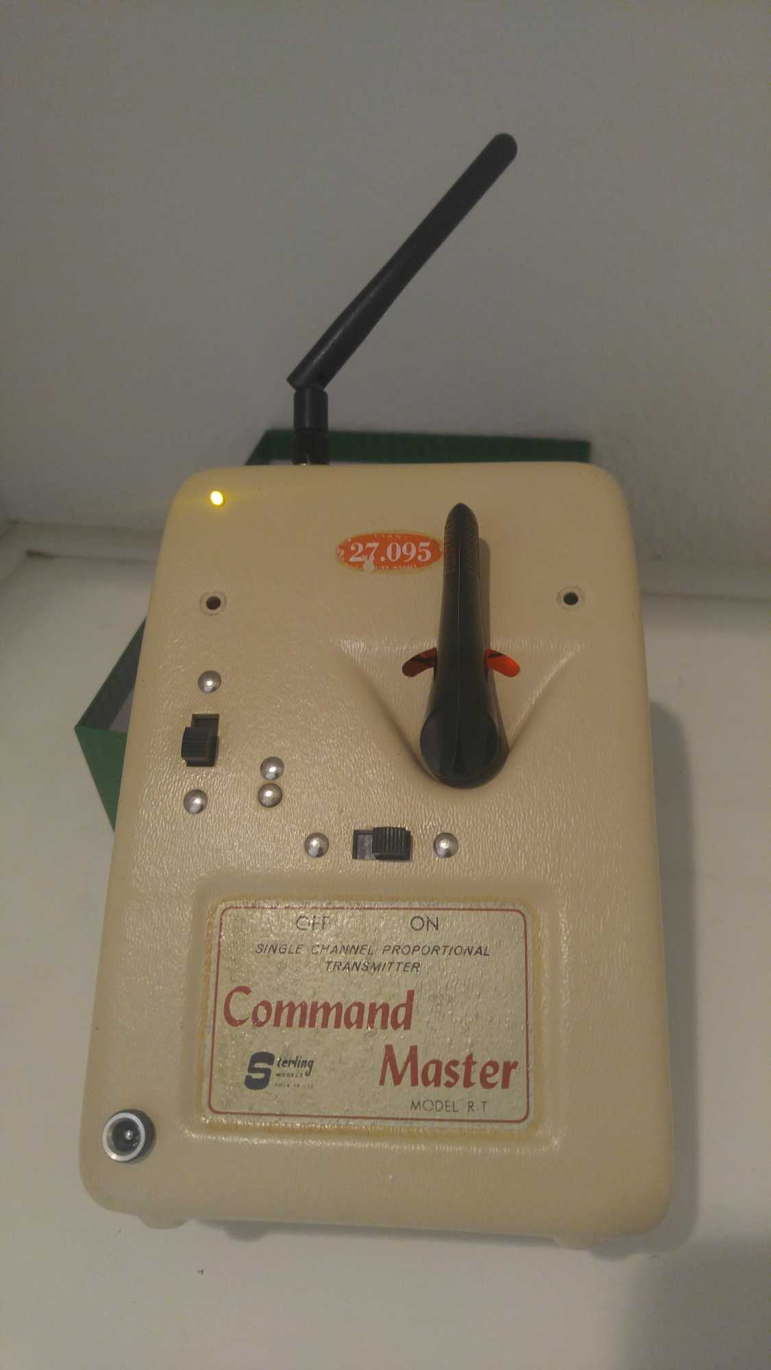

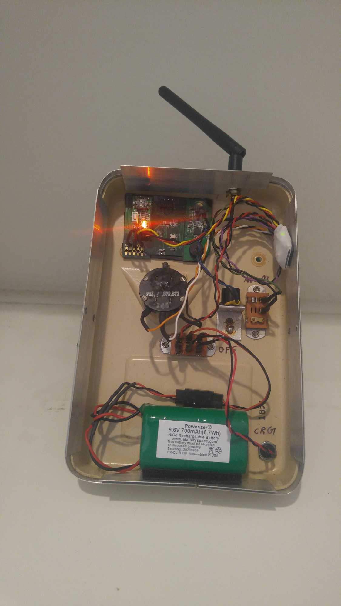

Hey all. Finially had a chance to catch up on my conversions. Here is a Sterling Command Master transmitter ready for service with one of Phil G.s wired 1+1 boards and a modified DJT module transmitter board. It's been tested with a micro reciever and servos. It works a treat! Might use it with a Sterling Mini Mambo or something similar. Have found that repurposing and upgrading vintage radio control systems is good therapy. (and great for maintaining problem solving skills!) Phil as always thank you for providing the resources to make all this fun happen! More radios to convert.... Cheers!
