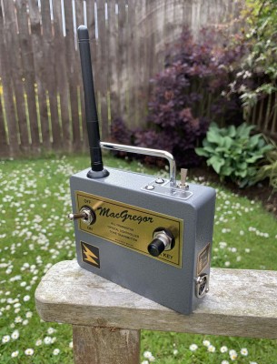

Here is a quick demo of the TX working
Re: MacGregor landscape TX

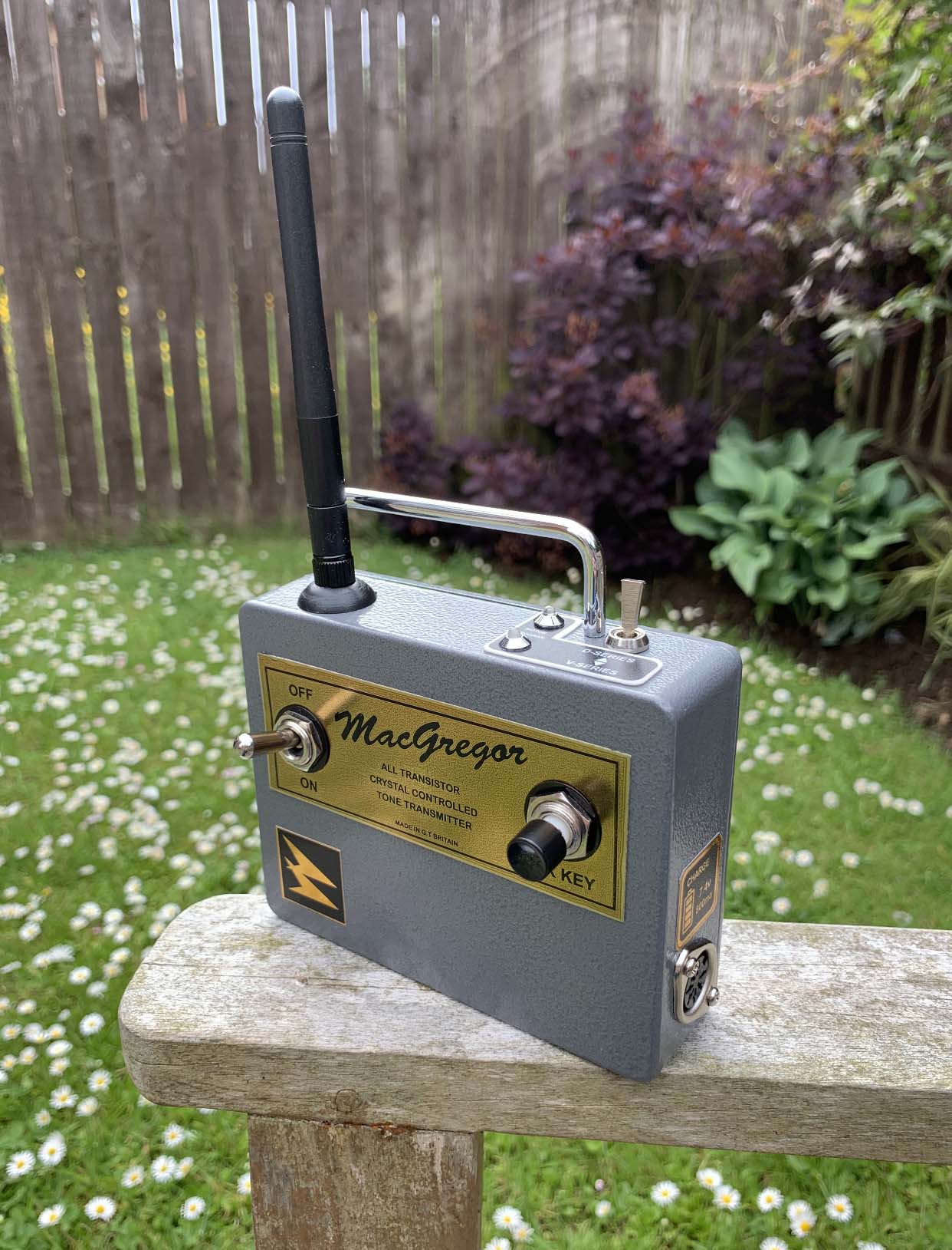

Decided to use the double chevron original MacGregor logo again
Keeps it somewhere near :D
That’s it completely finished. Case closed.

VC10 RON wrote: 14 Jun 2019, 21:09 Here is a quick demo of the TX working
Now wait, where did I see that blazing, blue Throttle LED before... :roll: :lol:
These things are brilliant, aren't they? No excuses anymore for not hearing one's motor...
What's the working current on yours?
I think your starboard/port LED adds another nice touch.
And your decal making has turned into an art by itself.
Just ordered the same stuff you are using, as mine is still a bit, uhm.... black.

No Ron, I wanted the silver vinyl as a substrate for the clear with black print.
I'm convinced it will work out fine on my Little Black Box...
I was asking about the current, because my club mate MaxZ discovered that with the same load resistor I was using, he had 50 mA.
That would likely kill the 328 in a ProMini over time. We wouldn't want that to happen mid flight would we? :shock: ;)
Therefore we both paralleled two outputs instead of one, each with double the resistorvalue.
I'm getting 1 3/4 + hours of working time out of a 2S 300mAh and I 'll bring another one with me, so a flying day will be covered... :mrgreen:
