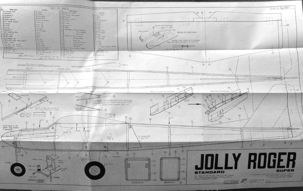

Was there another manufacturer of a Jolly Roger kit? Mine was a tail dragger with foam wings. I still have the plans and from time to time have considered building one again for the nostalgia.

As far as the Jolly Roger trainer, well my plan definitely show a trike undercarriage, maybe earlier or later versions had a tail dragger option? I eventually converted mine to the Jolly Roger Super with a semi-symmetrical section aileron wings and an Irvine 45, which is still in the loft. But its a bit like "Triggers broom", it has different wings, a fibreglass undercarriage as the dural one got too bent out of shape and most of the fuz is new balsa repairs from the original.

Definitely a different Jolly Roger.
