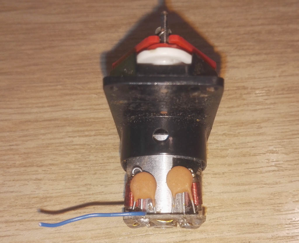

I was tidying up my workshop a bit this afternoon and picked up an original Rand LR3 laying on the bench. Someone posted earlier that theirs had a 100 ohm resistor fitted across the motor. Well this one had two inductors/chokes and a couple of capacitors fitted and no sign of a 100 ohm resistor.
I then got out the other Rand LR3 I have and all of them had the same two inductors/chokes and capacitors fitted (though they were directly soldered to the motor and not via the small PCB).
Does anybody know the value of the chokes? The value is a little too low for my LCR meter to measure accurately but it read 6uH (but some of that could have been the test leads).
I wonder if a similar setup would help with the glitching problem with our Tobe Rand actuators?

10 to 15uH chokes in series with the motor. The 100 ohm resistor makes the motor go "cooler" and should be if used around 220 ohm at 5,2 volts. Jay Mendoza add this to "his" actuators and have found out improvements there together with a well exercised spring. The main improvement is having the 220 ohm resistor and a smooth set up. The chokes have not any really impact on the issue...

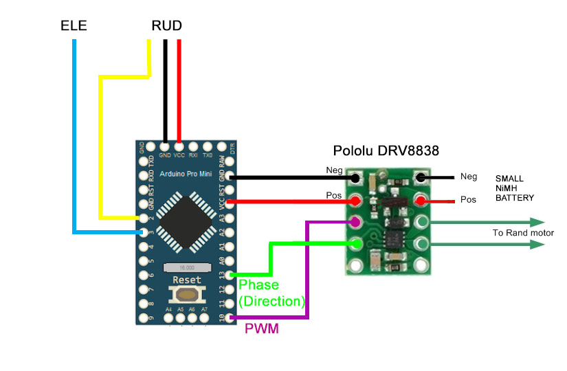

I tried a new approach last night and can't get it to "glitch/freeze" at all, even with stiff linkages. I'm still using an Arduino Pro Mini, but have separated the DRV8838 enable and phase (direction) pins. It worked 100% OK with either a single battery for the Arduino and motor or with a separate battery for the motor. I've shamelessly used Phil's diagram and Photoshopped my minor alteration.
I have to credit Martin for what I've done as I looked through his GG Pulser program and realised he "coasts" before changing direction ie he stops powering the motor a bit before changing direction. I used the D10 output on the Arduino as it is a PWM pin, so I could vary the voltage to the motor as well but it wasn't needed. And I have removed the 100 ohm resistor as it stopped the motor from "coasting".
There are other benefits from separating the "enable" and "phase/direction" pins on the DRV8838. The main one is that if you turn the transmitter off, the actuator stops at near centre due to the spring tension, whereas previously it just keeps running. It also took less power which I checked at the end by seeing how much charge I got back into the battery (around 25% less than if no coasting). Also, you could program the Arduino with a "bootloader" and the delay in the Arduino starting is not so critical as the Rand motor is not running. This would be easier for a novice to program, who is more familiar with uploading directly via USB rather than using an ICSP.
I would imagine you could use Martins Pulser program directly and I'll try this out when I get an Arduino ATtiny85.
