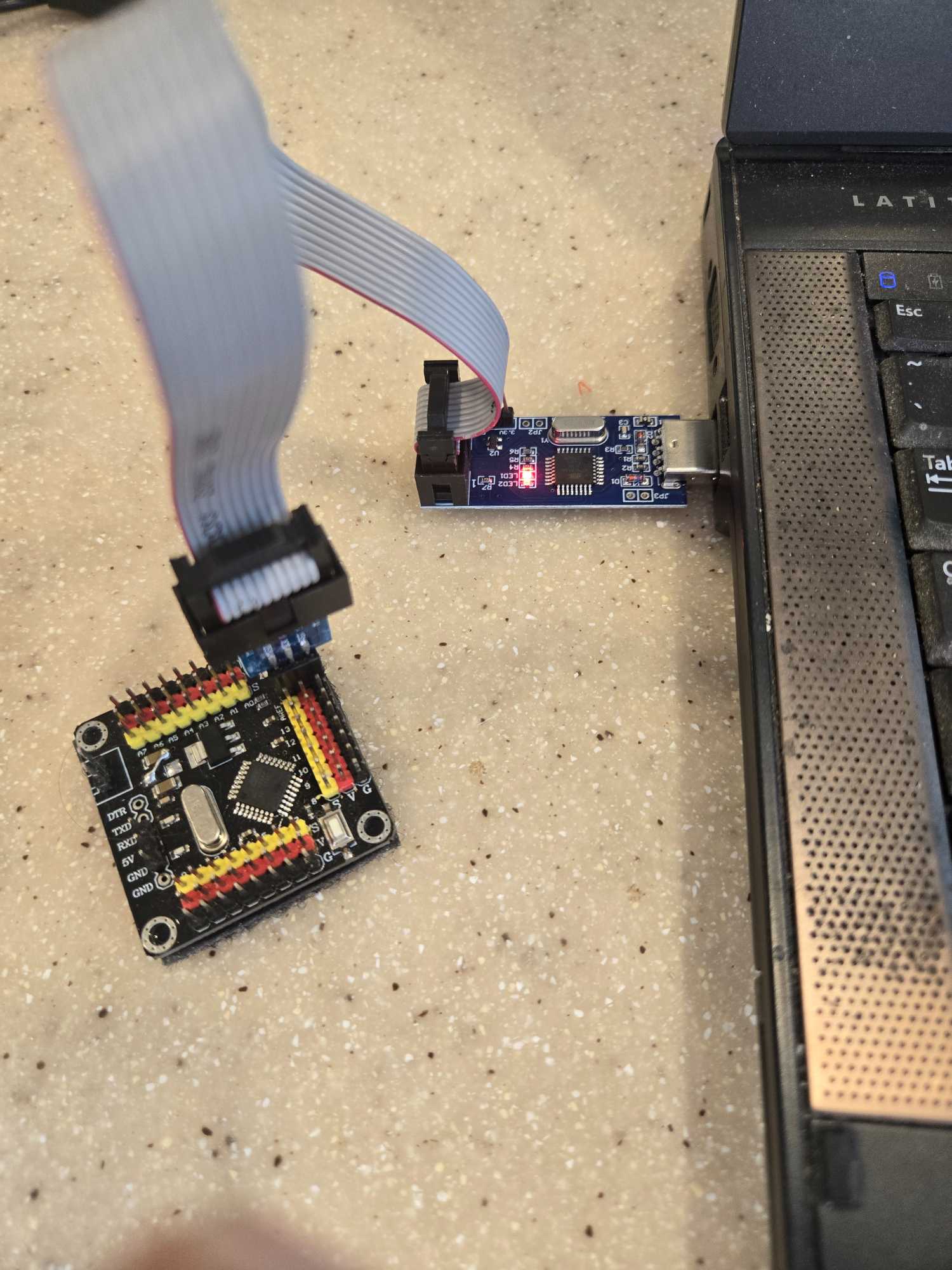

Posting in this old thread as it seems like the right place. Phil_g pointed me here to get the zadig driver installer.
The background. I'm a newby programming the Arduino boards. I do have an Arduino dev kit that I have used to start learning the code. At least I know the IDE 2.3.2 installed previously is working.
I bought this USBASP programmer from Amazon:
KeeYees 2pcs Downloader Programmer for USBASP for ISP with Cable and 10Pin to 6Pin Adapter Board for 51 for AVR Series Microcontroller https://a.co/d/2lSu0Jy
Used zadig to install the driver. Loaded up the IDE with Phil's GG Sketch. Connected the USBASP board into my PC. Set the IDE to "Arduino Pro or Pro mini" on com3. Connected to the DIYMore Pro Mini Strong board (which had previously programmed with the GG code, but not by me as I wanted to insure it had the latest code). It had been working but A6 and A7 pots didn't adjust throw when installedin my Tx. Selected "upload via Programmer". The IDE status in the lower right says "Arduino Pro or Pro Mini on COM3". Code compiles ok, the goes into "uploading..." mode but doesn't seem to complete. Tried it once yesterday, let it sit 4 hours. Rebooted this morning, Tried it again, same result. I did verify the 5v and Gnd at the 6 pin was correct (also made sure the USBASP board had the jumper ser to 5v). I did just insert the pins in the pcb holes as Phil had recommended.
With that long story, not sure what's going on. Is the USBASP not working? I did try both ones I received, same result. Is there a way to tell?
Re: Help with USBASP
Hi Bill,
Rather than just inserting the 6 pins and leaving them unsupported, you have to apply a little sideways pressure during programming to ensure a good contact on all 6 pins. Just lean it as far as it easily goes, then push a tiny bit more, hold it and click 'upload using programmer'. Its easier to do than to explain, I do it with one hand.
Just while you're getting into it maybe solder a 6-pin header to one of your DIY-Mores, until you're happy with the process.
As noted before any 'cannot set sck period' warnings should be ignored.
I'd not heard of Rogers 'reversed adapter' problem before, might be worth checking.
- Posts: 18
- Joined: 13 Jul 2022, 21:05
Thanks Phil,
In the end, I actually got it working. Definitely newer code installed now as after I uploaded (although frankly I would consider this downloading when putting it on the board), did the calibration and Voila! it works and now the A6 and A7 pots are working to adjust the travel volume...or whatever that is called these days. Yay, SUCCESS!!!
Here were the next set of trials and tribulations in case anyone else has the same NEWBY problems.
1. I went back and verified the USBASP wiring to the 6-pin connector was right. Seems like I can never find the pinouts on stuff (like the DIY More board) but there were silkscreen labels on the 10 to 6-pin adapter. Wiring was fine.
2. Soldered headers for the 6 pins on the DIY More board. Just wanted to eliminate that as an issue.
3. Ran the upload again. This time I had the messages:
"avrdude: ser_open(): can't open device "\\.\COM3": Access is denied"
"Failed uploading: uploading error: exit status 1"
Then I realized I needed to select the Programmer in the Tools section. Selected "USBAVR"
4. Re-ran the upload again. This time I had the messages:
"avrdude: warning: cannot set sck period. please check for usbasp firmware update"
"avrdude: error: program enable: target doesn't answer. 1"
"averdude: initialization failed, rc=-1"
||||| Double check connectionsand try again, or use -F to override"
||||| this check
"Failed programming: uploading error: exit status 1"
Ugh... Gee, I wonder if I plugged in the 6-pin connector backward??? I had figured the dot on the corner of the DIY More board was for Gnd...evidently it wasn't. (Again why can't I find pinouts on that board????). So I said, what the heck, plugged the 6-pin in the opposite was (with MISO by the dot in the corner of the board) and Voila! the LED on the DIY More board came on. I think I'm on to something.
5. Did the upload again and YAY! it uploaded the new code...and that's the story of how I actually got there
...Bill
Well done Bill, yes the dot denotes pin 1 which is miso. Neg is diagonally opposite.
Sorry I should have said to set the programmer to USBASP in the IDE menu.
I think the problem with helping people is that ours have been working for years, we forget details and its easy to miss a step out
See last photo in the first post:
viewtopic.php?p=962#p962
But now its working, the world is your lobster
We need to get Pauls working next!
