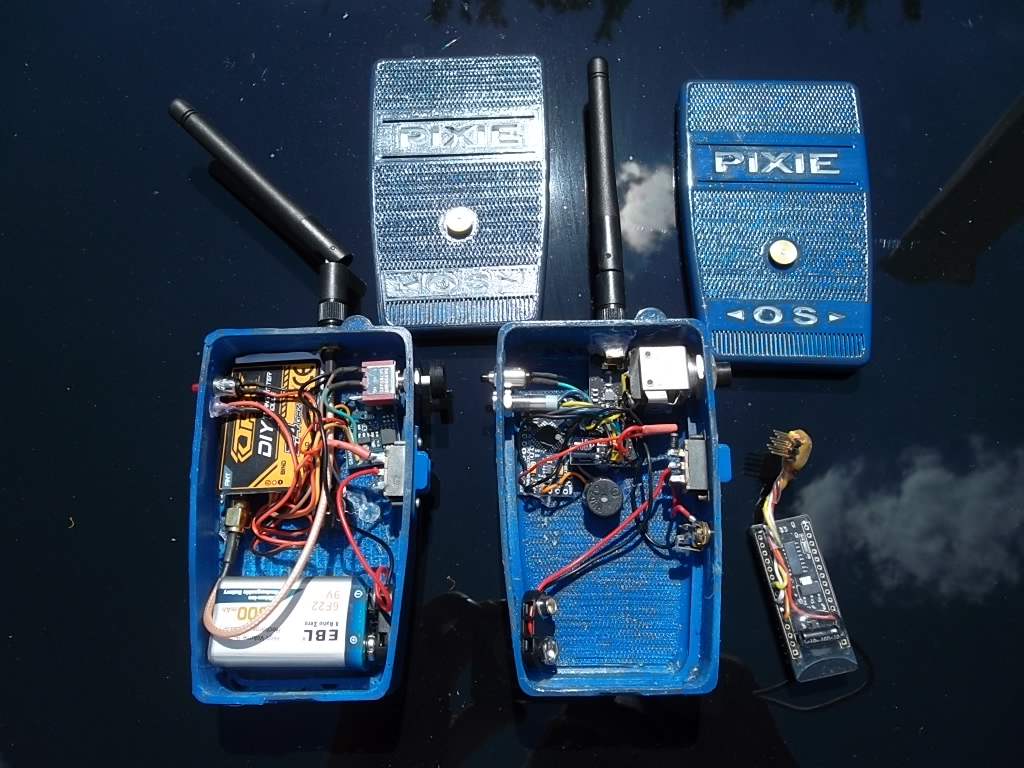

another two will follow, a second case is already printed and it will be real S/C transmitter using an Attiny85 and an Orange2.4G module. It is almost ready.
The third one will be in black and I will get it printed shortly.
I made some changes to the Openscad files to get it printed easyier (I hope). Will see how it will work out.
OS Pixie MK2 3D printed case

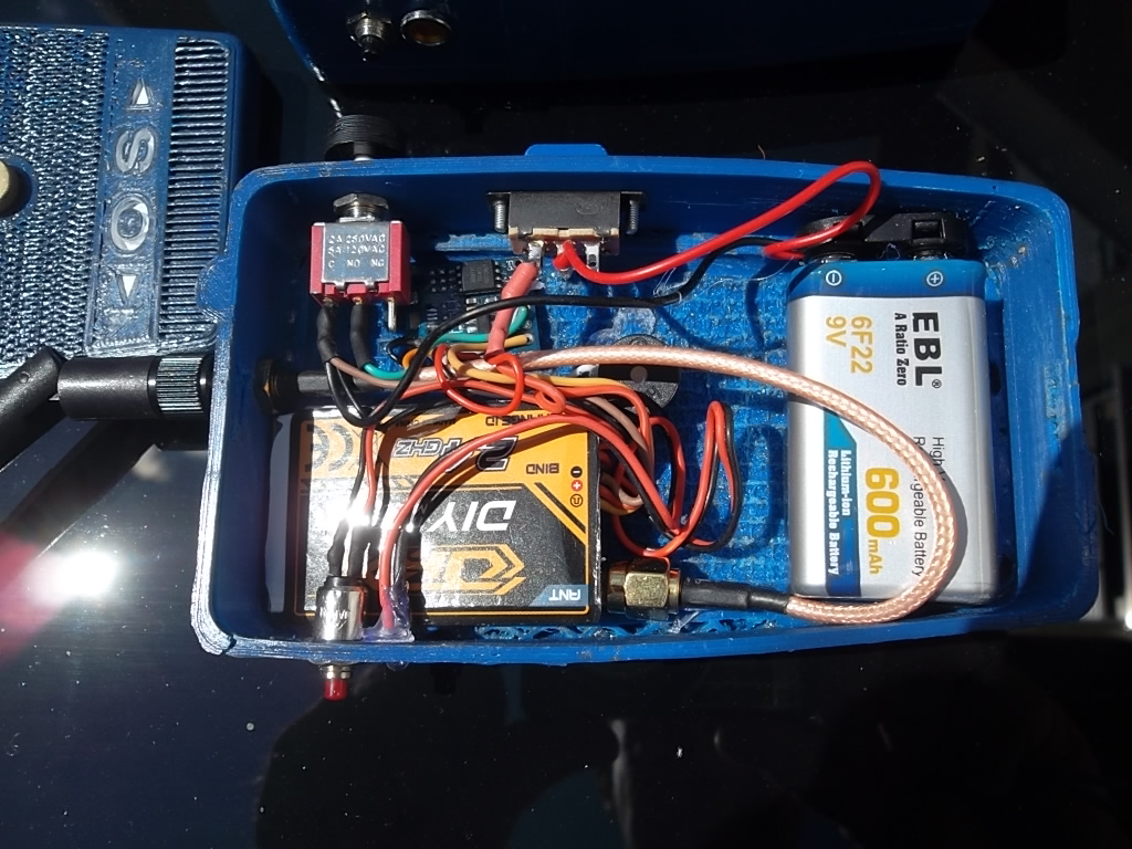

Meanwhile I did some flighttest with the NRF24 OS Pixie MK2 and had some range issues with the old style NRF24 high power module. So I changed it to the new style high power module and tested it again this morning.
The result was very satisfying, no issues anymore, great range, great flying.
So don´t use any old style NRF24 high power modules for flying.

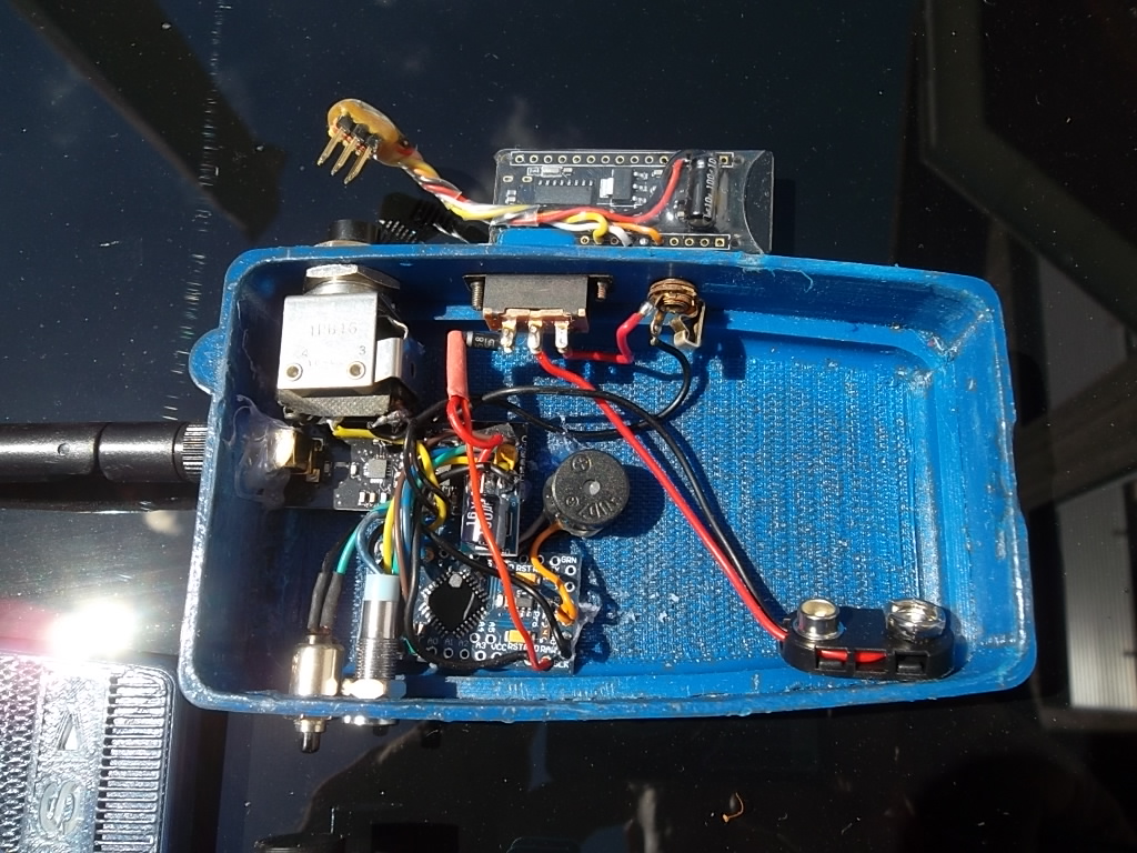

My second OS Pixie MK2 tranny with the Orange Spektrum module was also flighttested this morning.
It features S/C compound with kick-up elevator and quick blip throttle plus low voltage alert and inactivity buzzer on a Digispark Attiny85 module.
As expected no problems and no issues, just working great. Cheers
