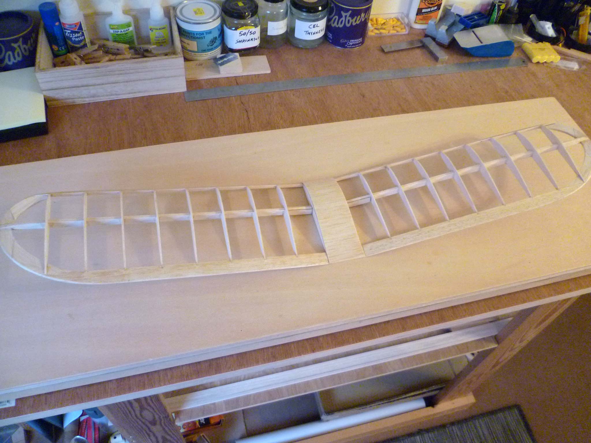

Stew, you can easily work out the distance under each wing tip using the "1 in 60 rule"....... 1 degree = 1 unit in 60 units and for angles up to about 10 degrees, that is quite close enough. So if the panel is 14" long, divide it by 60 and multiply by 10 and that will be the distance under each tip.... 1/6 x 14 = 2.3" (near enough).

Paul, after the ATPL exams, hell, PPL even!! how on earth did I forget the 1 in 60 rule? I used to teach students that when learning to navigate. Good lord.

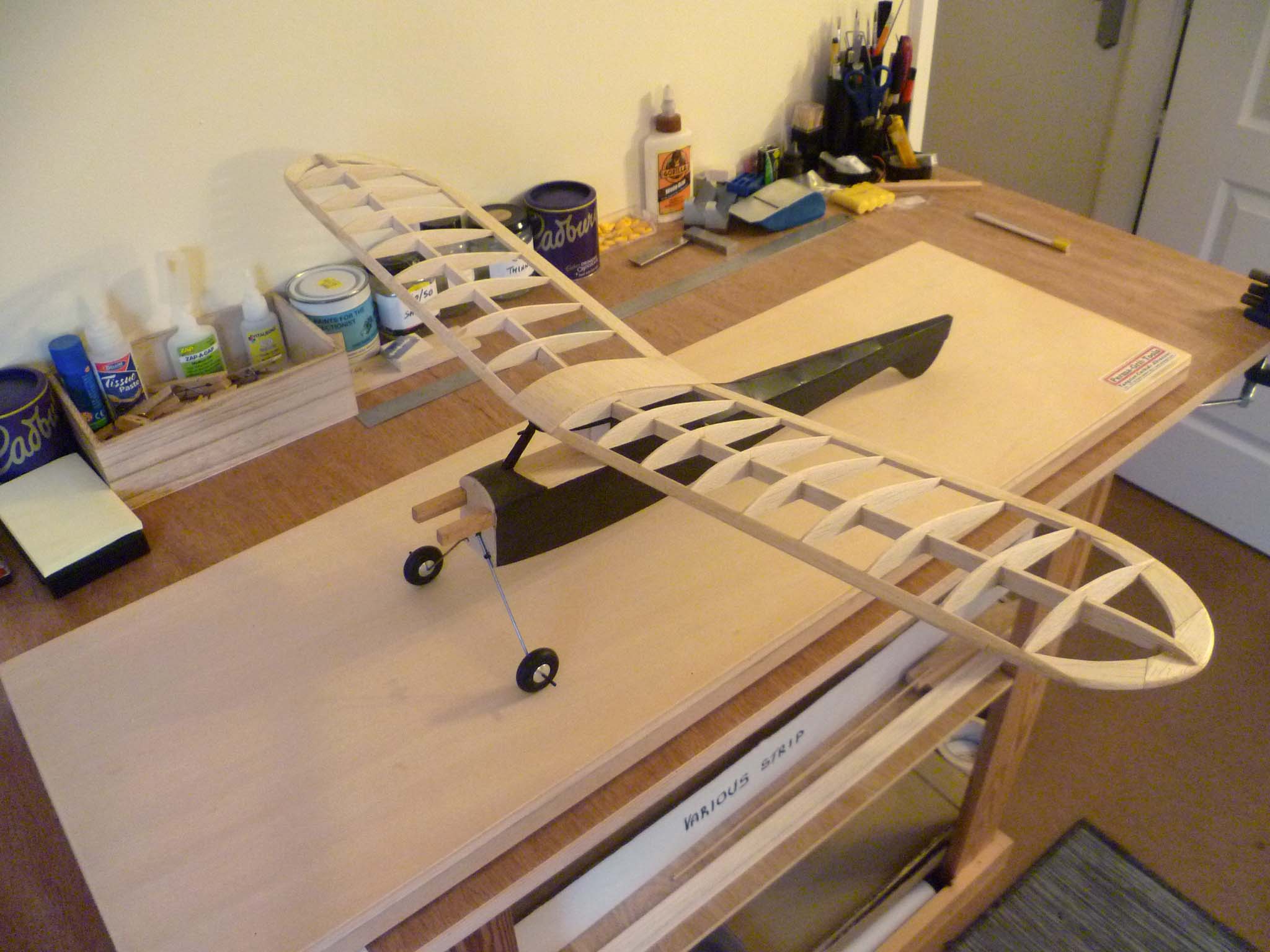

Titch has a wing now. Can't decide on the colour. Possibly red.

Yellow possibly, but not transparent. Unless I'm missing a joke lol. Im on the spectrum, Jokes usually lost on me! I tend to just nod and look baffled
