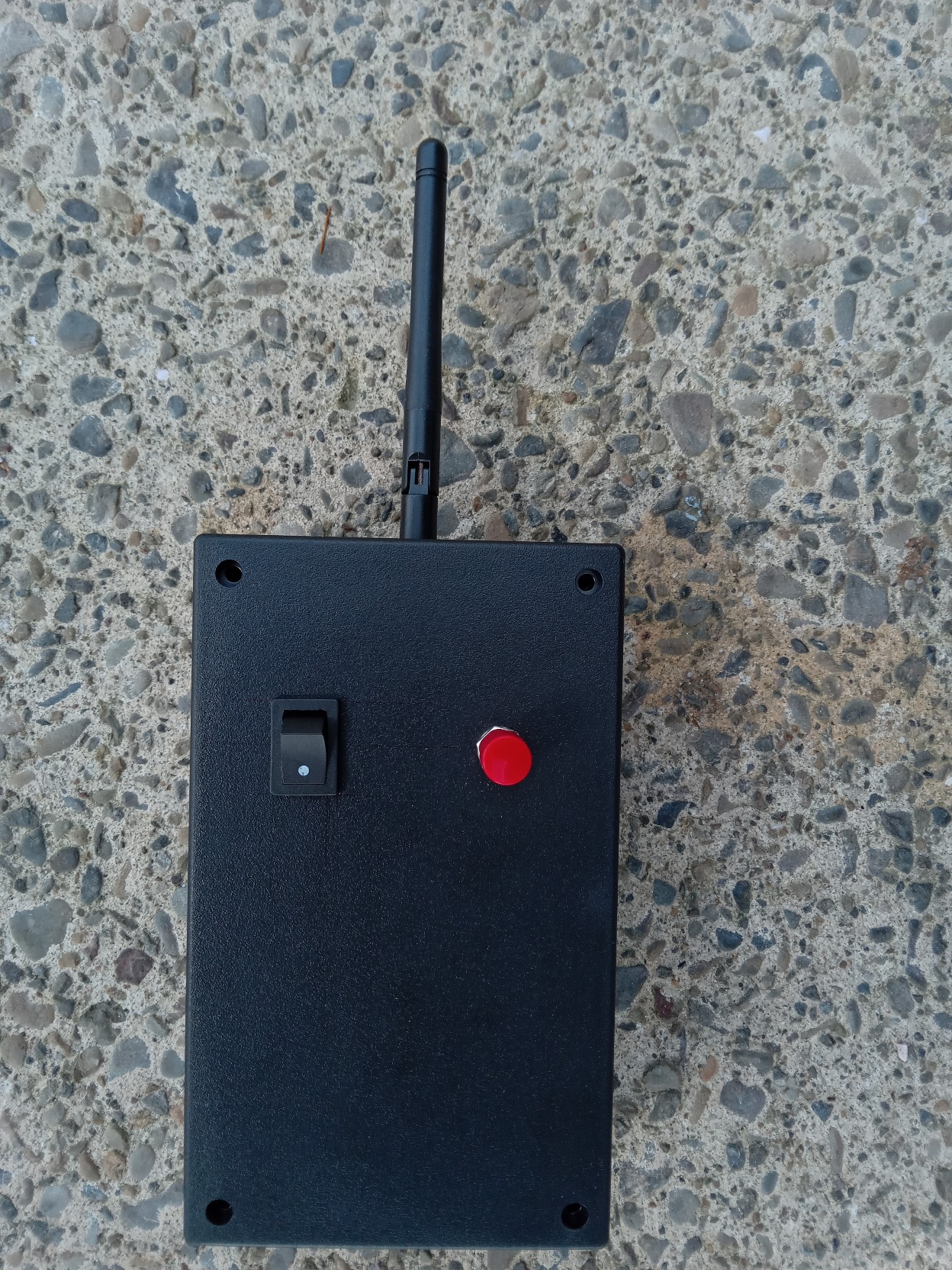

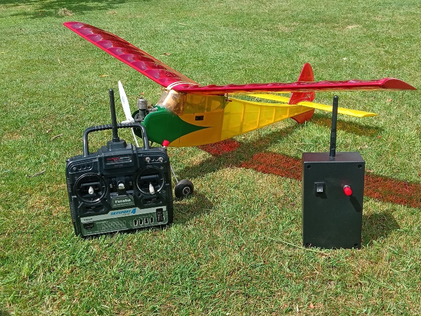

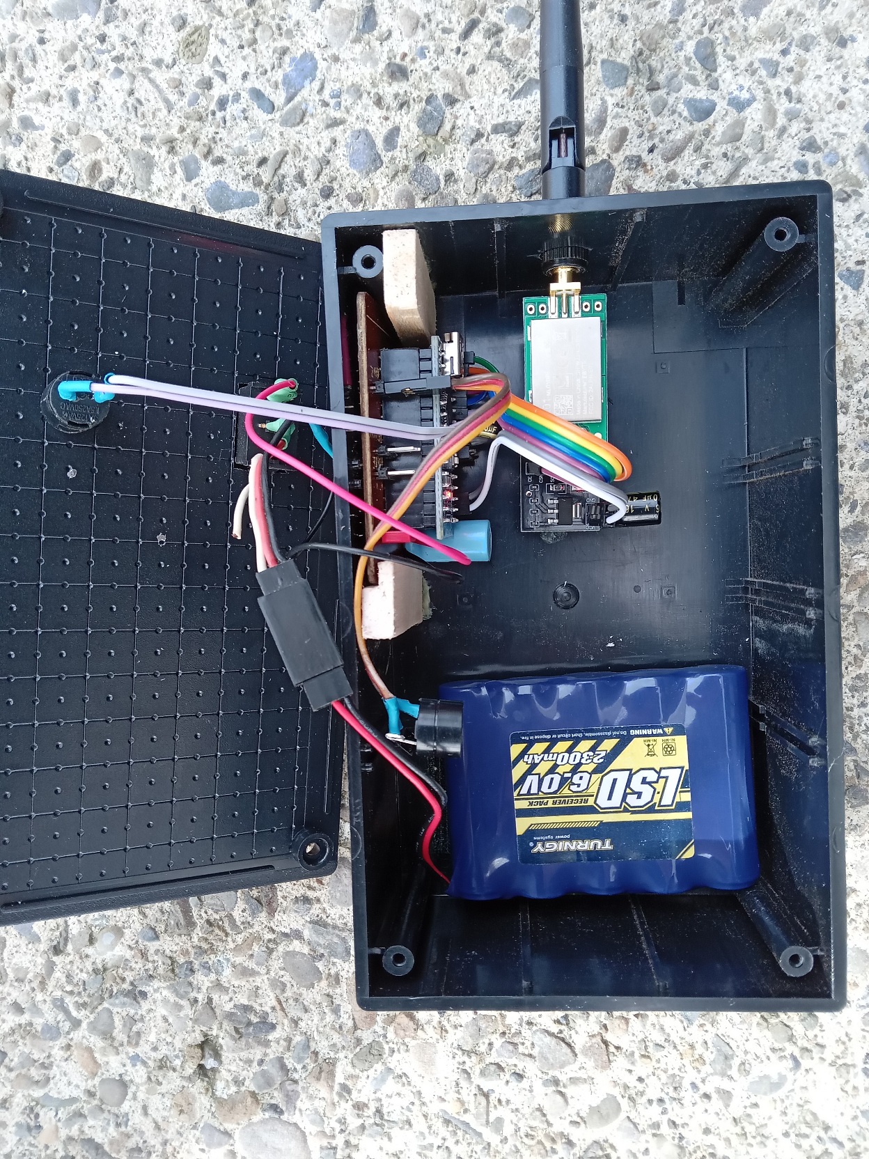

Just finished building a Tx using a shielded Keywish NRF. It all worked perfectly first time.
Test flew in my Tomboy yesterday. Had several flights using both the S/C and propo TXs. Great fun!
Thanks Phil for another great project.

Some projects prove to be popular, some dont ... theres been very little feedback on this S/C FHSS project one other than from Frank & Wayne (thanks lads!) so its great to hear that you've built & flown one! Which receiver did you use, a Keywish RF Nano?
I've flown the OS Pixie (previous page) many, many times as Shaun will attest, all slope soaring, what can you say it just works!
Actually the Pixie was an eye-opener for Shaun - when I first completed it he helped me do a ground range-test and was gobsmacked when we ran out of space and could no longer see each other!
