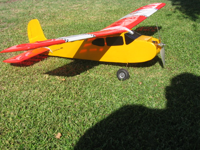

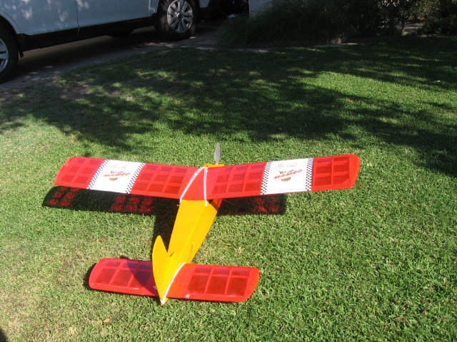

My Tobe GG actuator didn't have enough grunt to control my full size 48" wsp electric powered Mambo. Model was scratch built from Outerzone plans. No doubt it would be fine in a Mini-Mambo and similar sized/wing loaded models. I installed two Hitec HS-55's and now the model is fully controllable and is now a real pleasure to fly. It loves to thermal despite it's bulky 50's trainer looks. I am surprised how much I enjoy the model being a scale and sport model flyer
I used Sig Cub yellow dope and red translucent wing and stab covering. Wing logos were on Outerzone with plans and patterns. Had Callie Graphics make the original Sterling Wing Logos. Power is an old Thunder Tiger .10 brushless motor and 2200 mah 3S lipo.

Surprised re your experience with the Tobe Rand.
I have a Ghost Rider 38 with around a 200w power system and have plenty of control authority. A great aerobatic model with a symmetrical wing if you're not familiar with it. Designed by Dave Boddington.
Ps, the model looks great.

That's probably because it's so well built Shaun!

Nice Mambo E-Challenged.
