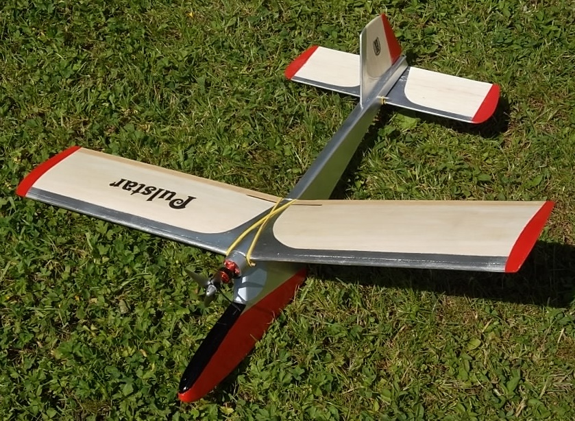

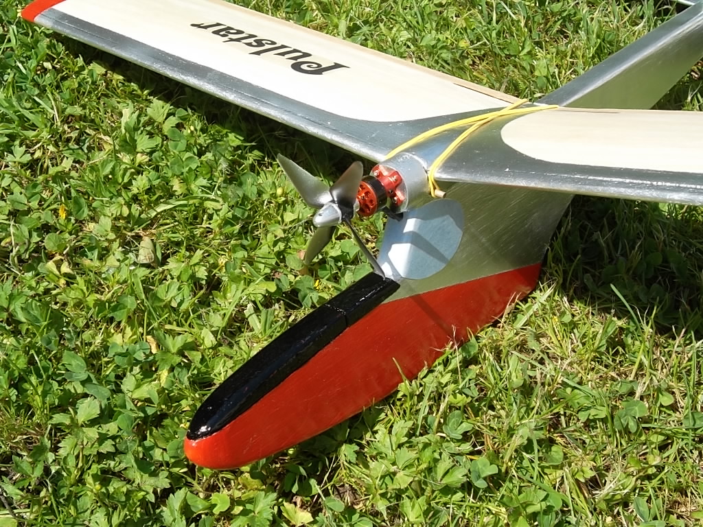

My Pulstar is ready to go. It´s built according to plan, just the rudder is 5mm deeper. The fuselage is very narrow, inside width is 12mm only, just enough for a 2s500 lipo and a 5g servo.
The AUW is 163g, which is not bad.
Using a 3x4.1 4-blade prop, current draw is 3A on 2s which is about 24W. That should be plenty to fly o.k.
Maiden flight will be next monday. If it´s a good flyer, I will build a second, wider fuselage to accomodate the new GG equipment, Martin just developed. This will be powered by a Cox TeeDee 010. Frank

As always Frank, a cracking model beautifully finished...

Very nice Frank! I always like the black 'anti glare' colour in front of the cockpit - it was standard on things like the de Havilland Chipmunk so that pilots wouldn't be dazzled by the sun reflecting off a shiny motor cowling.

Another nice looking Pulstar Frank. It's been nice to see all the individual finishes on the Pulstars completed so far.

That is a very nice colour scheme.

That looks outstanding Frank.

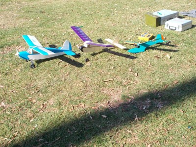

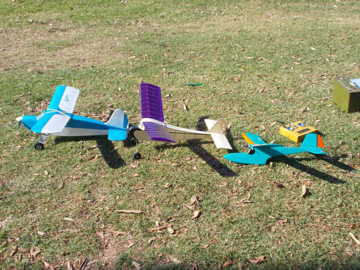

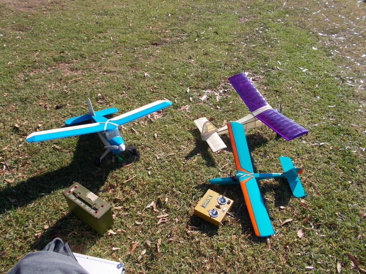

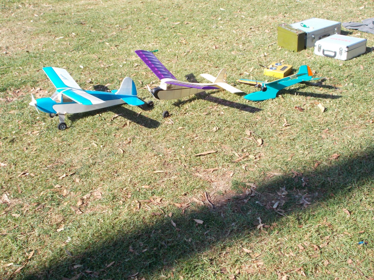

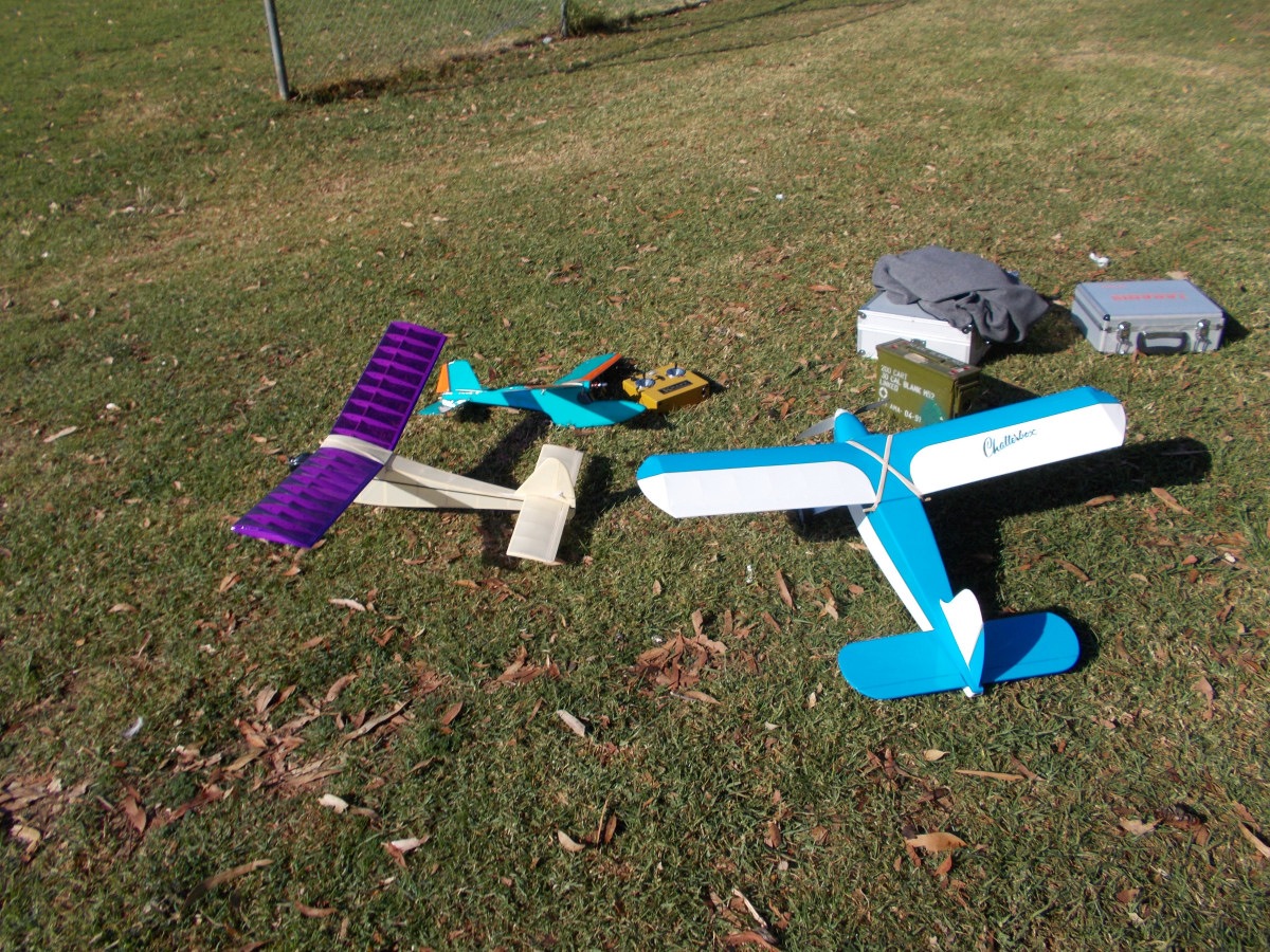

Mine had it's maiden this morning.
It was stalling badly initially. I tried to fix unsuccessfully with CG changes so I went back to original CG & shimmed the back of the elevator which was much better.
I managed 2 pretty nice flights in the end. It's still not perfect but well flyable & controllable. It'll be even better with a bit more tweaking. The main thing is a bit more right thrust. Great choice of model guys.
Finished the day with a couple of nice flights of the Chatterbox with the Kraft 71.
Top day.
Video to follow later tonight.
Al
