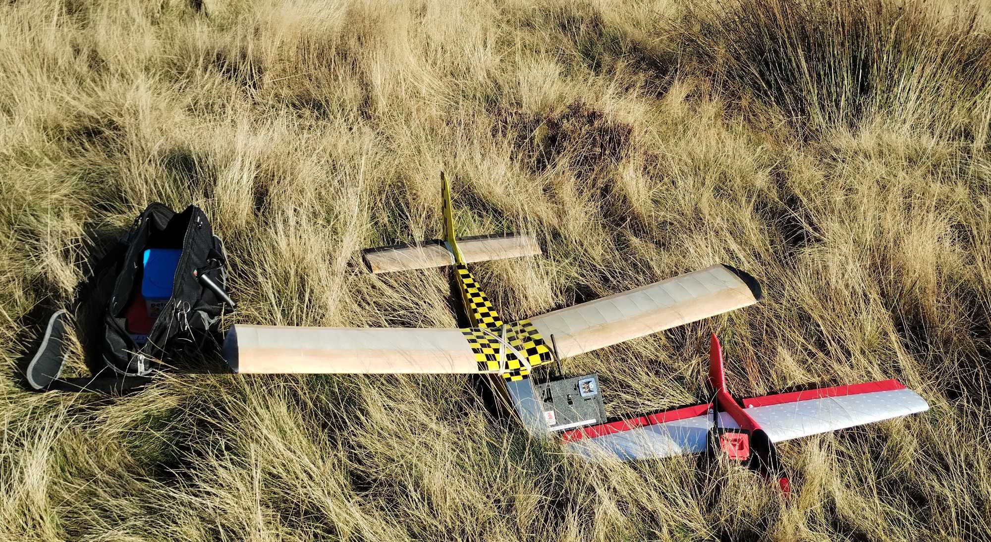

Just me on me todd at Baildon today, Billy no-mates, everybody cried off which was a shame cos the weather was brilliant,
sunshine all day and a 12-15 westerly :D Fish and chips for one please ;)
I'm joshing, it was good, sometimes quiet is nice, & there were several dog walkers to chat to & dogs to fuss :)
Didnt get there till 2pm as I'd forgotten Saturday traffic was heavy.
Took my older Remcom Impala for an airing and the Lidl Wing, flew them back to back all day. Bliss :)
I was using Shauns Digit Midget tranny as I'd been updating his NRF stuff, its been a while since I flew a propo Impala,
it really is a brilliant model for relaxing on top of a hill. More aerobatic than you'd imagine too. Theres no video but
Shaun's seen the reeds Impala flying inverted (silver fus, red wings), but its so much easier on propo :)
I had to make a new hatch for it, in earlier photos you'll see it was black, but it was lost years ago complete with battery pack whilst
inverted, the hatch & battery are probably still on Callow Bank somewhere... :D :D :D
Thought maybe a couple of local flyers might turn up but no, left about 5:30 as visibility was getting very silhouetty :)

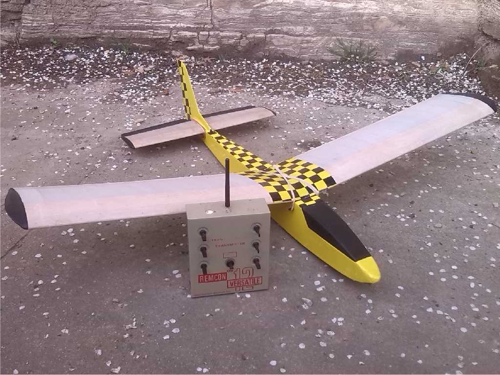

Has your impala got a lifting tail or flat plate ?
Re: Been sloping...
I've several - all clark-Y tailplanes as designed :D
