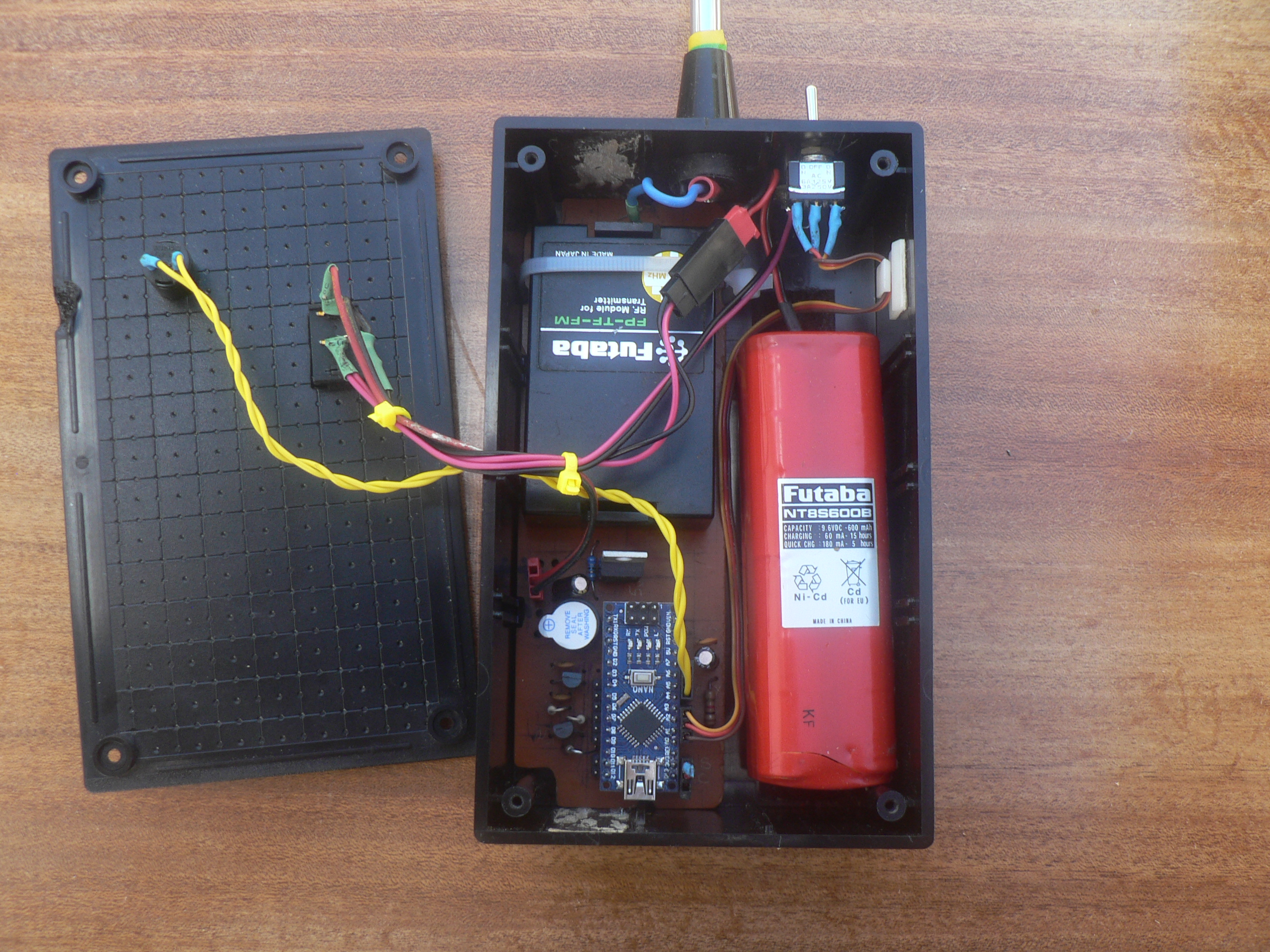

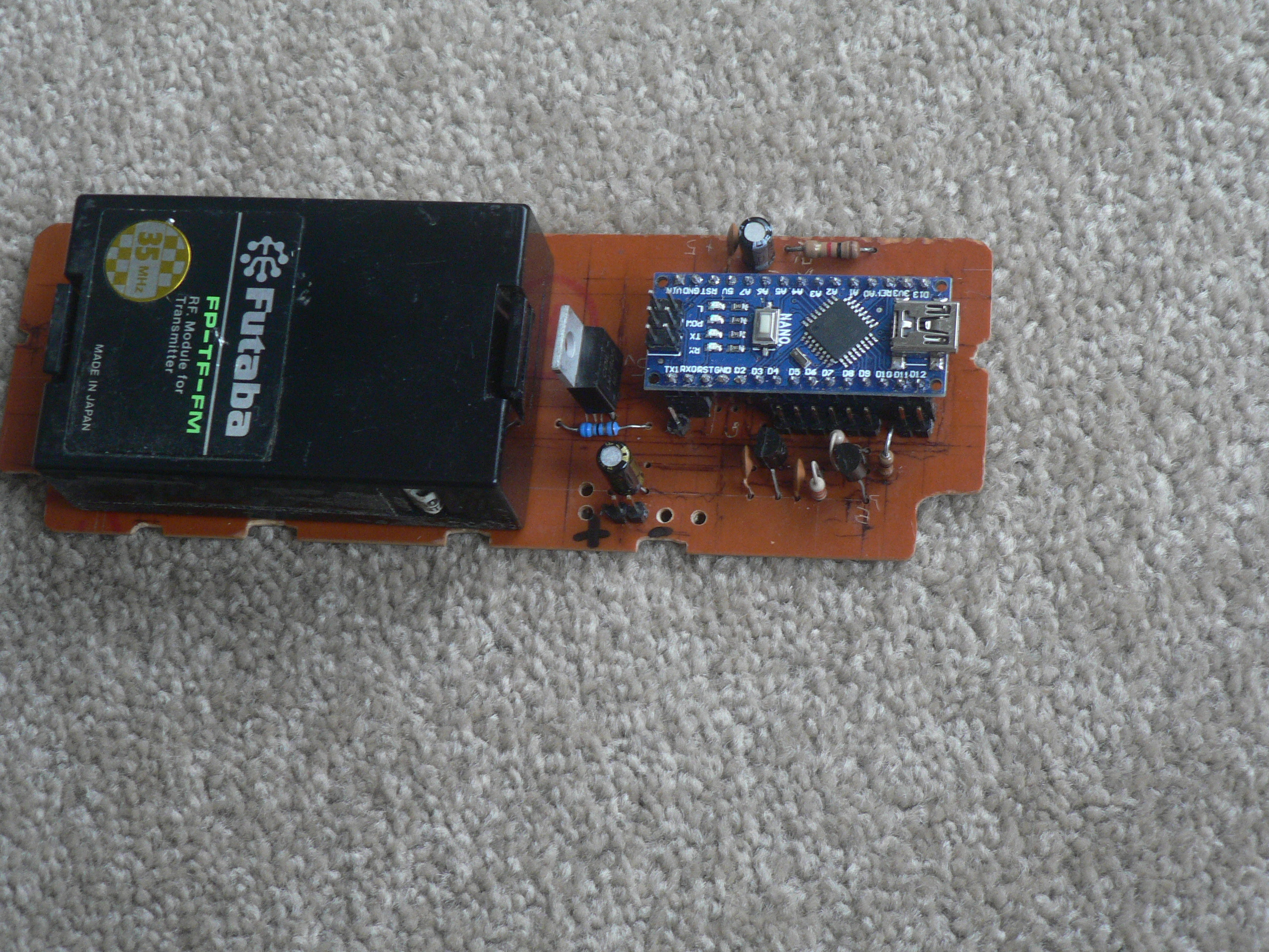

After reading Max's post again I managed to solve the problem. I built the encoder up on a pc board that the R/F module (35Mhz) sits on and also has a pulse inverter and buddy box input built up on it. As I want to use it in compound mode the link between pins 13 and A0 was part of the pc board. Max pointed out I needed to remove ALL the links before trying to program. After cutting the track and inserting a header to plug the link into it all worked. Took less than 2 mins to set up!
Thanks again Max.

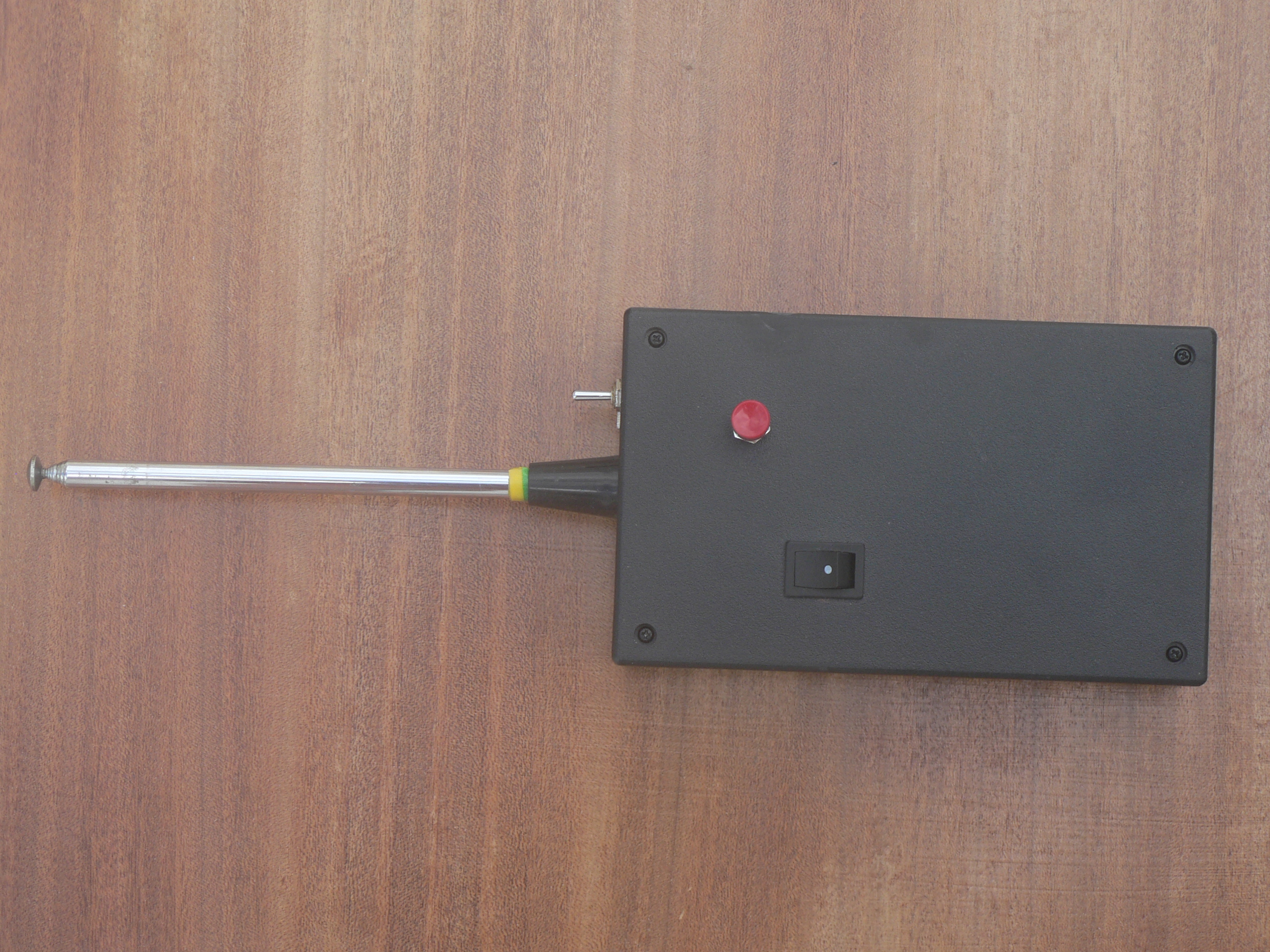

Below are a few photos of the pc board and completed TX.
