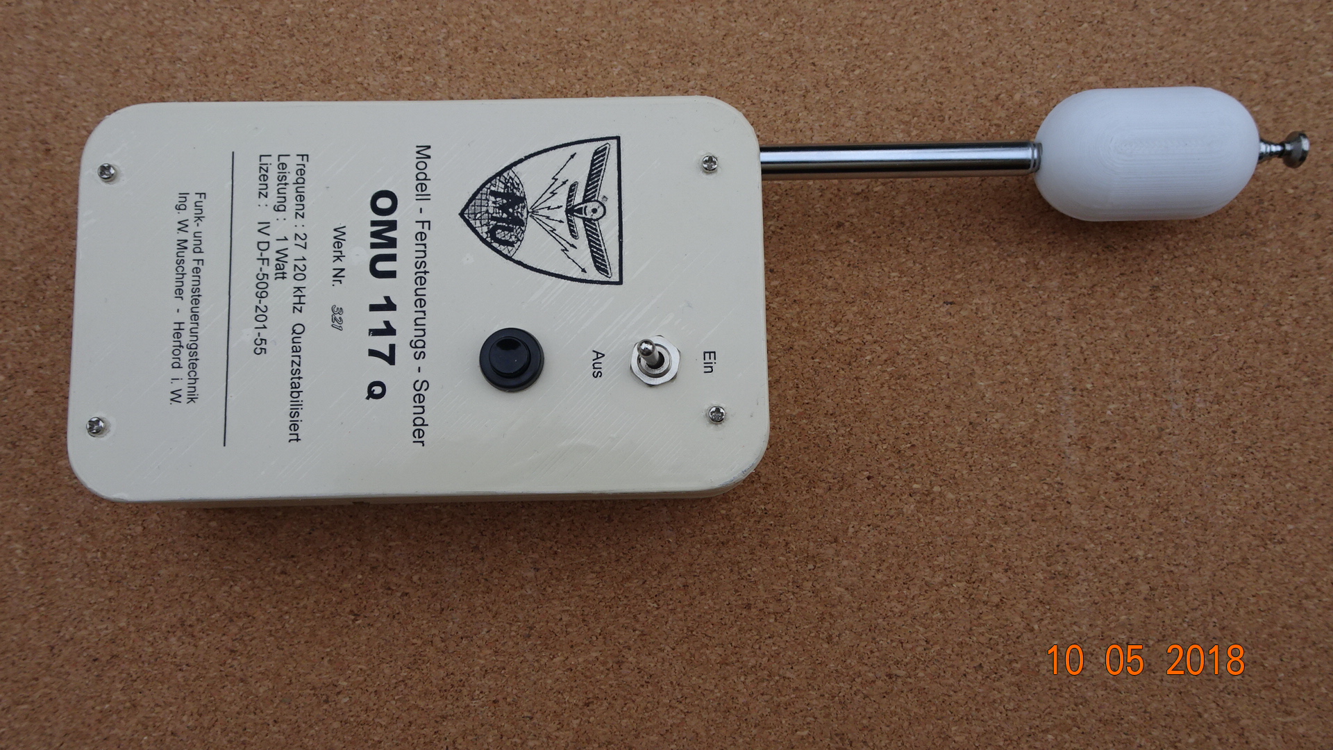

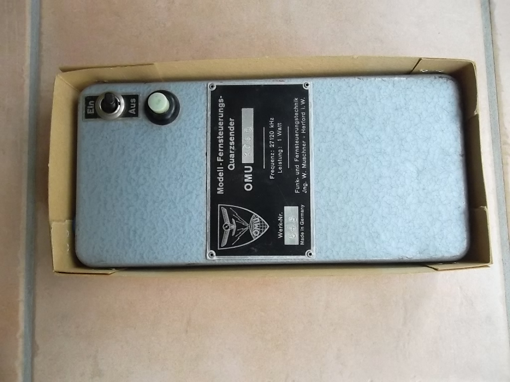

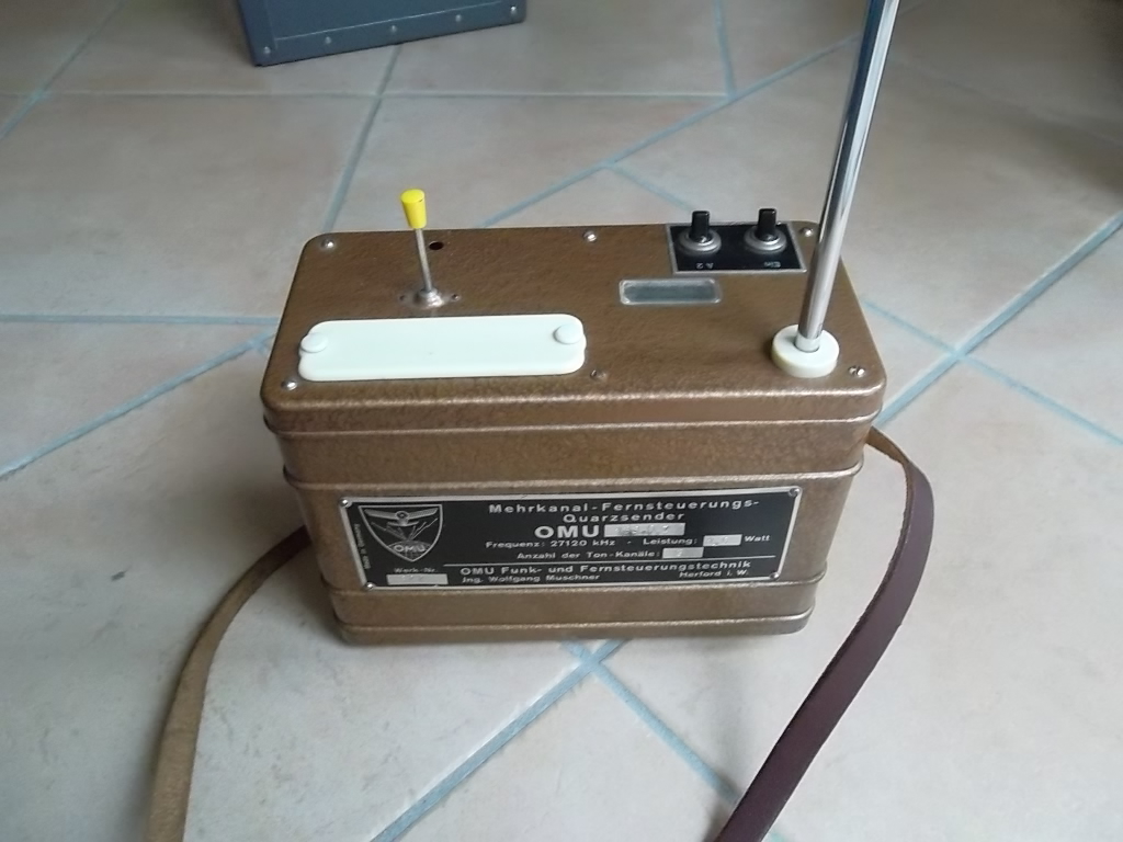

Those are some nice vintage sets in your photo. I bet Frank, also from Germany, probably has one, or a replica he's made.
tiptipflyer
Posts: 406
Joined: 16 Feb 2018, 22:49
Location: Germany
Re: SBUS decoder, display, and wireless buddy box project
Post by tiptipflyer »
Yes Martin you are right.
Th OMU117Q is a replica, all others are originals and are all in working condition.
