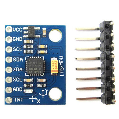

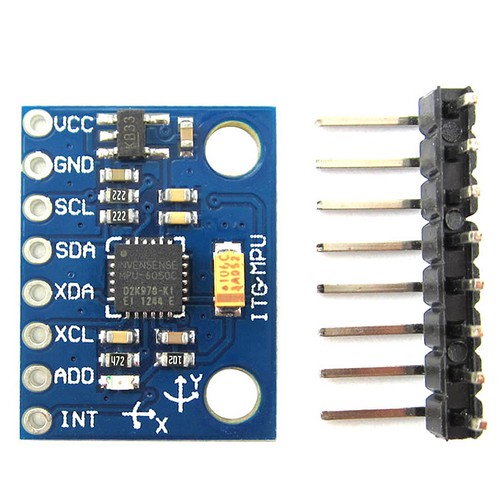

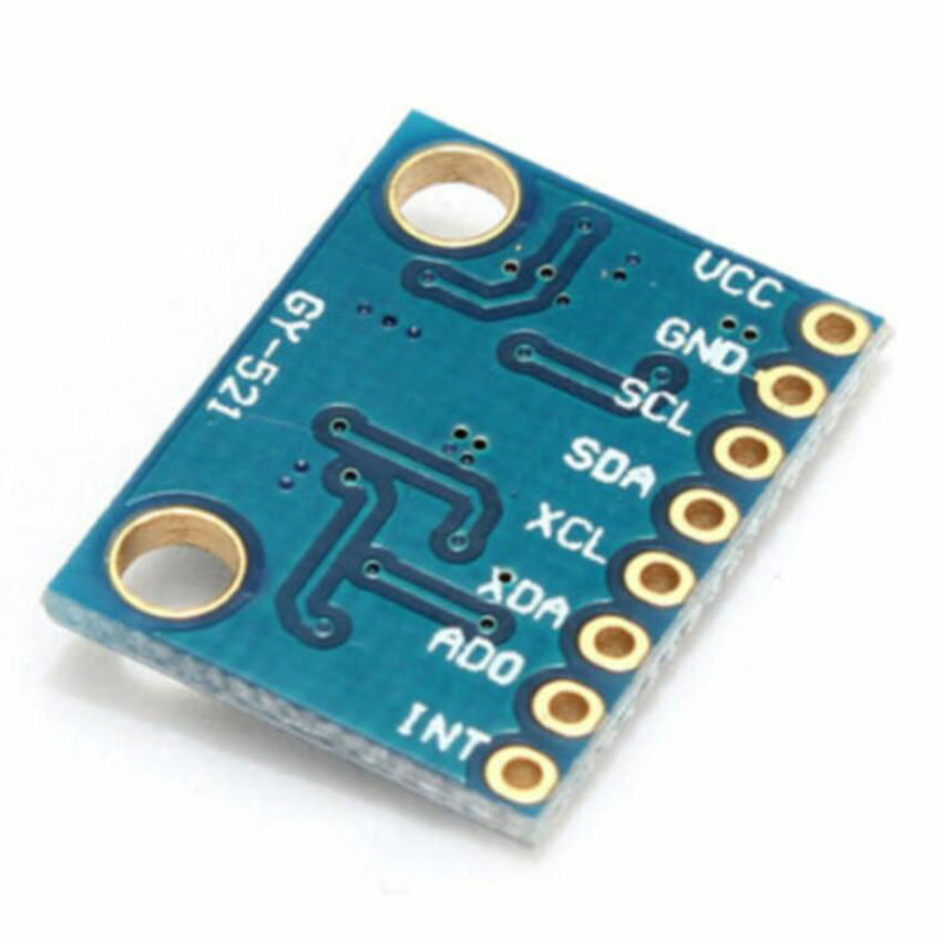

Have a couple of GY-521 modules which have the MPU6050 chip which I think should be ok.

Jorgo, yes that's the same module I'm using: GY-521. Sorry, I don't understand what you meant by your 'P1 for dual purpose' question - can you elaborate?

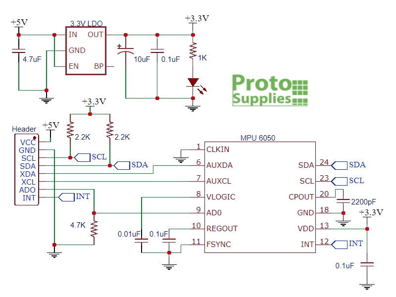

Edit:.... noticed this in your program....
// ******** IMPORTANT! pull up resistors MUST be fitted to SCL and SDA ********
// ******** you might get away without using them on a 328P, but you ********
// ******** probably won't with an ATtiny85. You have been warned! ********
The GY521 board I have here already have 2K2 pullups to the 3v3, so are you saying they require additional pull up resistors ?
https://protosupplies.com/product/mpu-6 ... or-module/
Assume your pin numbers in the comments (3,4 and 1) are same as D0 to D4 below.??

That's interesting. I did find I needed additional pull ups on my breadboard rig for reliable operation. However, I did have the USBASP connected to the SDA and SCL lines, as well as the gyro, and I was also using the USBASP to power everything ( including the servoThe GY521 board I have here already have 2K2 pullups to the 3v3, so are you saying they require additional pull up resistors ?
