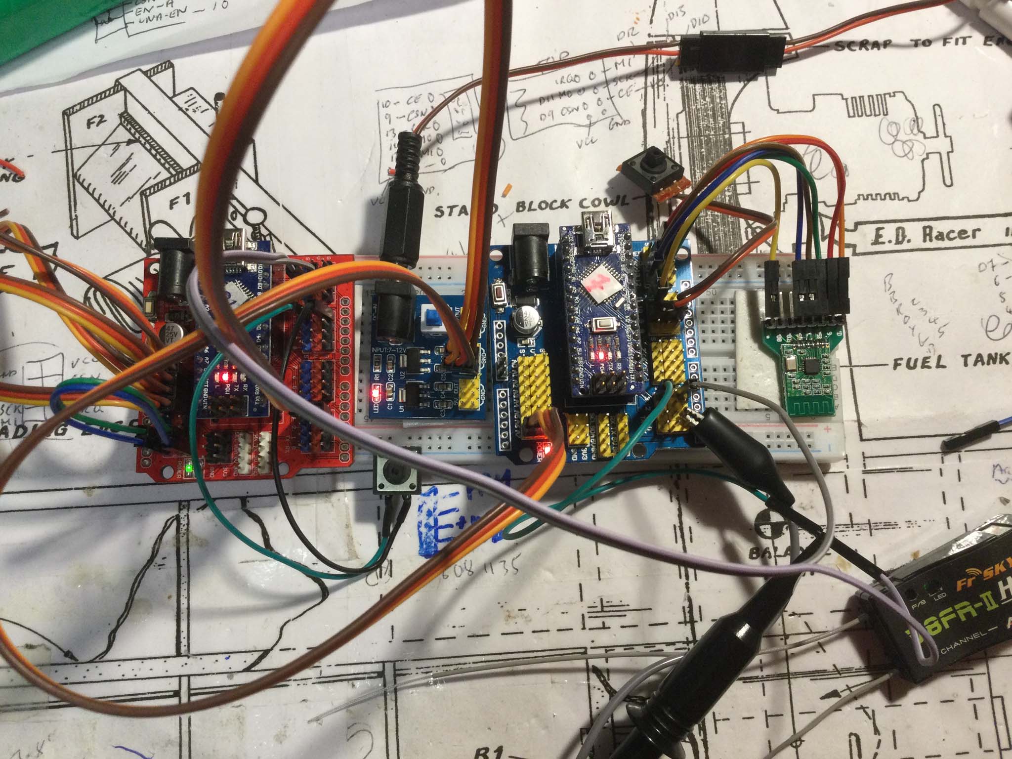

Here is a pic of my setup, may not look too tidy.
From the left:
Arduino Nano loaded with a Phil G encoder, powered by 3.3v from power supply board.
Power supply board with a 10v battery input and 3 5v outputs (not used) and 3 3.3v outputs (2 used).
Arduino Nano loaded with cppm sketch, powered by 3.3v power supply board. Ppm input to pin 3 (sketch amended for pin 3). Scope probe connected to ppm input.
CC2500 low power module connected to arduino on pins 10 - CSN, 11 - MOSI, 12 - MISO, 13 - SCK. 3.3v power from Arduino shield power rail.
Frsky V8FR receiver showing green bind.
I have tried the basic 4 channel sketch but also with no servo movement.
I do have some spare CC2500 modules so next I will try swopping it.

Re: FrSky V8 transmitter module using Arduino and CC2500
If it's transmitting (as seen by your spectrum analyser) then the CC2500 module is probably fine, and the Arduino must be communicating with it okay. I don't understand why it would be able to send all the information to make the thing transmit, frequency hop, bind, and so on, without the actual channel data values getting through. It uses the same data registers to transmit the "I'm in bind mode" data that it normally uses to send the channel values - so there's something really strange happening.
Have you bound the same receiver to a known working FrSky V8 transmitter and verified that the servos move with that? Perhaps it's a bad receiver, bad servos, bad receiver battery, or bad receiver-servo connections. Are you sure you've plugged the servo plugs in the right way round?

I have 2 identical V8 receivers which I have checked out as OK with another transmitter. Both working OK.
I have found that the battery supply to the power board was dropping so changed it.
Also checked the receiver battery as well.
Like you I do not understand why the ppm input is not working. The Taranis and Phil G ppm inputs are the same I used on a MPM module setup which worked OK.
Did change the CC2500 with no change.
I will go over my Arduino IDE sketch to see if I have missed something on the settings.

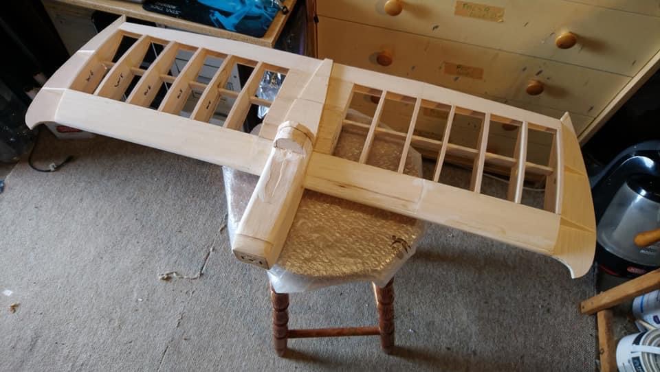

Note - the plan on the bench is for a Keil Kraft Talon (electric powered and radio controlled) which has been pushed aside for the electronics!

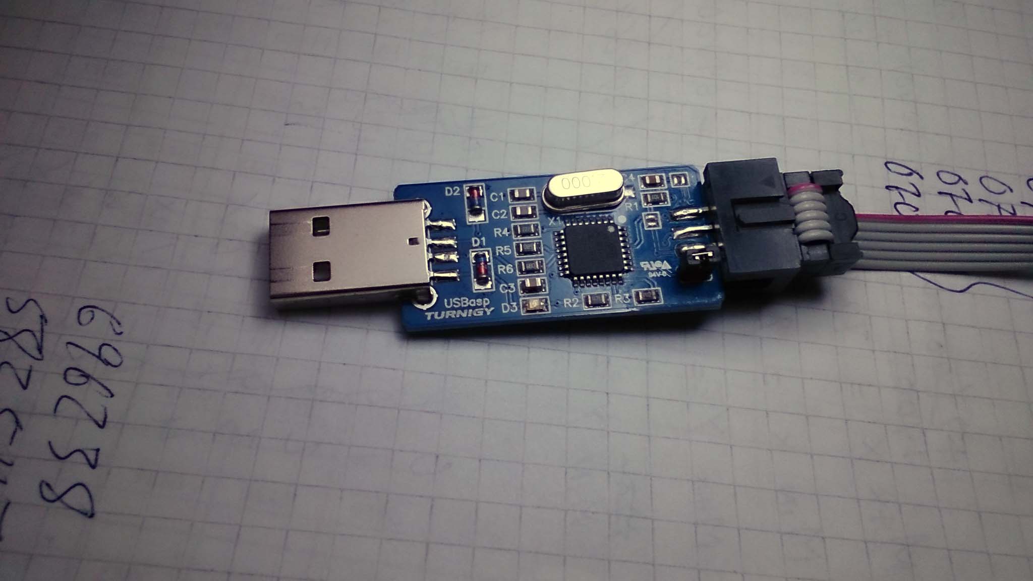

On a separate note, reference using the serial monitor. I have two USBASP's one that I use mostly and works well is the Turnigy one and has a voltage output of 5v (no jumper that I can see to change to 3.3v). The other is a ebay standard USBASP that is working on 3.3v but does not load a Arduino sketch (error message to re load firmware).
Therefore to use the serial monitor I have to disconnect the CC2500 from the arduino and use a standard usb cable to connect to the Arduino (on the USB port). CC2500 disconnected because of 5v from the USB. So I cannot use the serial monitor with the CC2500 as I cannot supply the Arduino with 3.3v and view the usb port at the same time.
I must say that I am not sure what driver the USBASP should have. I have used Zadig to set the driver, but there are some options:
WinUSB(v6.1.7600.16385)
libusb-win32(v1.2.6.0)
libusbK (v3.0.7.0)
USB Serial (CDC)
I am never sure which to use. Any advice?
The Serial Monitor does not seem to work when connected with a USBasp but should it?
Just trying to eliminate some possible errors.

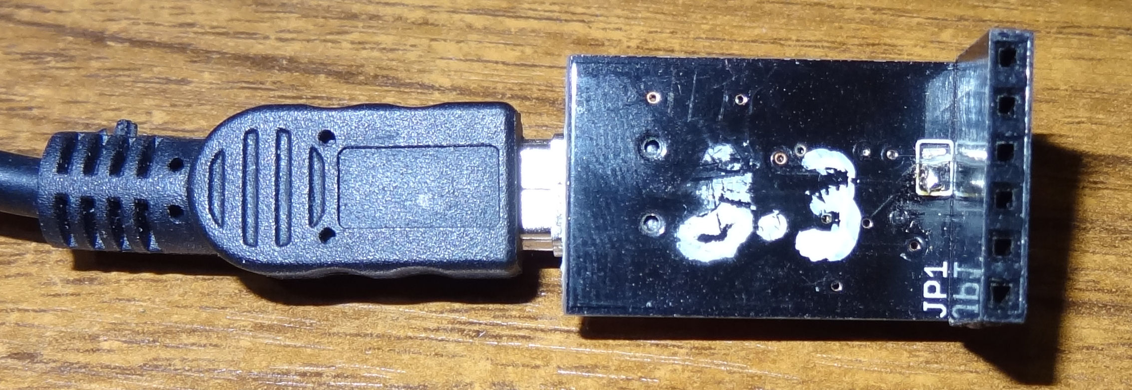

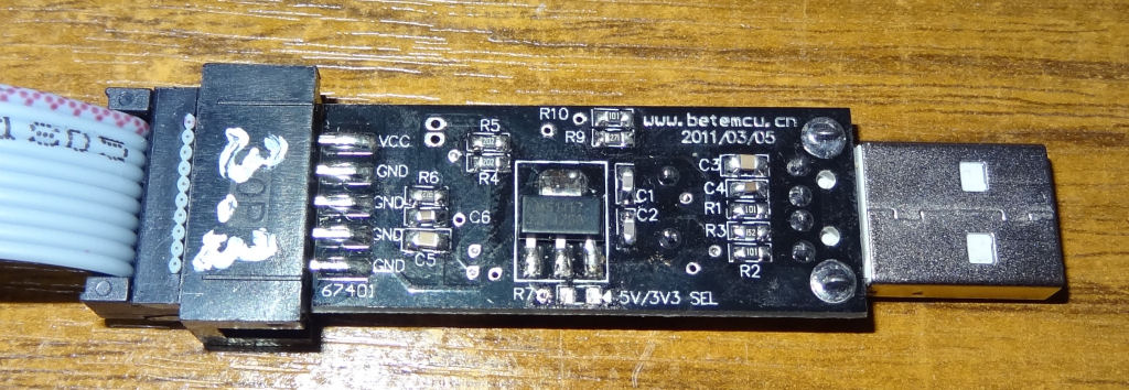

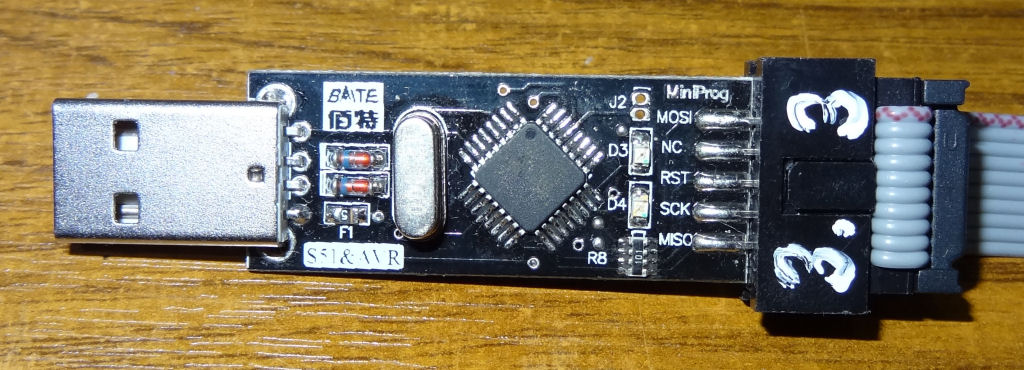

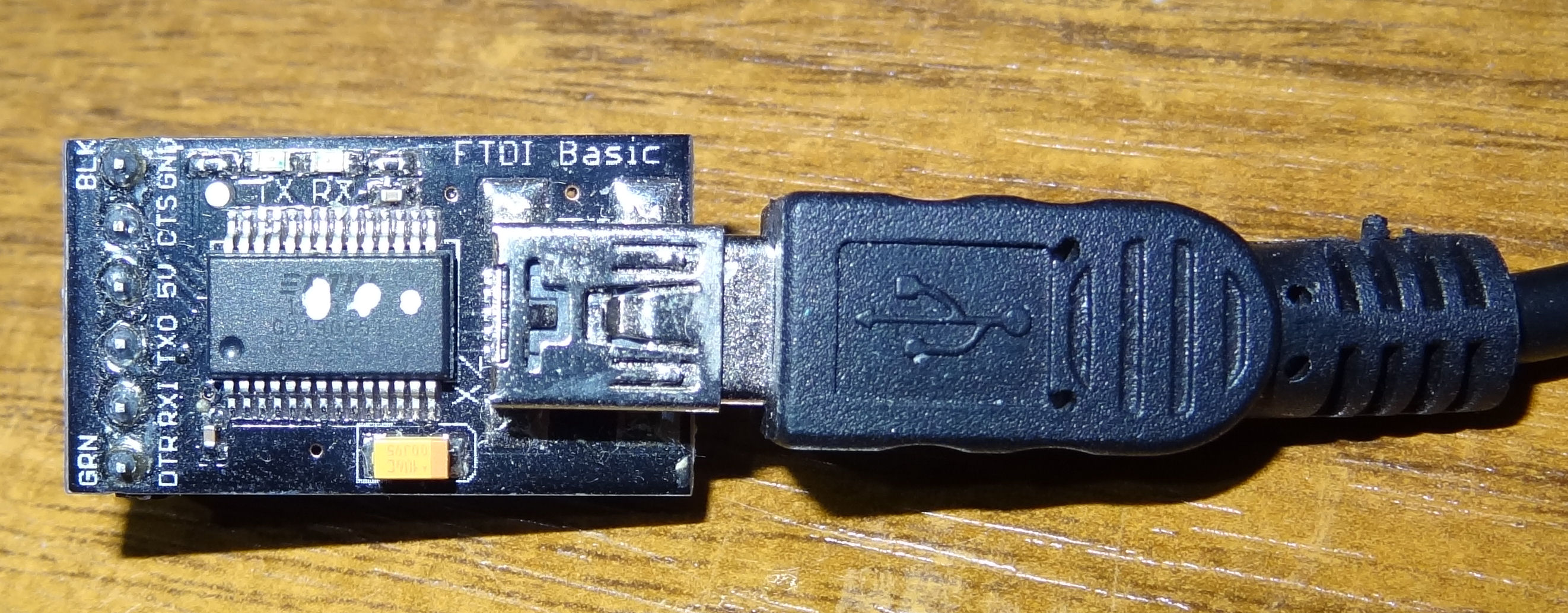

I normally use Linux, where there's no having to install drivers - USBasp and Serial adapters work right out of the box. You do, however, have to add your user account to the dialout group or you don't have permission to use those interfaces (unless you start up your IDE with sudo)
But I just fired up Windows to check. My USBasp can be connected at the same time as my CC2500 module. It's working fine and is using the driver WinUSB (v6.1.7600.16385). It has enough power to work the Arduino and the attached (high power version, from Banggood) CC2500.
I think I got it from Hobby King. Out of the box it was 5V, but there was a tiny surface mount resistor (probably a zero ohm link - I never checked) soldered across two pads on the bottom of the board, marked "5V/3.3V SEL" on the silk screen (click on photos for larger view). I removed that resistor/link and then it worked at 3.3V - I verified with a multimeter and scope that all the signal lines worked at 3.3V - not just the VCC output.
Recently, I upgraded all my USBasps to the latest firmware - which made them run much faster. Details on how to do it and downloads at https://www.fischl.de/usbasp/ You use one USBasp to update the others - I think you can get an Arduino board to work as an updating tool, if you only have one USBasp, but I didn't try that.

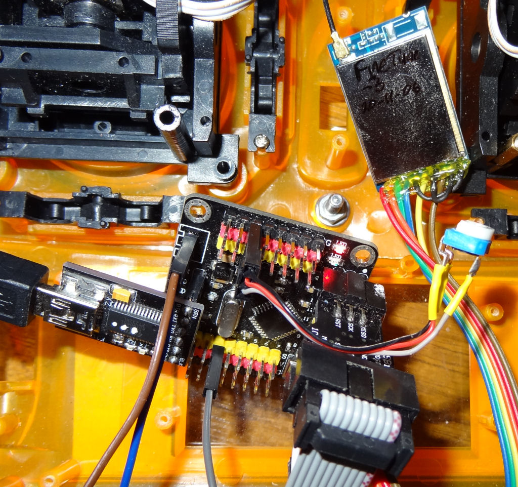

For 3.3V serial, I use a genuine FTDI board which I've had for years. I bought two of them, and they were both originally 5V units.
To convert it to 3.3V, I had to scratch through a 'link' track on the back of the board and add a blob of solder to link two pads the other way (they're in a group of three marked "JP1", up near the connector)
Although the silk screen still says 5V, on one pin - it's really 3.3V on that pin and all the signal pins too. I write on my adapters using one of those white "TipEx" correction pens that typists use - 3.3V / 5V if there's room, and just three or five dots if there isn't.
The serial board is also (just) capable of powering the Arduino and the high-power CC2500 - but the Arduino resets itself and restarts when I switch from range test power to full power, or vice versa.
I can have both connected at the same time, and with the Pro Mini Strong, they both just plug straight on, with no adapter wires.
The other three wires you can see connected are the ones that go to the buddy-box DIN connector you saw connected to my old Futaba Gold in the video. I can have that connected at the same time too (it powers the Pro Mini from the Futaba transmitter battery through the buddy cable into the 'Vin' pin. I can leave the serial and USBasp all connected at the same time - no problem!
