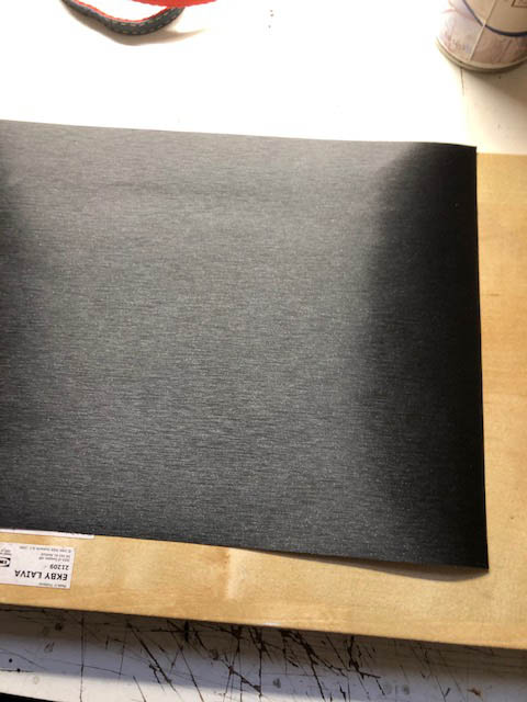

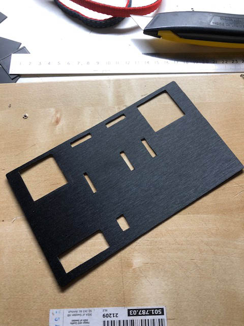

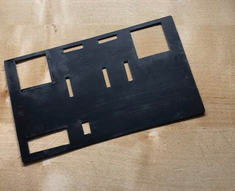

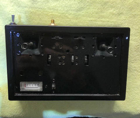

Had a few more hours in the workshop today made a bit more progress , mounted all the peripherals sticks switches, trim pots, and so on, charger socket on side, and Sixth channel switch on top corner added (as suggested by Stuart, Thank you) ..
Made the Sub Front panel from black Plasti card, carefully notched out all the slots and stick apertures', this did take time and patience, and then I obtained some Black Brushed effect Vinyl, Stuck that on to the sub Panel , with a brand new Stanley blade removed the vinyl from around the slots and apertures', next posting should be the final episode in this project, and that's to install the electronics, and make it work !!, that's the difficult bit

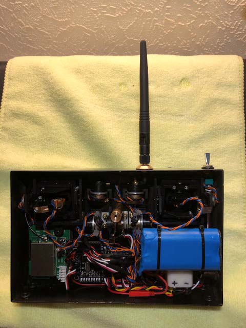

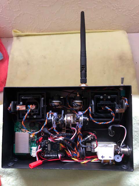

Another day in the workshop, mainly waiting for Amazon and the Royal Mail for the last few bits , anyway, mounted all the boards (Two)
Wired the bits and pieces together, made a battery mount about the two push buttons , and held the battery in with a couple of TyRaps..

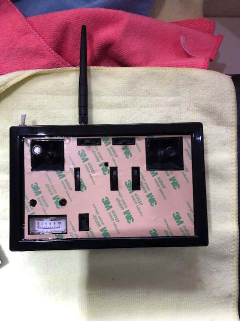

Set all the parameters up on one of Phil's encoder boards, tried all channels out with appropriate receiver and servo's, happy with that, mounted the facia permanently onto the front panel , last thing I have to make is the alloy stick tips, until then a couple of shots showing the inside rear, Final reveal will be either tomorrow or Wednesday...

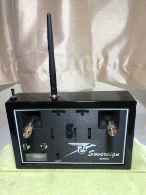

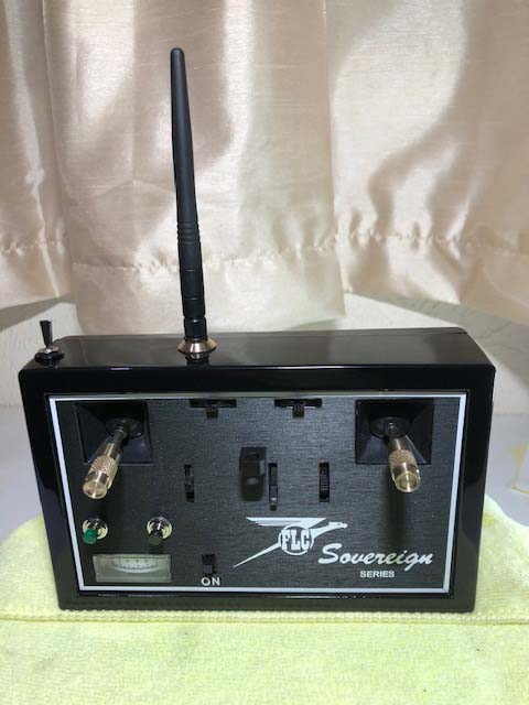

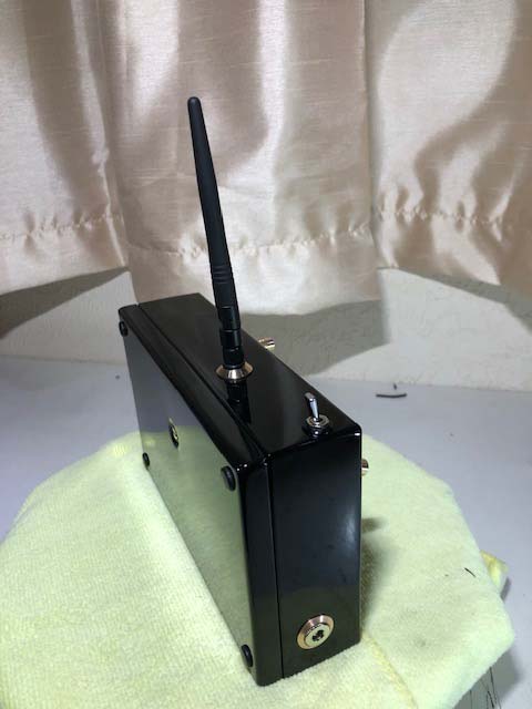

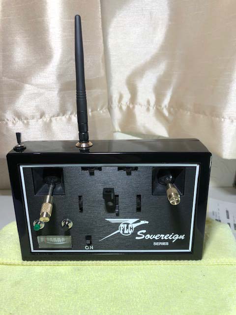

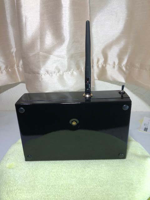

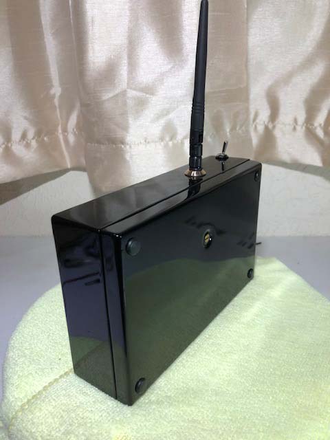

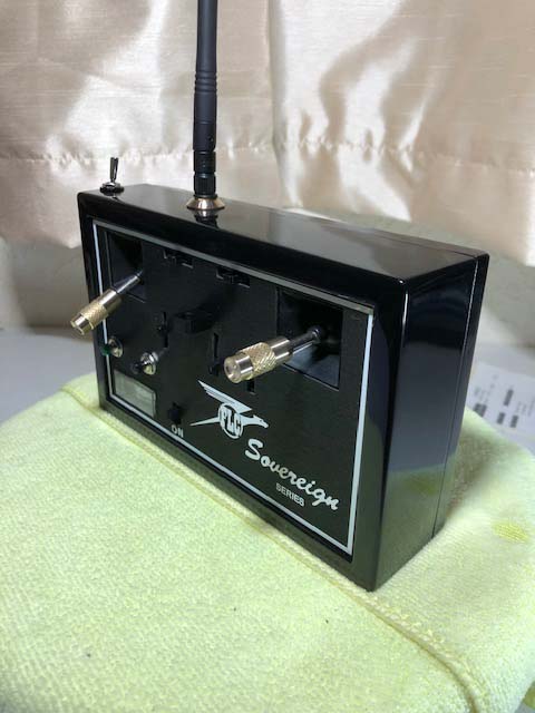

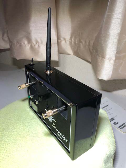

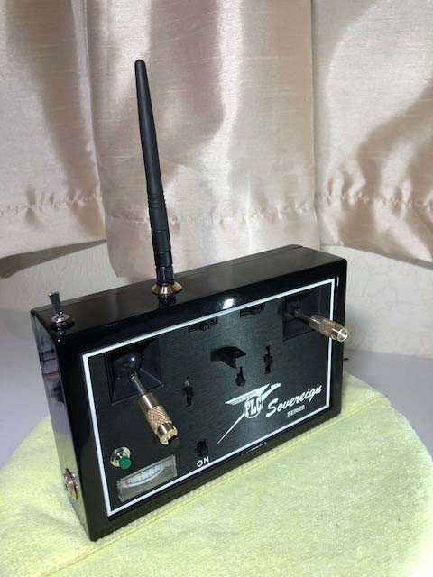

The Final Reveal
Well nearly two and half months in the construction, lots of help behind the scenes from Stuart M And Mike K for their measurements and pictures of original set , which they are both lucky to have in their collection, despite making a modern day version, I still hanker for an Original set, so if anyone knows of a set up for sale ,please let me know , it will not be converted just left as original..
Below are the final end results in pictures , any questions will be gladly answered, and I hope that everyone who may have doubted the completion now knows that if I take something on in life, its finished and to the best of my ability.
Thank you to everyone who made comments through the build process, giving encouragement , and also asking ''What's Next'', there is a next project,I believe Mike K knows what this is .............. to be continued

Re: Recreation of a FLC Sovereign 5 channel Tx
Absolutely Superb!!

Hi Robert
I think this is the most ambitious re-creation I have seen, but it's also by far the best re-creation I have seen too, stunning job. I'm lucky to have an original Flight Link sitting in front of me and from the photos, it looks so like my original I couldn't tell the difference, except the antenna and push-buttons which would be the same for most conversions anyway. Idris Francis would have been proud of it!!
Cheers Mike
ps I've rotated your photos straight, I hope that is was OK to do so.
Cheers Mike
