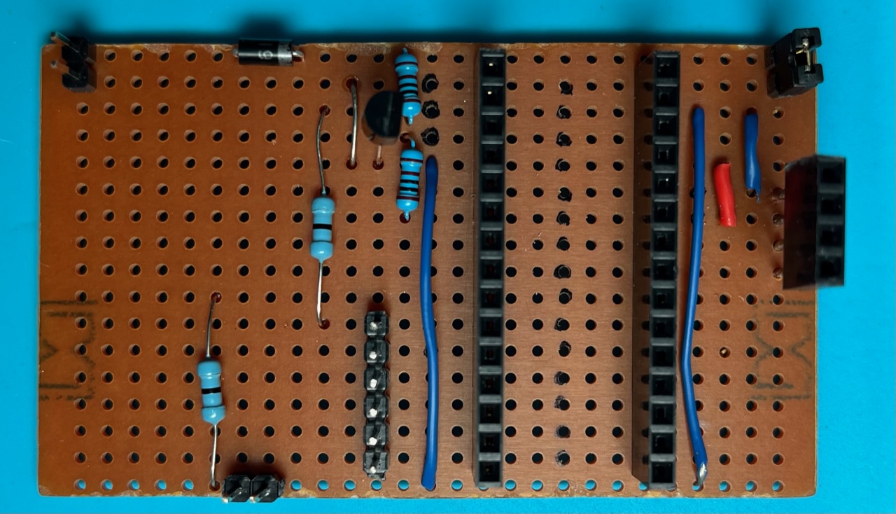

Phil_G wrote: 03 Jun 2019, 13:19 I think it's a mis-count Max, D2 isn't connected to anything, but gnd is right next to it. All the blue jumpers are gnd. The only thing to watch is the track breaks between the Digispark power pins as they are between adjacent holes. As you say, the DigiSpark Vin isn't used.
Power to the Nano is 12v via the header link seen top-left of the 3rd photo, next to the display header.
If I get time I'll do a layout drawing maybe tonight or soon.
Edit: Done during tea-break! added to 1st post
Thanks Phil, nearly got it right then.... :? ;) I mistook a darkish solder joint for a track cut and had the end of the link to GND shifted to the right by one hole :oops: :D
And, in doing the schematic, I overlooked the link between the battery minus and GND, hence my observation on that.
Max.

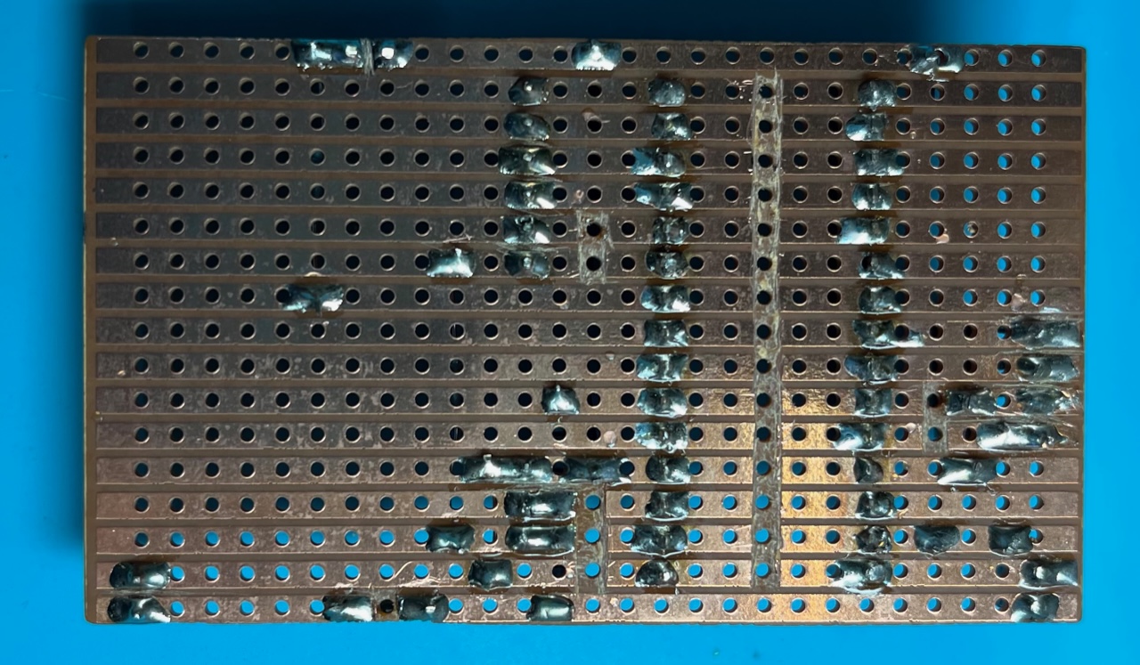

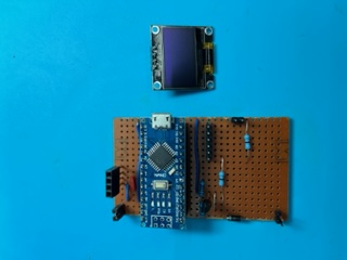

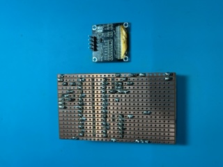

Built fuse programmer and uploaded sketch to Nano without any apparent issues. However the I2C display does not work. Gnd and VCC have power. I bought a 3 pack of the displays and none work. I attached copies of my board both front and back. Anyone have any suggestions as to what to troubleshoot next? Thanks.

Phil_G wrote: 19 Jul 2023, 21:12 Hi Wayne, I'm at the model car racing club but when I get back I'll compare our Vero photos, could you post a higher res pic please? Both sides if poss, with the nano out :)
Thanks Phil:
Re: DigiSpark with 6 input/output pins, homebrew fuse-programmer

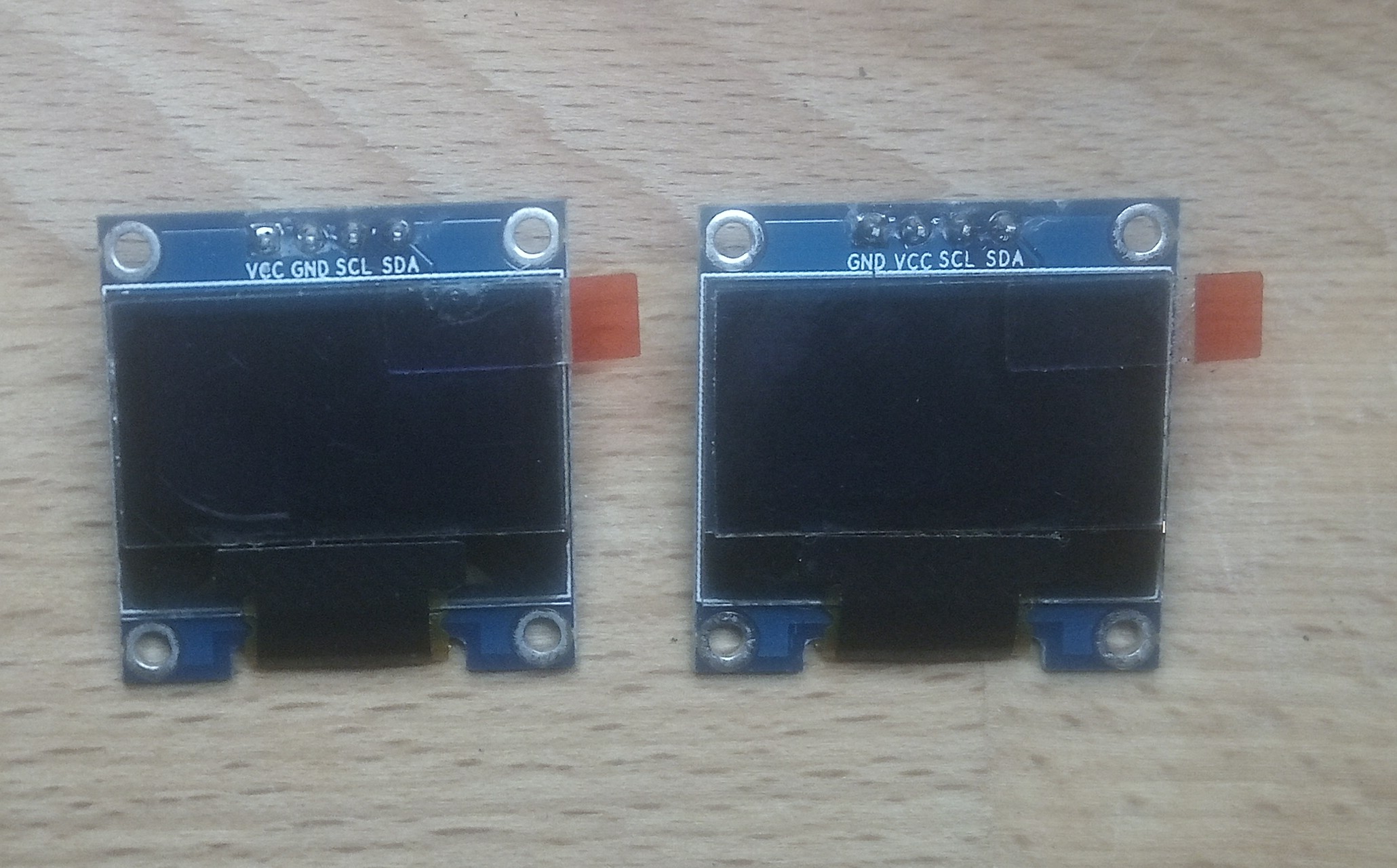

Looks ok to me Wayne. one thing to check is the pinout of the OLED, they do vary:

Thanks for looking the board over. My display is like the one you showed on the right (GND, VCC, SCL, SDA) so I should be ok there too. Uploading the sketch worked after I added the U8gLib file. I uploaded the sketch using the USB port on the Nano and not the ICSP if that matters.
