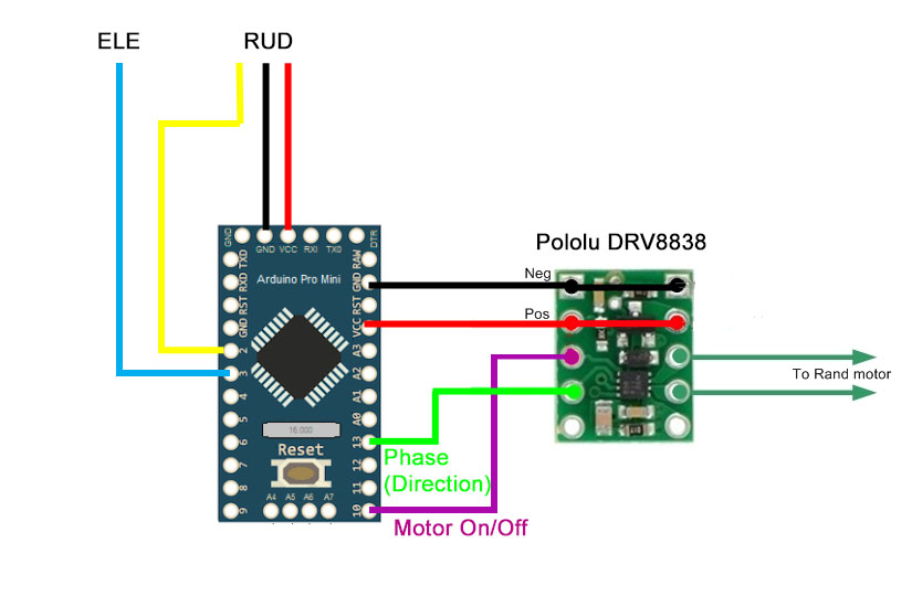

Hi Tobe
The Tobe Rand is currently in a glider (Veron Impala), so all my tests have been with a Panasonic Eneloop 2000mAh 4 cell AA battery pack (bought new in Sept 19), not an ESC. But I've been getting the occasional glitch with that setup, albeit with an Arduino Pro Mini, not the original (I blew that up putting far too high a voltage on it if you remember) and probably too stiff linkages.
But with the modified Arduino program, it does work flawlessly with a single battery and the stiff linkages, I probably posted a misleading picture and didn't make myself clear.
The main thing is to copy the method that Martin is using with his driver i.e. separate the motor on/off from the motor direction and to stop driving the motor for the last 10% (and letting it keep moving under its own inertia) before changing its direction. And as I've said, it has other benefits as well, such as returning to near centre when there is no Rx signal (a type of failsafe), less power consumption etc etc.
I've been in my workshop for much of the day and have had it running continuously without hearing any glitches. I've then connected the enable and phase back together, reverted to the old program and within five minutes there's the odd glitch again. I'll change back to the enable and phase pins separated and try powering it with an ESC to ensure it works OK with that.
There is no additional hardware needed (besides the additional wire from the ATtiny85 to the DRV8838), so it's a very straightforward software modification.
Once I've tidied the program and I've tested it on an ATtiny85 I'll post the modifications.

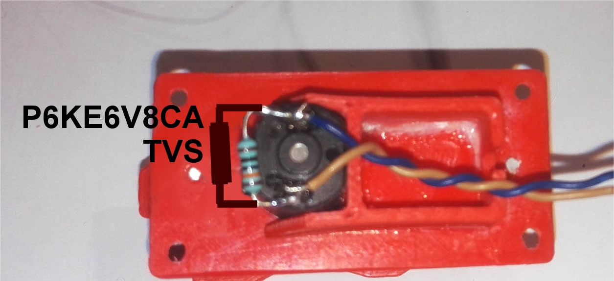

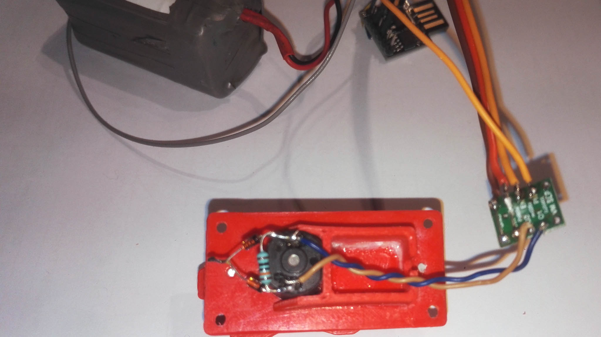

A quick note in this matter, after testing done by others and myself on the bench and in flight we have found out that some of the side equipment we use eg. ESC and Rx reacts differently to transient currents from the motor ending for some, in short glitches/momentarily freezing of the actuator. An other issue here is also the load posed on the actuator like linkage and hinges which can cause the same symptoms.
It has to be noticed once more that not all users are affected by this issues and that the chosen side equipment as the proper installation is outside my control.
...but wise of feedback, testing and experimenting I would recommend to add to the motor a "filter" eg. a 200R 1w resistor across the motor terminals in conjunction with 2 Zenner Diodes 5,6 V back-to-back, see picture (Courtesy of Mike K). This will be standard from now on all GG-Tobe and I would recommended this add on also for those of you running the DIY DigiSpark recoders.
If you are not sure concerning your side equipment impact I would recommend the usage of a separate battery running the actuator as suggested by Phil and I will be happy to add proper connectors to GG-Tobe accordingly on demand.

3 to 5 w should do fine, in my tests I used what I had home and that was 1w.
I have hope to replace the 2 diodes back to back with a Bidirectional TSV Diode but haven't received them yet and need some more testing

Thanks for taking this up Mike, looking forward to your "10% off" code
For existing recoders, I've some 6.8v TVS diodes on order which have a similar effect to two opposed zeners: https://www.ebay.co.uk/itm/10x-P6KE6V8C ... 2670026775
These were the lowest voltage TVS I could find at 6.8v but ideally 'just above supply voltage' would be best, with the low-value resistor in parallel across the brushes:
Incidentally, has anyone tried a simple decoupling capacitor across the receiver power rails (like the famous Spektrum "capacitor-on-a-plug"), say at least a few hundred μF ? (I think the Spekky ones are 4700μF)
