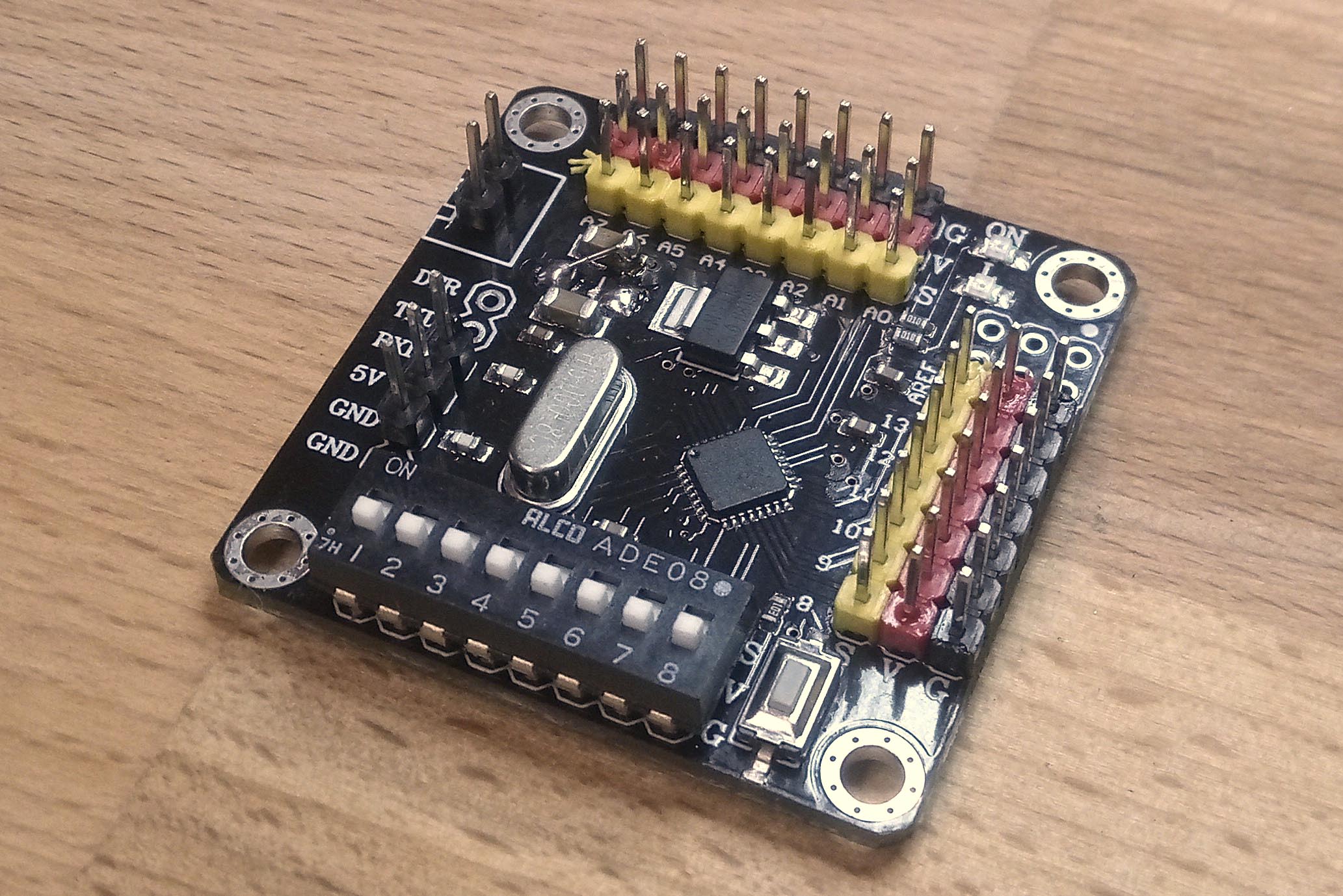

I also bought some similar headers to what you bought from eBay and while they shorted all three pins together, they didn't fall to pieces. My solution to shorting all three pins out - don't fit the centre positive pin.
But what I've been using for my last few projects (not your transmitter) with the DIY-More boards has been to fit DIP switches. Now I know they are on a 0.3" (7.62mm) pitch and the 0V and inputs on the Arduino are on a 0.2" (5.08mm) pitch, but the legs can be easily "teased" inwards into position with pin nosed pliers. I don't know what inputs you've got your header connected to as I haven't looked at your code, but I would imagine they could be reconfigured if necessary. Ideally, the DIP switch is fitted at the end of the row of I/O (4 to 7 in my case) as they overhang a little at each end. In the photo, you can see digital 3 becomes a little tight to use. In my opinion, a DIP switch is a lot more convienient than headers and about the same cost.
https://uk.farnell.com/multicomp/mcnds- ... dp/2910894

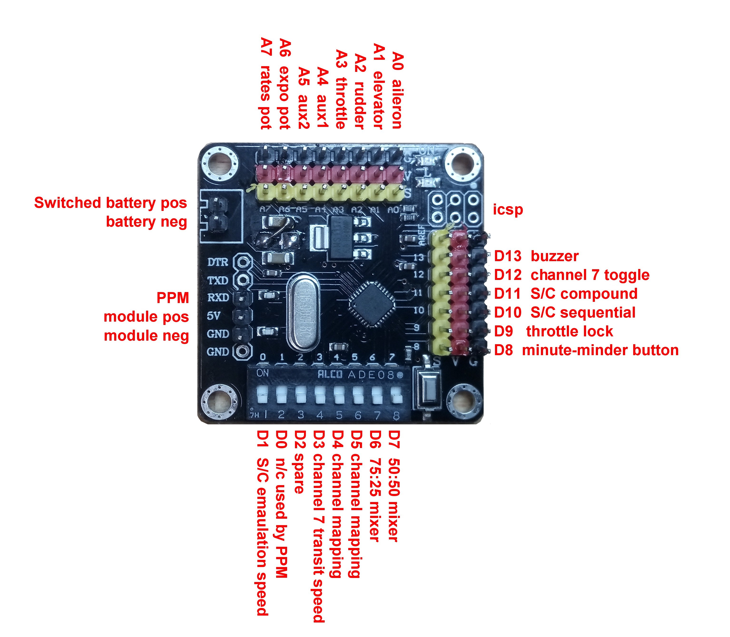

Always open to suggestions, I've swapped a couple of pins to accommodate a high quality miniature 8-way dip switch for the option settings, instead of links. The swap is D6 with D8, so the minute-minder button is now on D8 and the 75:25 mixer is now on D6, which means both mixers are now on the dipswitch:
Dipswitch position 1 - D1 S/C emulation speed (Remember DIYMore board has D0 and D1 reversed)
Dipswitch position 2 - D0 is PPM out so this switch isnt connected
Dipswitch position 3 - D2 spare switched option
Dipswitch position 4 - D3 channel 7 speed
Dipswitch position 5 - D4 channel mapping
Dipswitch position 6 - D5 channel mapping
Dipswitch position 7 - D6 75:25 mixer
Dipswitch position 8 - D7 50:50 mixer
Its unfortunate that the pins are D0 to D7 but the switch is labelled 1 to 8, in the doc I'll use switch numbers.
The wired connections are the same as before other than D8:
D8 minute-minder button (was D6)
D9 throttle lock
D10 S/C sequential
D11 S/C compound
D12 Channel 7 toggle
D13 buzzer
Analogue inputs are unchanged. If rates and/or expo are unwanted, A6/A7 will need a link as before.
A0 Aileron
A1 Elevator
A2 Rudder
A3 Throttle
A4 Aux1
A5 Aux2
A6 Expo
A7 Rates
Bear in mind the dipswitch is optional, you can choose headers or a dipswitch, the code is the same.
The 'dipswitch or headers' version of the code is appended to post #1, the only difference from the former version is the D6/D8 swap, consequently this rearrangement is fine whether you prefer the dipswitch or header, and any ready-made encoders I supply now will use the 'swapped' code, and ultimately I'll phase the old doc & sketch out, two versions of the same thing is confusing.

Hi Phil
Have you found a 0.2" pitch DIP switch (to fit directly between 0V and the signal) or are you using a 0.3" pitch switch and "teasing" the legs into the PCB?
Cheers Mike
Re: 7ch Propo + S/C mix encoder update/rewrite
Hi Mike, I did have some 5.08mm switches years ago but no one seems to sell them now, at least I couldnt find any, so these are the usual 7.6mm but since they're low profile the legs tuck under nicely ;)
I would like to find some numbered 0-7 but I've not looked far, numbering isnt a search option on RS :D
Otherwise its bound to cause confusion as we have 3 descriptions for that row of connections:
01234567 = silkscreen (which is wrong)
10234567 = actual
12345678 = dipswitch
Fun & games will ensue I'm sure. One option would be a printed 0-7 sticker over the dipswitch labelling but it creates more faff when I'm trying to reduce it! ;)
