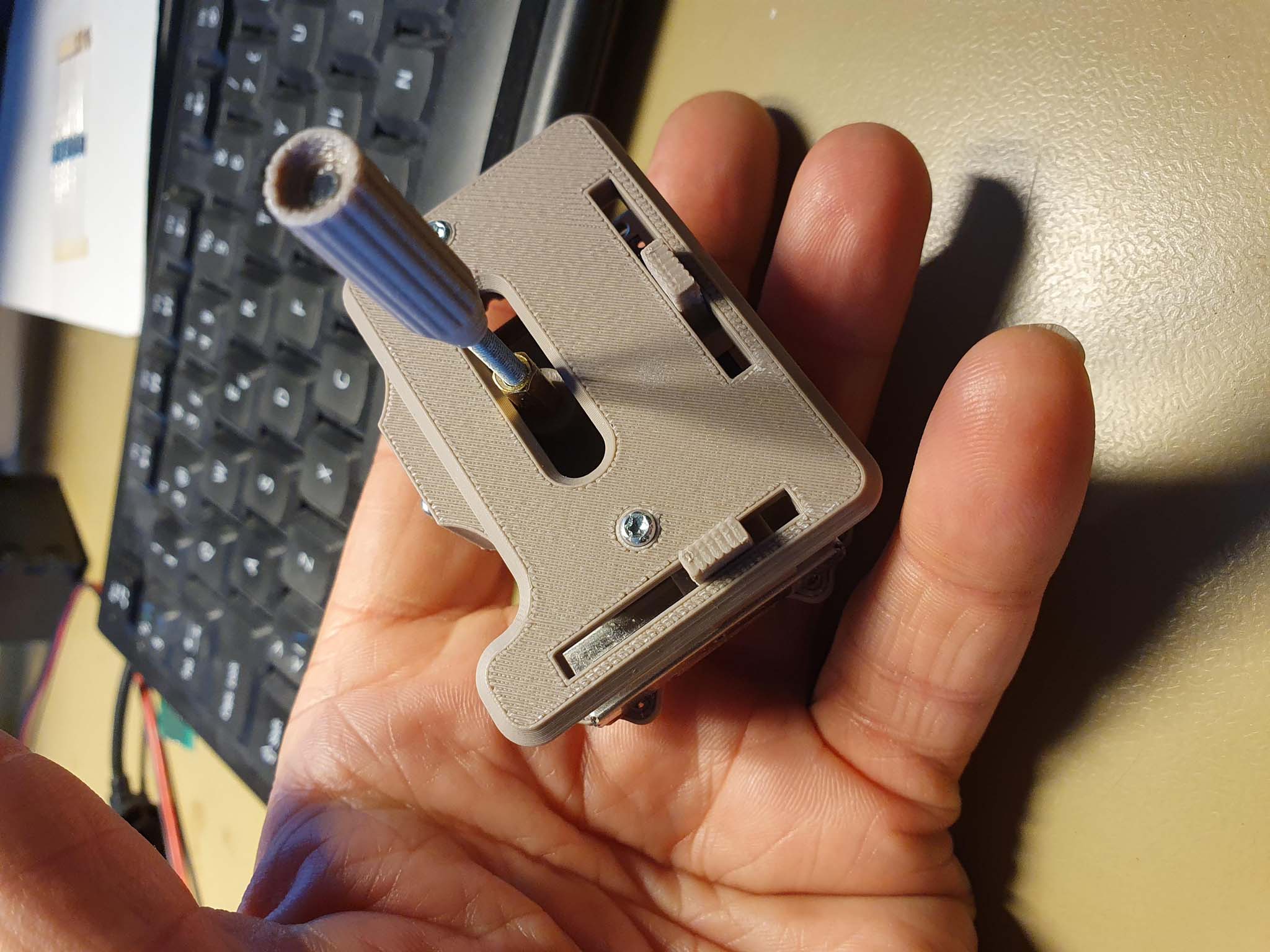

The 3rd slider is an option and available for whatever one like to have there. In this particular set up it's intended to control the rate in my dual pack GG Tx as throttle is sequential via 2 push buttons.
Files for the stick are available to whomever likes to give it a shot, just ask and you will get! The stick is drawn In Solidworks but I can easy convert into parasolid, step and .stl

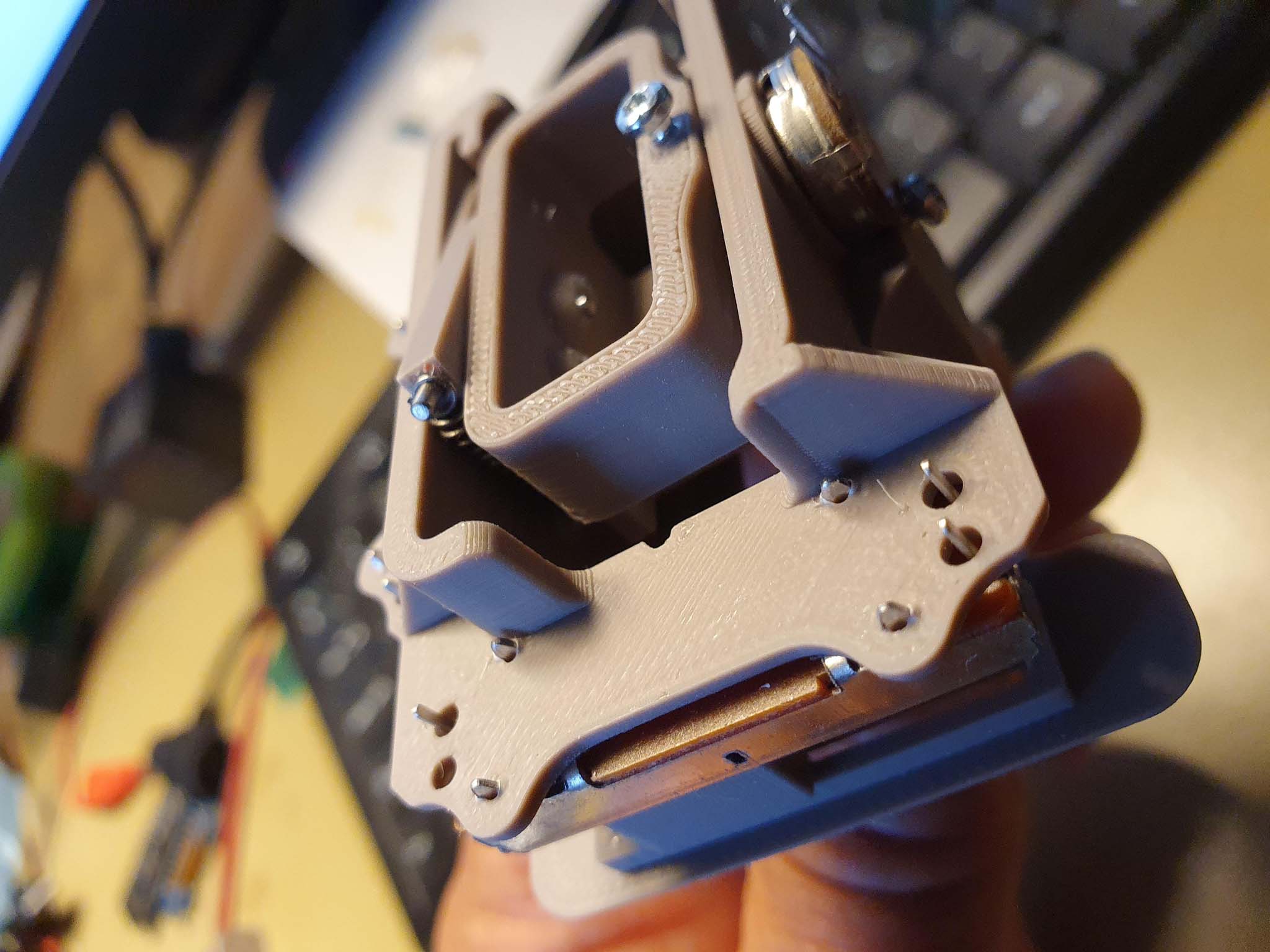

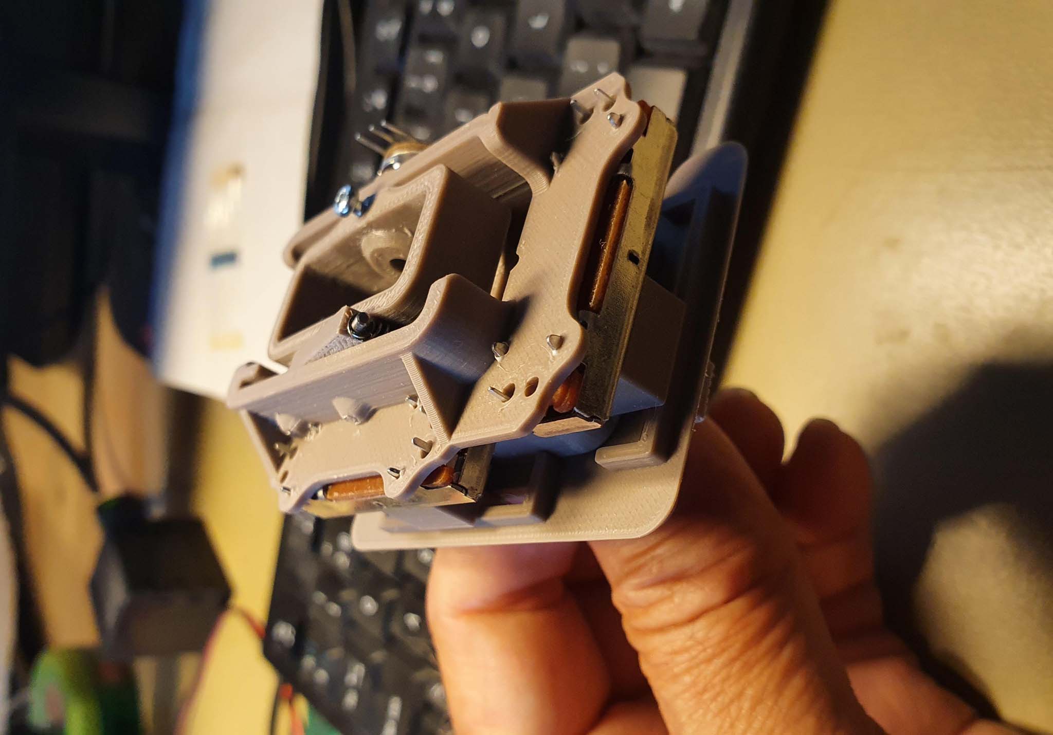

The upcoming 1+1 GG will have a customized stick, regular rudder with trim with the addition of a trim slider on the side for throttle which in this days is essential as we are flying mostly electric...motor will not stop as a glow when "hitting" ground prematurely. I have flown with timers but don't feel confident with it.

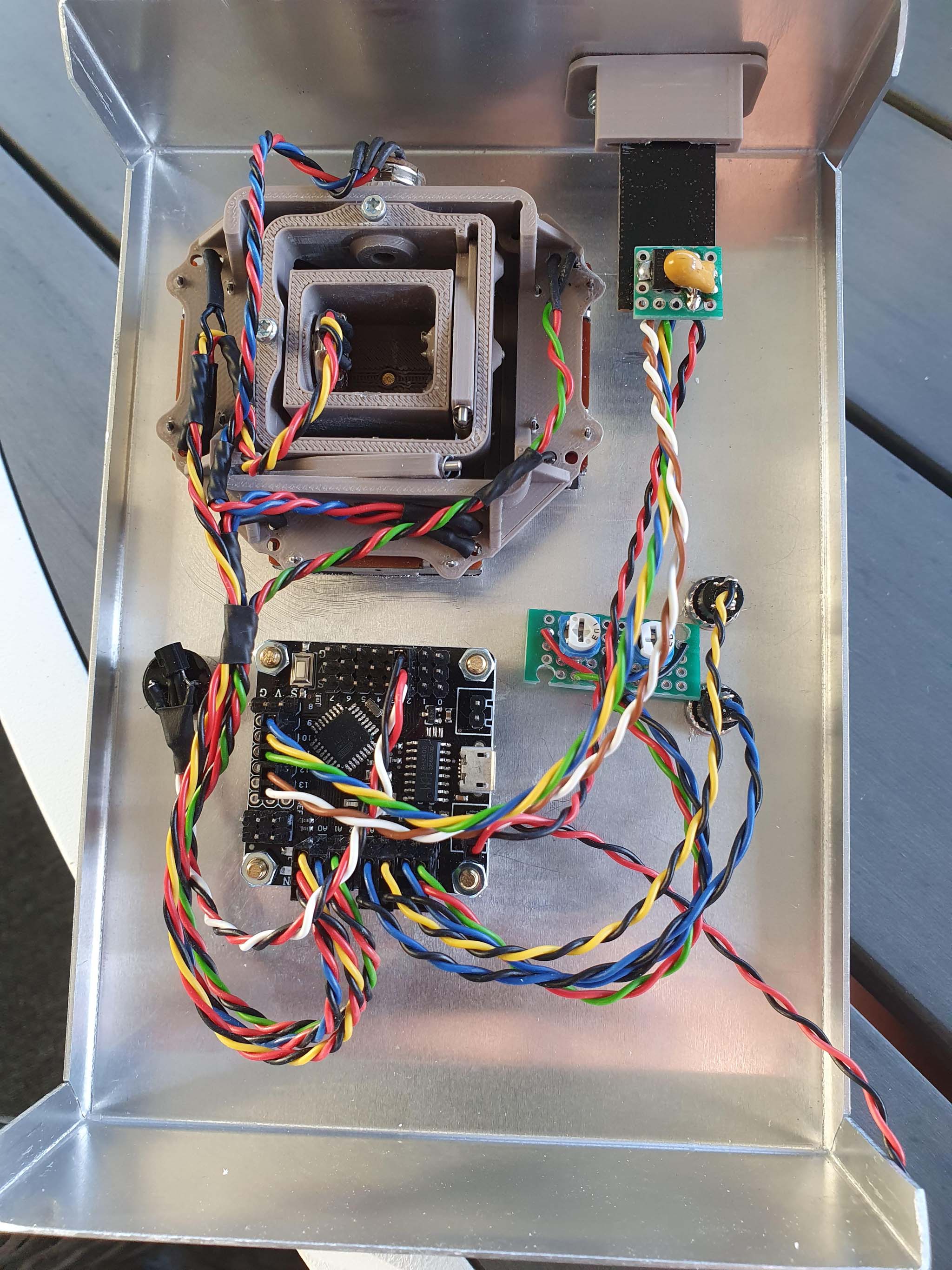

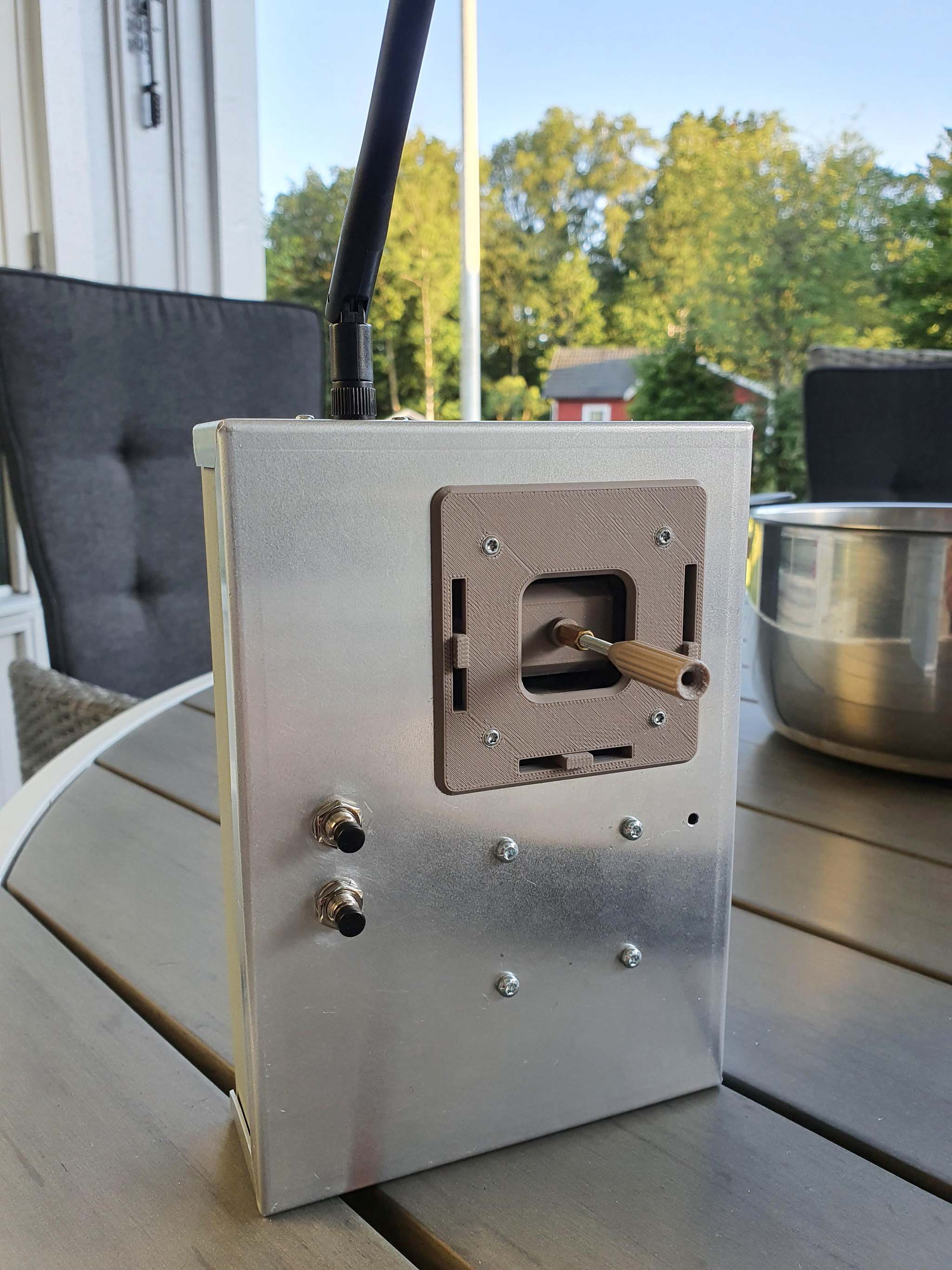

Just awaiting for proper aluminum sheets so I can cut and bend a suitable case. My intention is to minimize the size of this transmitter that's the reason I'm not using my regular ones which I have already made and is the same I have for my 3+1 GG transmitter.
This transmitter is quite shallow with its depth of 40 mm
