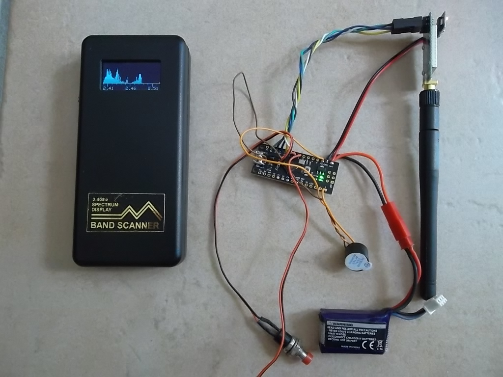

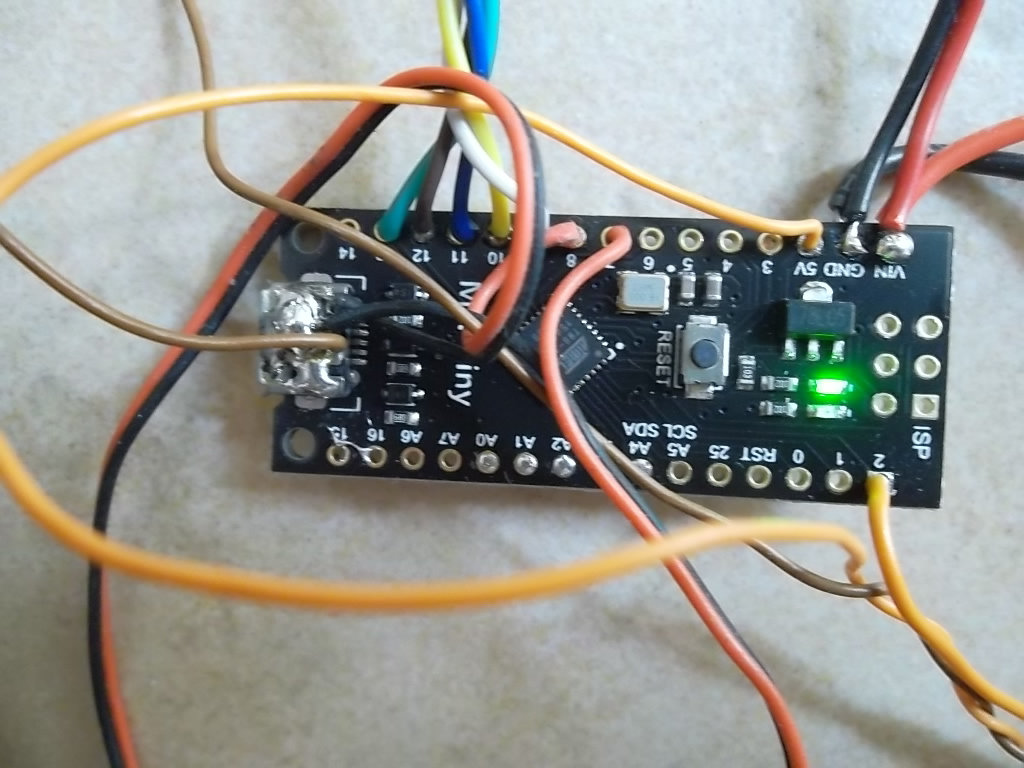

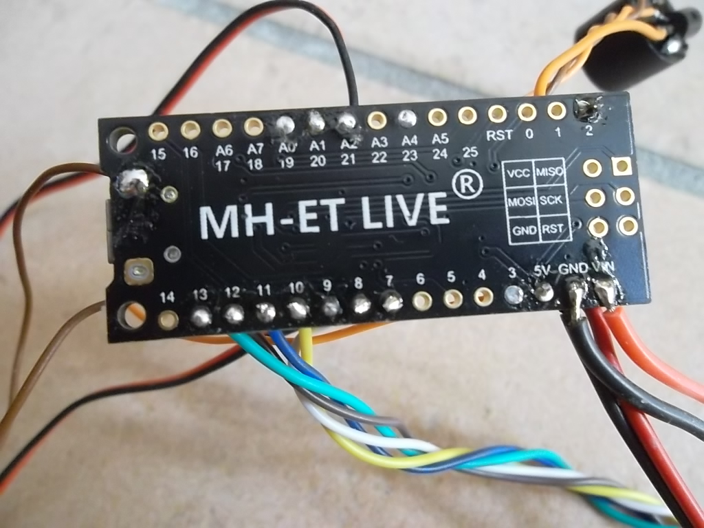

Hi guys,
Since the prices for nanos, pro minis, digisparks etc. went up a lot, I was searching for something cheaper. What I found by surprise was the Attiny88 board, which is available for less than €2,00 each and it was looking interested.
I wired up a S/C transmitter as I use in several of my projects and it was working without any problems.
Then I wired up a simple proportional transmitter, but no joy. Something with the eeprom part and the analog part is not working, but that is still above my hat and needs further investigation.
Then I wired up a S/C NRF24 transmitter as I use in two of my other projects ( O.S. and Futaba S/C replicas), and again it is working without any trouble. I could stear my Pageboy around without any difficulties. I hope not to bore you with my thoughts and my experiments.

- Posts: 406
Thanks guys,
no changes to my codes needed. But the codes provided my Phil are to big for the Tiny88.
I am using much simplified codes on basis of Phil´s code, I removed everything, I do not need.
Programming is done via USBAsp.
In the Arduino IDE under File/Preferences/Additional Boards Manager URL´s, you have to enter the line:
After that you have to go to Sketch/Include Library/Manage Libraries and search for „MH-ET LIVE Boards“ and activate it.
Then you find the MH-ET LIVE Tiny 88(16.0MHz) and can use it.
I had no troubles in loading the codes.
Code: Select all
https://raw.githubusercontent.com/MHEtLive/arduino-boards-index/master/package_mhetlive_index.json
