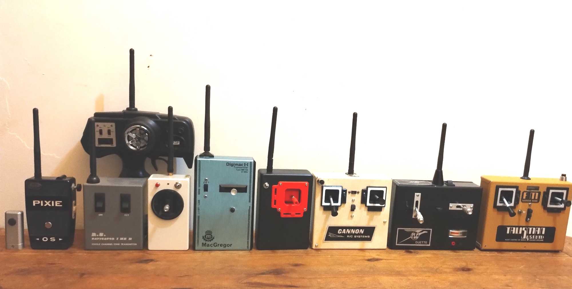

I've never done a 'family photo' as my sets are all different with no common 'theme', but this is my NRF line-up, all of these are in regular use apart from the Cannon which hasnt flown yet - hopefully soon - all converted to 2.4g at minimal cost based on this project ;)
Any of these can be used with any of my models without any binding, changing or selecting anything on the transmitter, all the configuration differences being stored in the individual receivers. There are a few bench-test sets too but I dont count them as 'flyers' :D
Left to right:
Micro 2ch propo, OS Pixie S/C, RS Navigator S/C, Car tx behind, homebrew pocket 2ch, Digimac 1+1, 2ch Tobestick, Cannon, Flight-link Duette, and the World-Engines Talisman:
