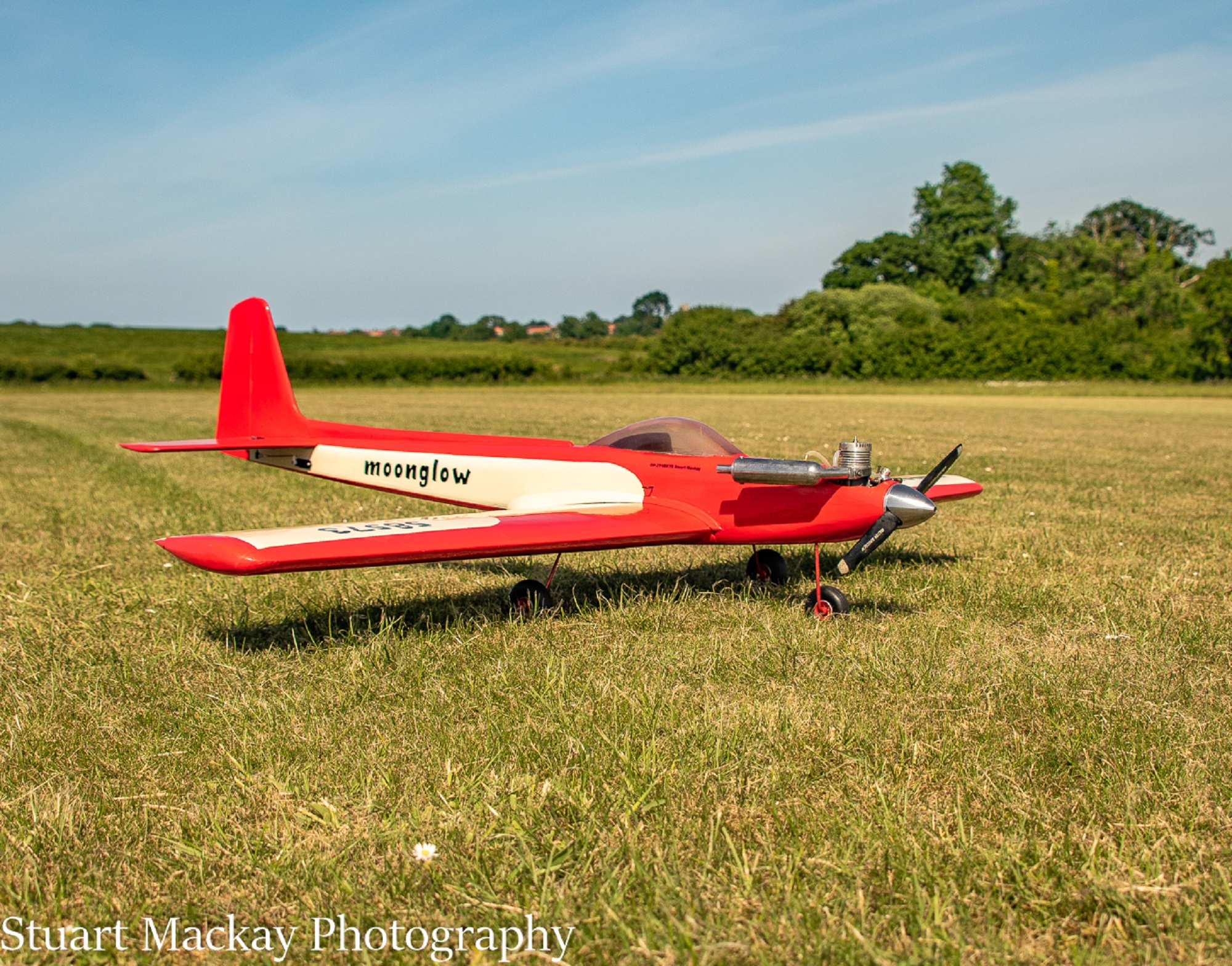

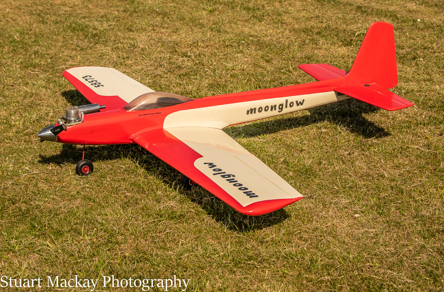

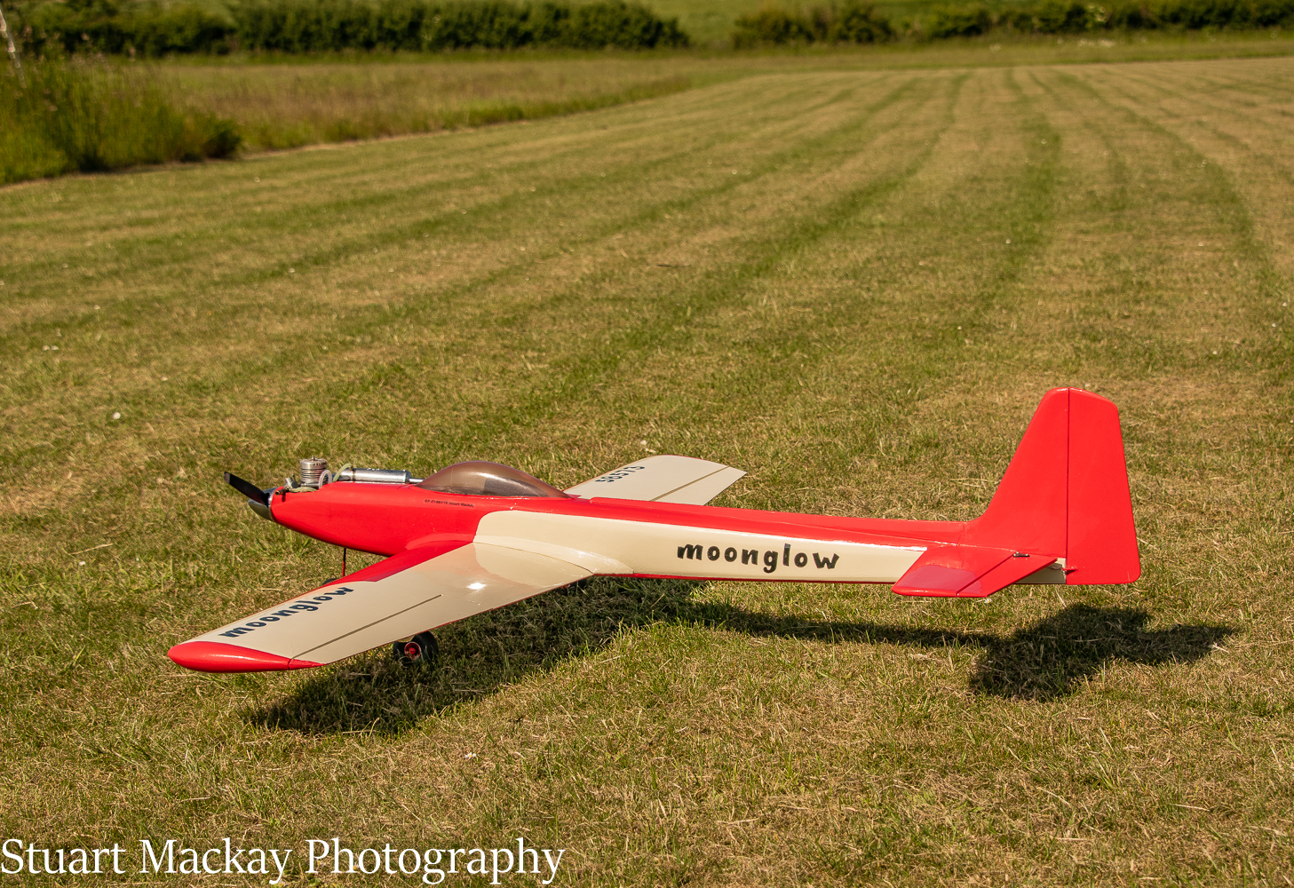

Finally got the chance to get some air under the wings of the Moonglow at Norfolk's finest flying site at Binham.
one click of down trim and 10% with rudder aileron mix for sustained knife-edge.
Very pleased with it and the Merco 61 was pulling over 11k on a Master 12/6, plenty for effortless verticals and continuous large diamater loops
