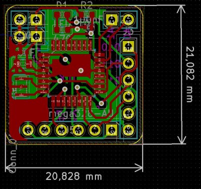

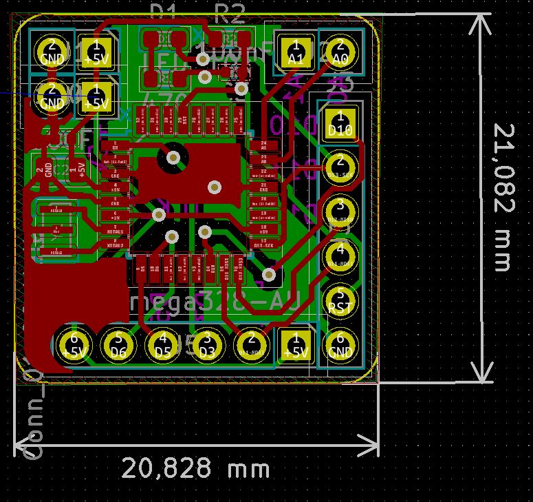

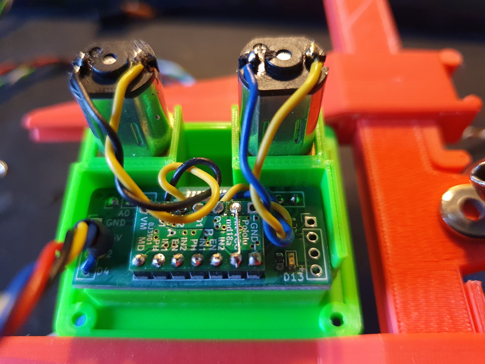

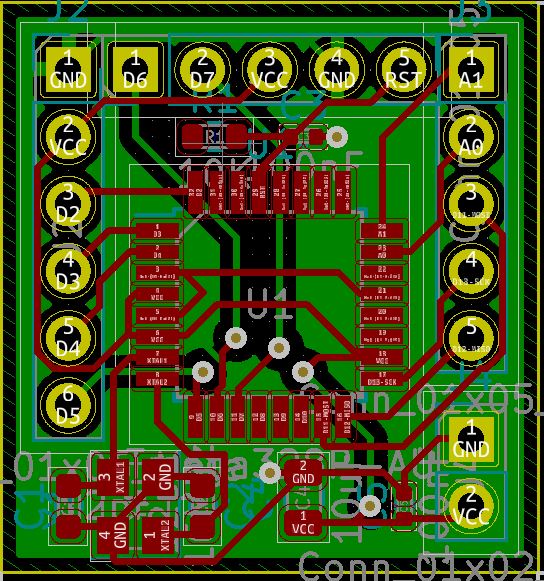

I'm born inquisitive not afraid to stretch that bow so as in my first attempt with KiCad to design a new carrier for the ATTiny85 in my GG-Recoder it just happen that I made a poor attempt to make a 328P board in view to make a full custom amplifier for the DIY-ProPo and as JLCPCB have coupons which make things quite cheap, I added few boards for the this 328P... ..and here is the updated layout
The funny thing is that the board with all its poor design works but I realized now that KiCad has a bug, if you add and remove filled zones it might happen that you loose a ground connection that will not come up again so there were some trouble shooting initially but with a help of a little patch they were in business.
I have tested the 328P both in a GG set up and as ground for the servo amplifier with both internal as external resonator and it works.

Well done Tobe, I knew you could do it. The grounds becoming "detached" isn't really a bug in KiCAD, if you run the design rule checker (the Ladybird or "bug" icon) and choose "List Unconnected" it will show up the grounds that have become disconnected. The usual fix is to use a ground via if using a 4 or 6 layer board, a two layer board takes more effort and may require a redesign.

I realize it will only do it if you open in the Project! One more lesson learned! ...Rome was not built in one day.

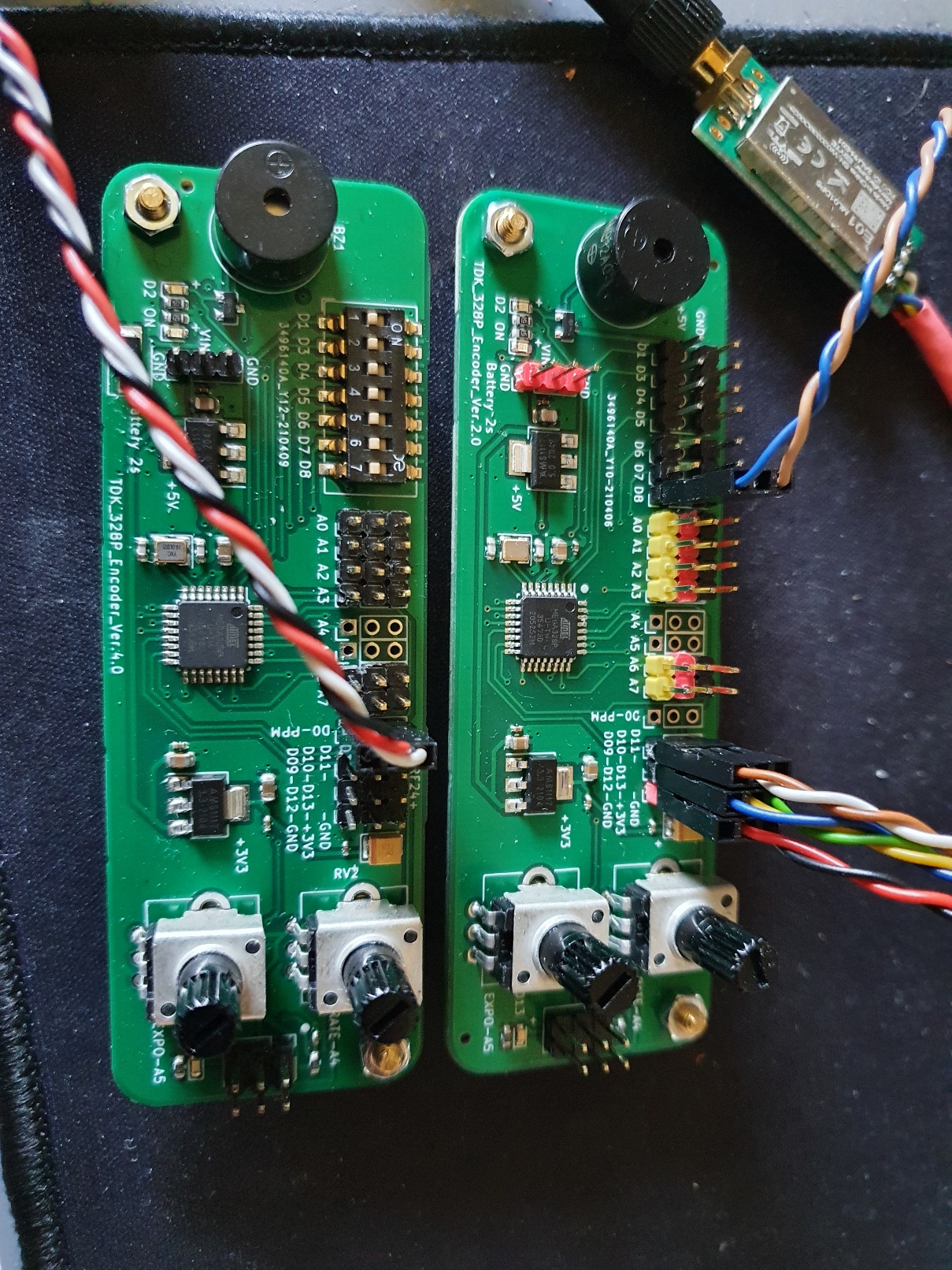

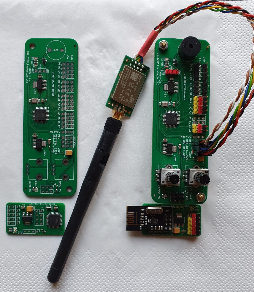

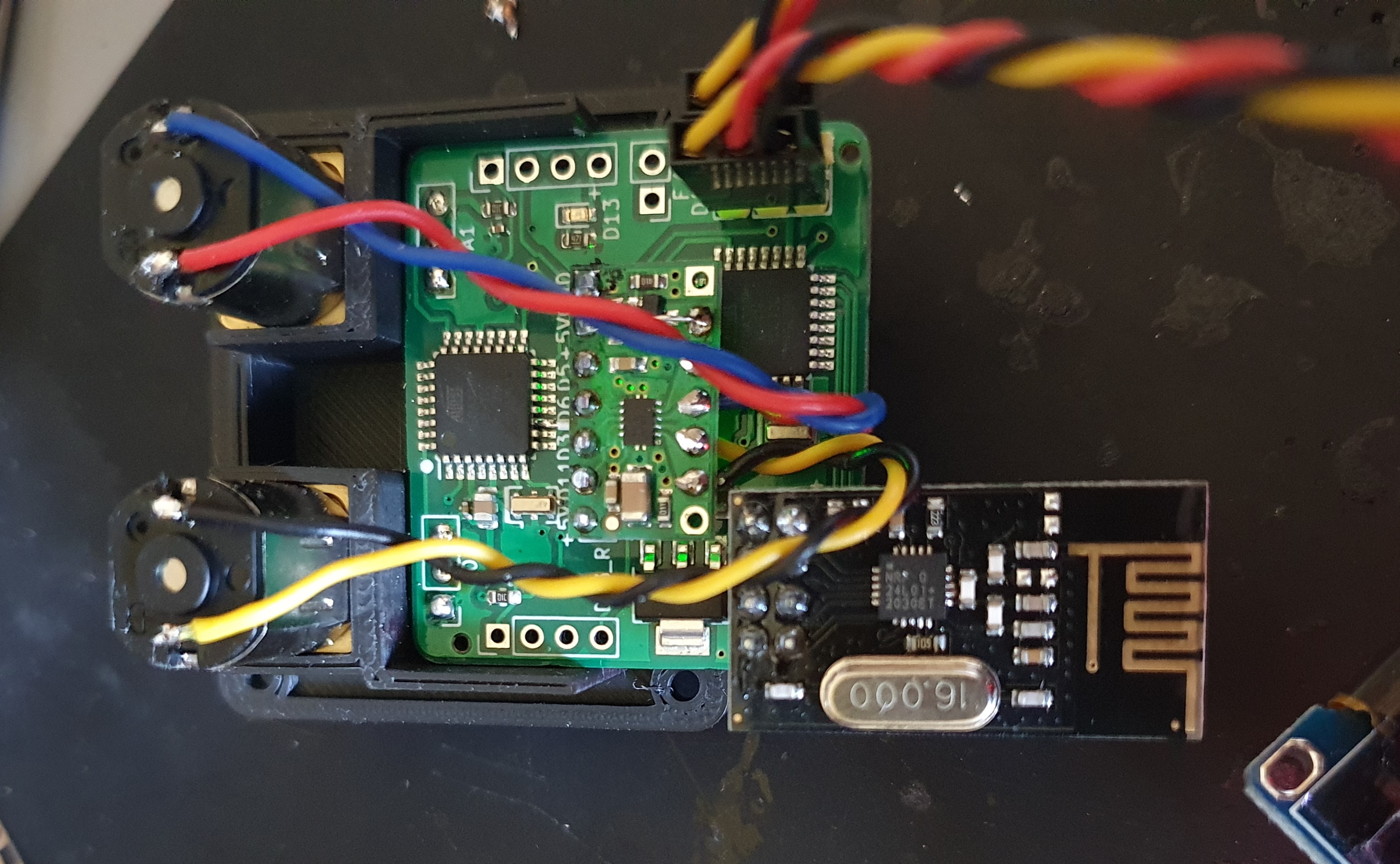

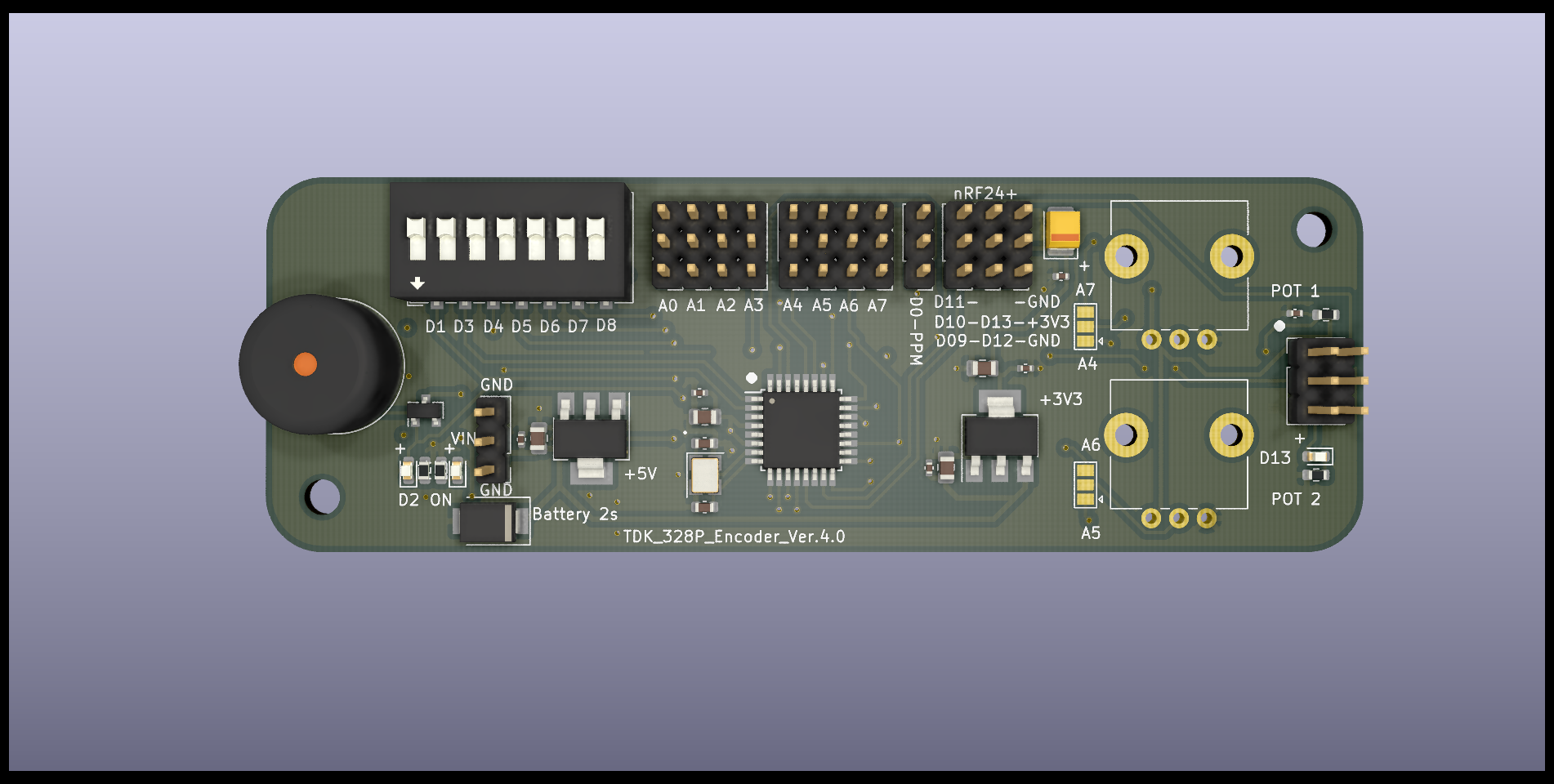

Just a quick note to show where the project is for the time being. There is also a still ongoing version for a Brick with Rx...and yes, it's up and running. The Rx uses Phil's NRF24 accomplishments. ...and to this there's is now a matching Tx encoder, the encoder will work with several options both from Phil and Mike. The pots on the board can be set A4&A5 or A6&A7 by just bridging different pads and better seen here:

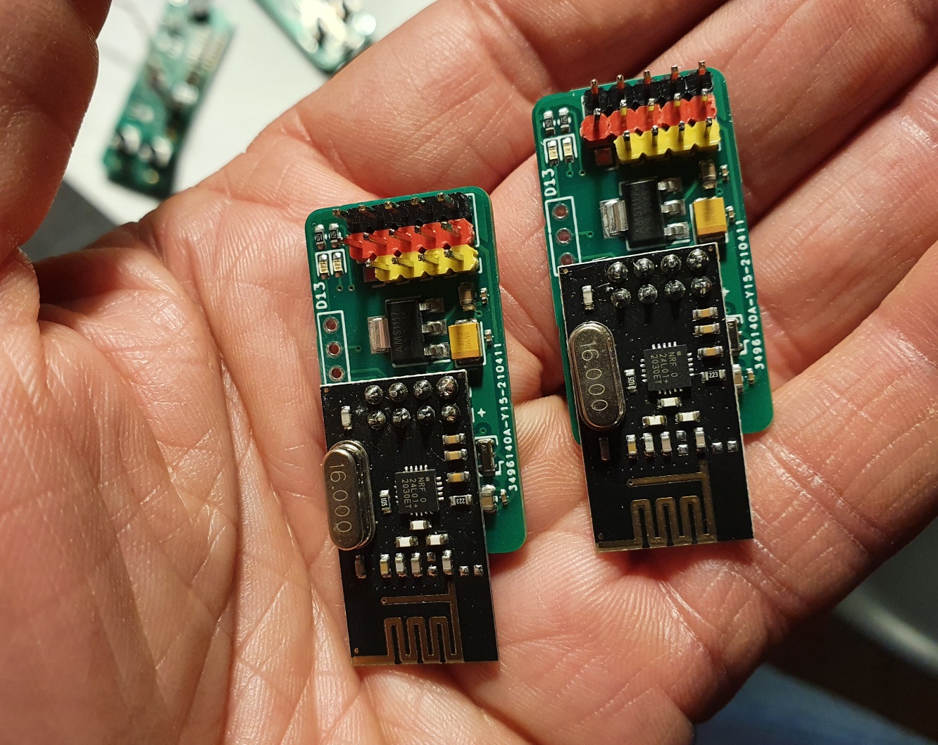

..and here is "my version of a Rx" running Phil's nRF24 code awaiting a suitable casing.
Re: The ProPo project, a DIY proportional servo
I like it - well done sir!Tobe wrote: 19 Apr 2021, 21:24 ..and here is "my version of a Rx" running Phil's nRF24 code awaiting a suitable casing.

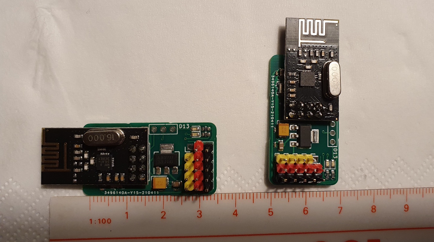

Just a quick update...

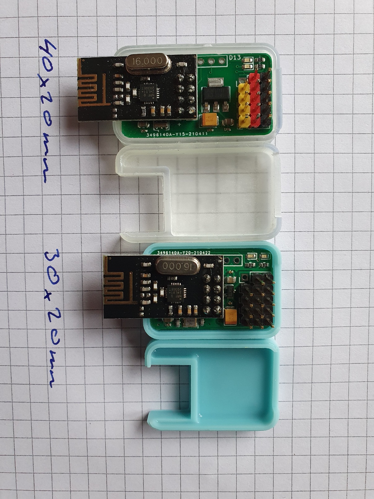

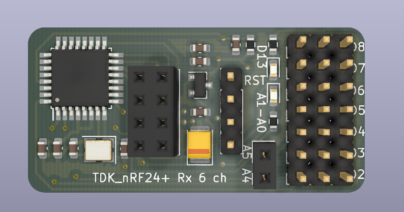

Here is the final version of the nRF24 Rx running Phil G's code, it's flown and I love it: They will soon be available. My larger prototype is at the side of the final version and should fit in most models but for whom that want more there is a 6 channels in the pipeline with matching Tx.
