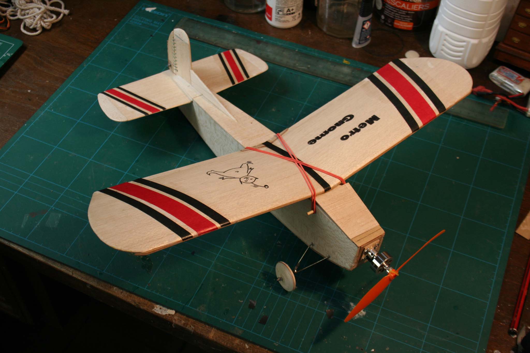

In common with most of Europe, in S-W France we have been sizzling in a heat wave all week - not as bad as Spain but still afternoon temperatures up in the mid to high thirties which, as far as I am concerned, precludes any activity except cowering in the house with shutters closed and fans on. The last couple of hours before dark are better, but by that time I am too fagged out by the heat to raise the energy to go flying. So I tried a different approach this (Sunday) morning and was on the 10 minute drive up to the field in Vayres (https://www.ma-db.com/airfield/10173) by 7 a.m as the sun rose, with a boot full of rudder only and lightweight RET models. It was still blessedly cool, welcome after trying to get to sleep at midnight in 25 degrees, and glassy calm. Enjoyed a couple of flights each with the Metro Gnome
and Frog Witch using the Macgregor S/C Tx

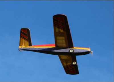

A lengthy soaring flight with
the Tarquin

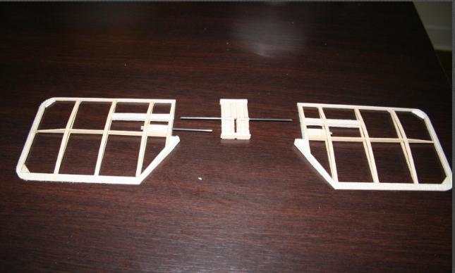

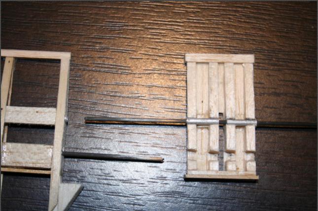

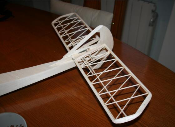

Sundancer wrote: 05 Aug 2018, 11:45 I also had the Rubberdub with me
But it wasn't flown as in a senior moment I had left the all moving tailplane halves in the workshop!
Any chance of seeing the all moving tailplane on the Rubberdub? Heard about them so it would be interesting see this one.
Carl
STILL LEARNING
Sundancer
Posts: 122
Joined: 07 Jun 2018, 09:28
Location: Limousin, France
Re: Went Flying Today
Post by Sundancer »

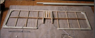

I'll do my best Carl, via some photos.
First stage of building:
Second stage:
Halves separated:
And joiners inserted:
Note that the centre section is cut away at the rear actuating rod position to allow movement AFTER it has been assembled to the fuselage. The actuating crank is custom cut from 1/16" GF board. Finished assembly on fuselage:
Showing up and down movement - note MUCH less than this is used in practice:
Finished job:
Hope you can make all that out! If not clear, say so and I will try a written explanation!

That's great a good example of how pictures can explain something really well. Thanks Sundancer. A really neat way to add elevator on a model with a built up tailpalne.
Just one question - are the two halves held in position by friction?

Yes Carl, I just bend the wires VERY slightly so that you have to spring them to fit the tail, the friction is then quite sufficient to stop the tail halves moving. Here is the same sort of set-up on my electrified Lulu II soarer, in this case the tailplane had to be raised slightly from the F/F version.
