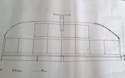

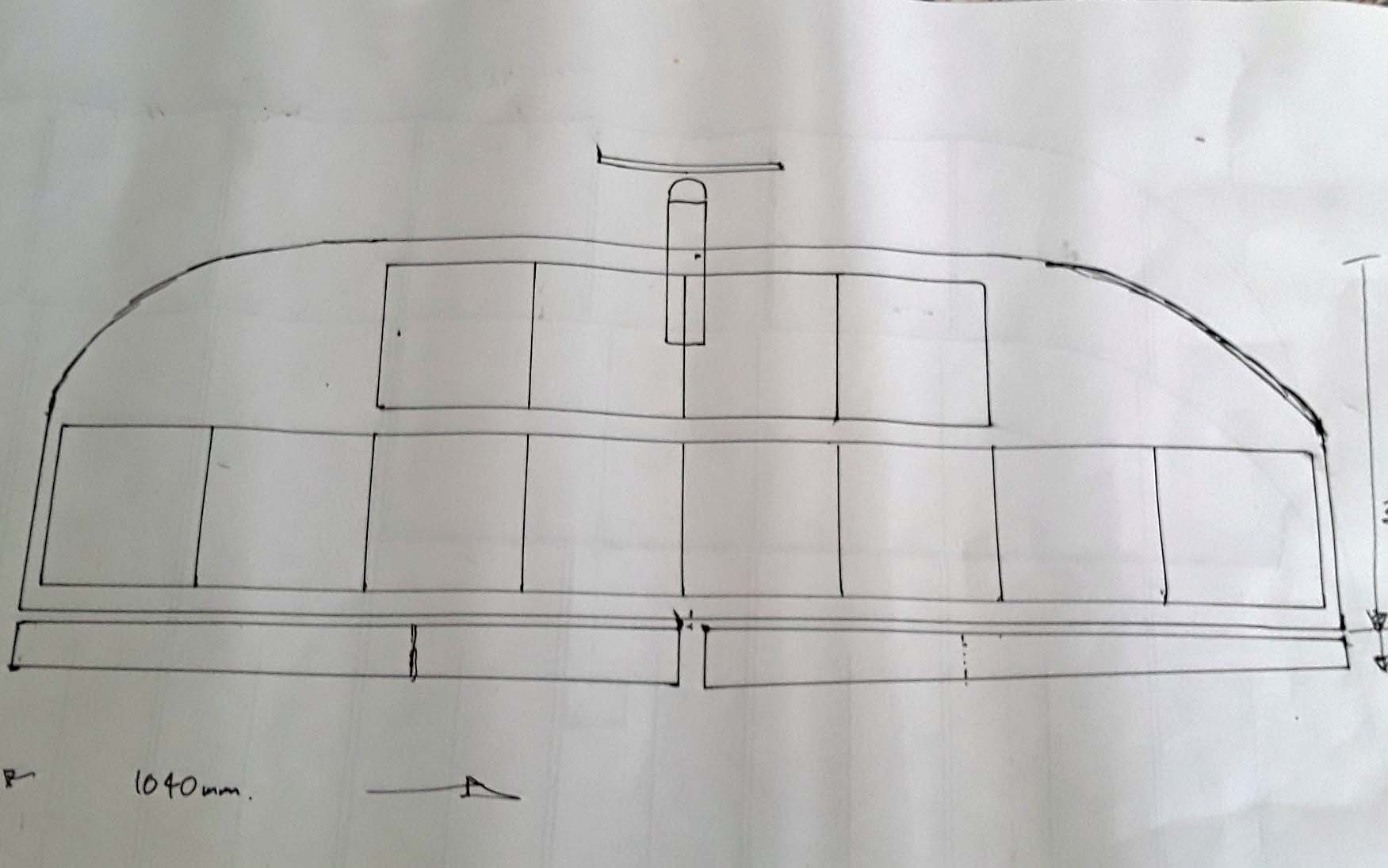

The cells are 125mm, so 8 give 1000mm, and then needs to be about 300mm at the middle with 160mm tip. I probably will do a straight front by the 4 cells with a curved LE to the tip. I may have full length elevons or just have them on the outer 50%. The wing needs to be 1040mm to accommodate the cells and some spacing.
I would have tip fins underneath again for a shadow free upper surface. I am trying to use a folding prop on the 12c wing but this would need a normal power prop.

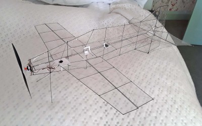

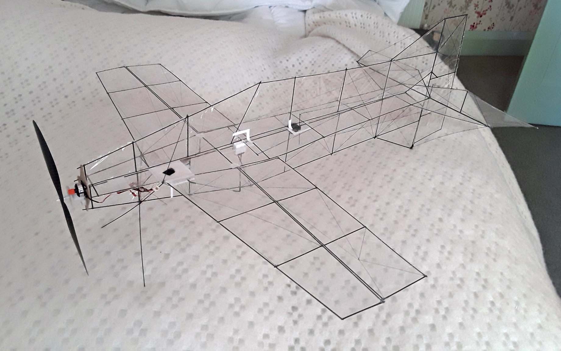

Carbon, like this?
Carbon, Mylar, RCModellers glue/Cyrano.

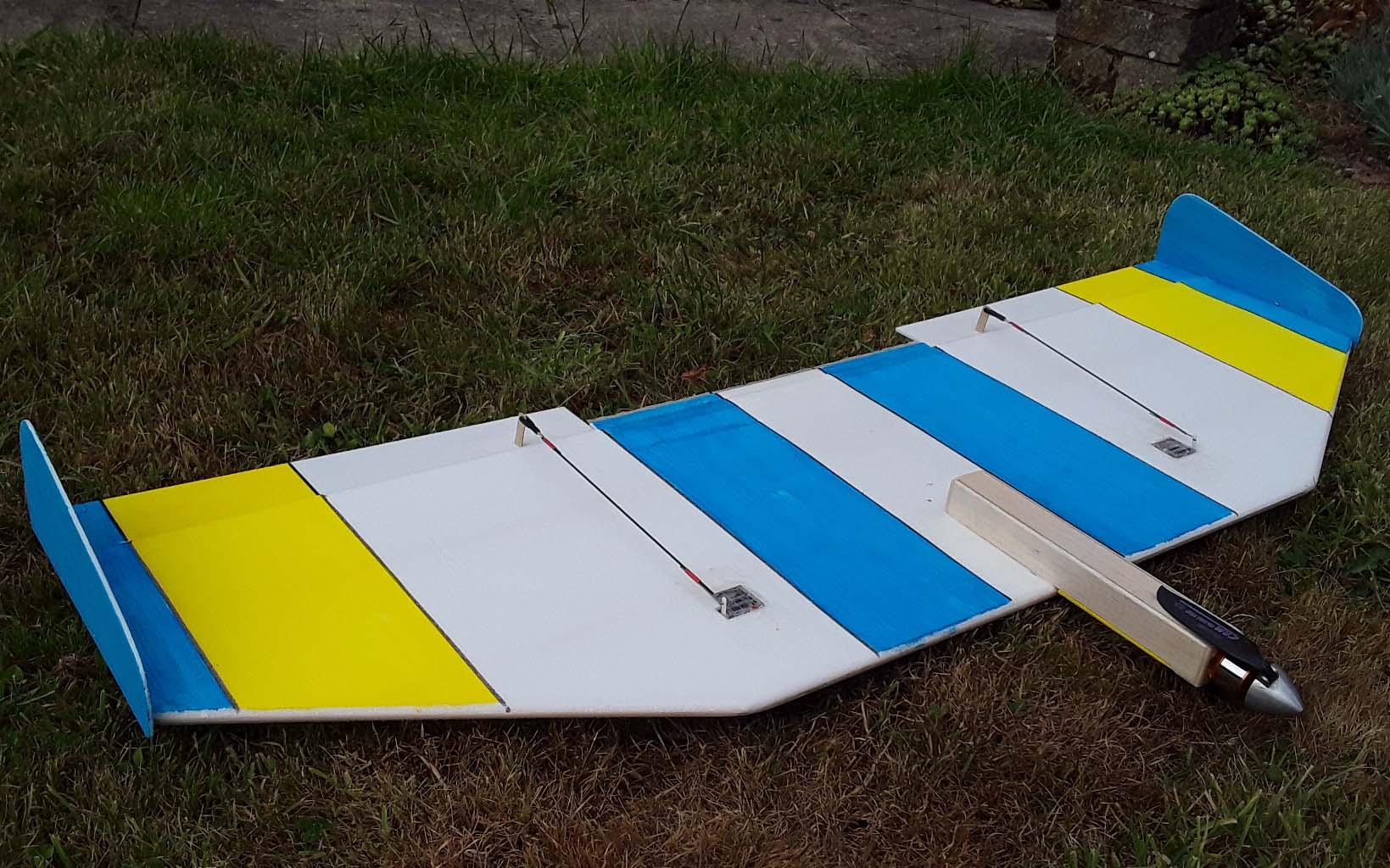

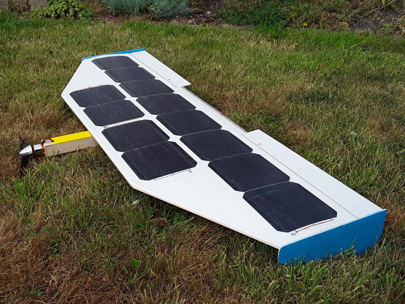

I have been putting together a semi delta 12 cell model, finished today, weighing in at 344g, with possibly another 20g weight loss if i change the motor / prop. I am starting off with a 2212 1450kv and a folding prop to give forwrd cog, but can move to lighter items if the cog can go backwards.
It was quite cloudy this afternoon when ready but on 9W of power it was able to maintain height, so should be good when up to 28W.

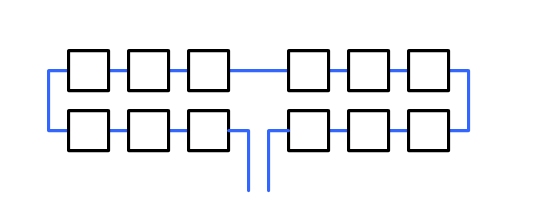

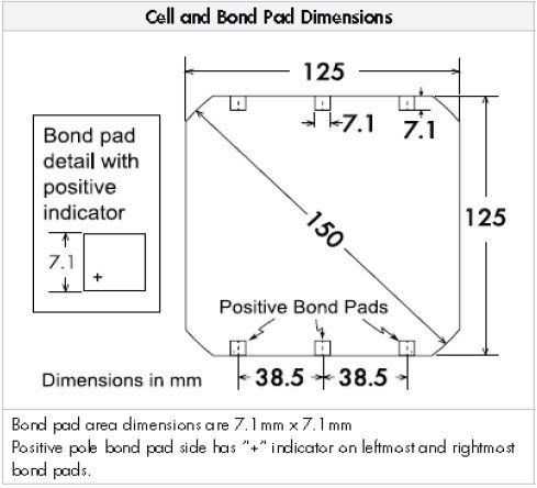

Re: Solar-powered model planes
Is each panel actually 3 cells in one that are paralelled by a common connection down each edge?
And the plain blue side is the active side? Do they solder easily?
The plan is to go for a simple KFM wing, so all the cell mounts are perfectly flat, span & chord dictated by 12 cells, and avoiding return wires by using two rows on each wing:
What do you think?
Edit: found this:
What do you think?
As they come the three + connections are internally joined on each cell, as are the three - connections: but you're supposed to use all three as the internal connecting 'tracks' are pretty thin and not really suited to handling the four amps plus that the cells can deliver. The idea is that the current is shared across the three connectors to provide lower resistance and some redundancy.

While having 2x6 has shorter cabling, I think that the 12x1 has better aerodynamics, glider wings are high aspect ratio not low aspect. Which is why I moved to a 8x4 to avoid the very low aspect ratio wing.
I flew the semi delta today on a slope which confirmed that the cog needs to go backwards, will move onto the 2208 1800kv & 6x4 prop. Perhaps move the motor mount backwards if I want to go onto the 2212 motor again.
