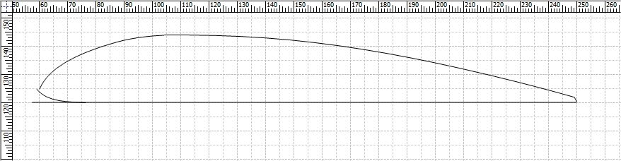

Re: Recreating the Irvine Pixie S/C or intermediate glider
Heres my latest attempt at the aerofoil, its as close as I can get it:
It does smack of Clarke's shoes rather than Clark-Y

Phil_G wrote: 22 Jul 2018, 14:40 It does smack of Clarke's shoes rather than Clark-Y
Ha ha, I think you're right there Phil, bit oddball :lol:
I've just finished checking it against what I had drawn and it's nearly dead nuts on - good enough anyway.
I've attached a v1.0 plan, if folks could download it and see if there are any misteaks and errirs needing correcting - public comments are fine, I have a tough skin :lol:
Not sure if dihedral braces are a requirement, didn't see them in any pix - maybe you could advise Phil.
Once all OK, I can start burning some balsa if that's what folks want.
Neil
