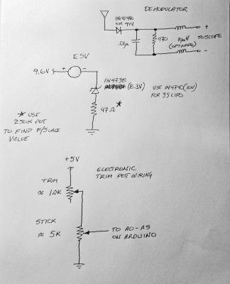

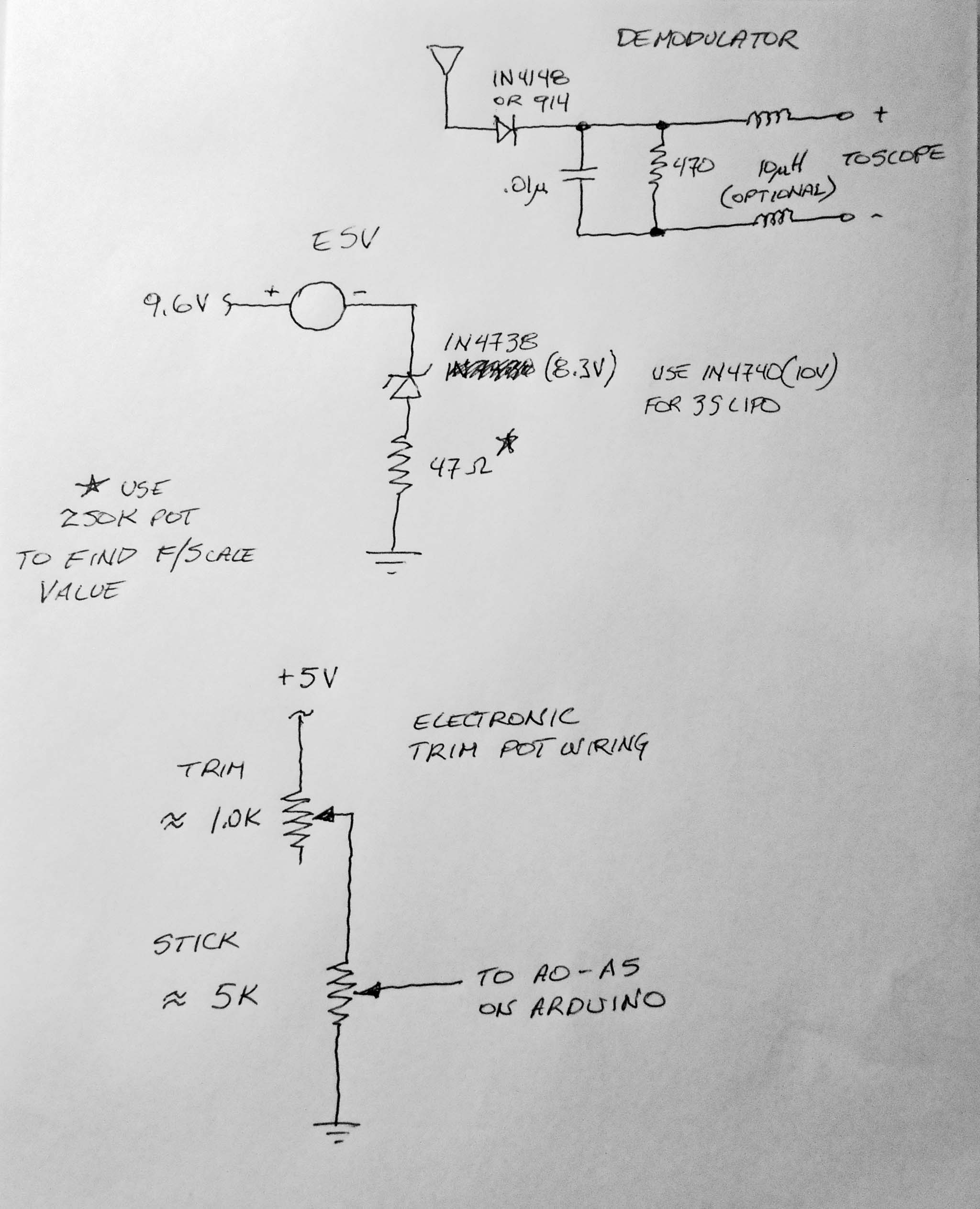

Trim pot wiring, ESV and Demod circuits
Here is a simple way to do the trim pots, especially if the radio was set up with a 3 wire stick pot. on my Proline, the trims were 1.5K, the sticks were 5.5K. As long as the trim pot value is about 20% of the stick pot value, you should have plenty of trim.
The demod circuit is for looking at AM transmitter PPM pulses, and tuning the RF stage as well.
The meter circuit is best set-up using a 100-250K pot to set the meter full scale reading with a fully charged battery. 1N4738 (8.3V) is for 9.6V, a 1N 4740 (10V) would be OK for 3SLiPo.
Jay
Jay
