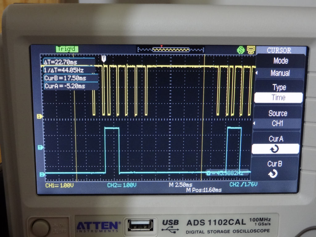

Okay, first a bug in the test program. I stupidly said use the LED pin (13), but that won't work when we're using regular SPI because pin 13 is also SCK, and used by the library for communicating with the CC2500. Change the 13 in the pinMode and digitalWrite to some unused pin, 8 maybe.
Here's a snap of what I saw once I'd fixed the library bug (see below) and swapped to pin 8. Incoming (6-channel CPPM signal from my little Orange R617XL receiver) in yellow, and the output signal from pin 8 in sky blue.
The more serious bug was in the library, and affected the library's micros() function when running on a 16MHz Arduino. Since I accidentally introduced that bug, I've been mainly testing with an 8MHz Arduino, and the bug only affected the cppm sketch so I'd not seen it.
Here's the fix. Put the three files in the attached zip into your Arduino\libraries\FrSkyV8Tx folder, overwriting the files already there (you probably don't have the .S file which is a recent addition).
Recompile your sketch and upload it again, and it should spring into life.

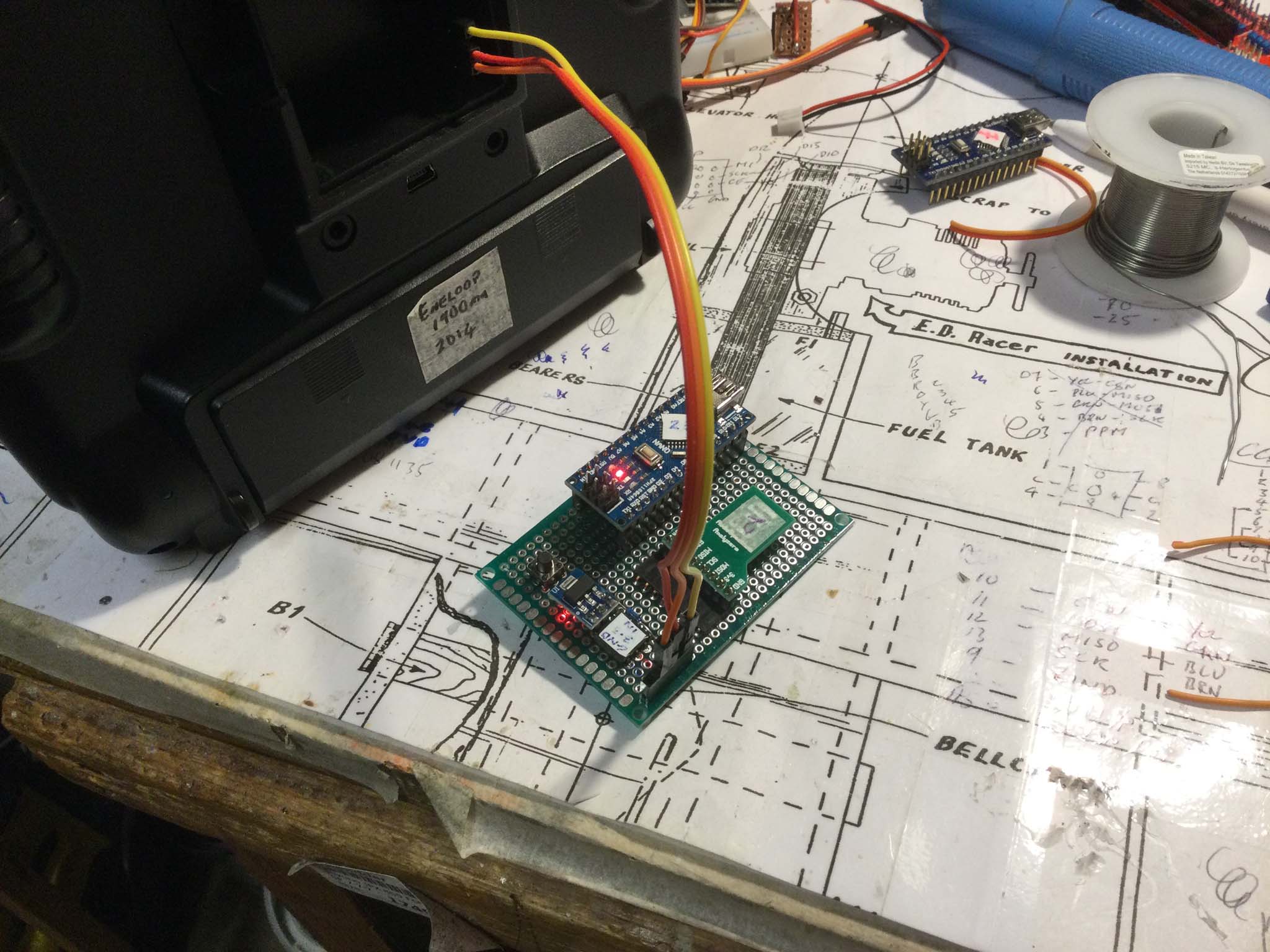

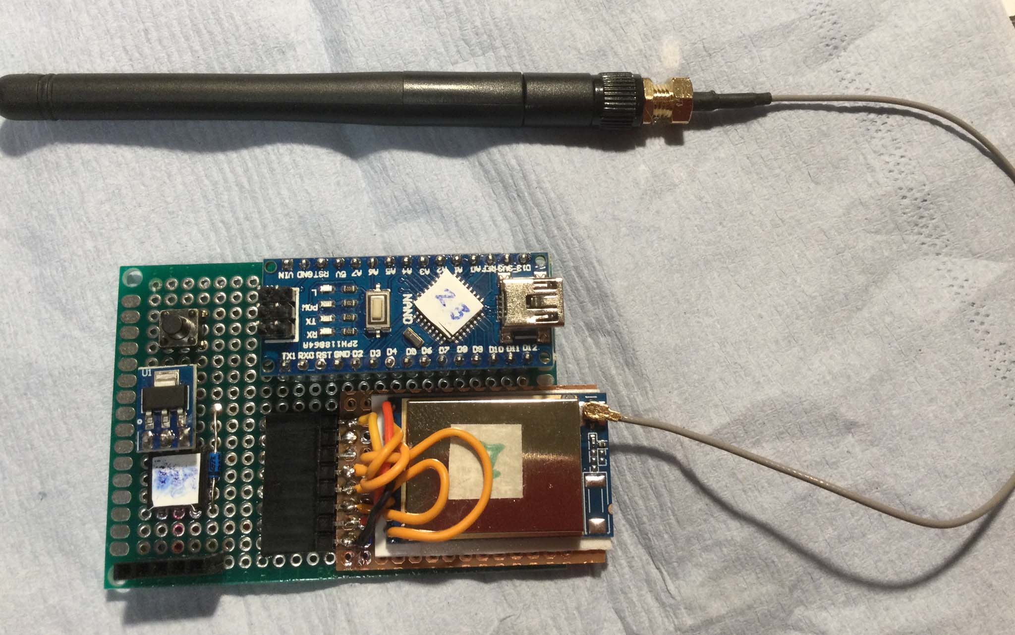

I made a version that is a bit tidier. Still a bit on the large side for a practical modification of a transmitter. But the idea of this build was to enable any of the Arduino, RF Module or 3.3v supply to be swapped. Can be a lot smaller, just a Pro mini and the CC2500 back to back.
Another option could be an Arduino based encoder with the addition of the Frsky protocol code, thus reducing to a single arduino and rf module.
Both low and LNA+PA version work very well with my Frsky V8FR-II receivers. I would recommend this project to anyone looking for a Frysky compatible RF module for their transmitter project.
Once again many thanks to Martin for making this a reality for me.

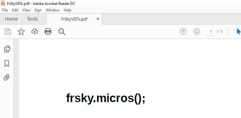

when I opened the FrSkyV8Tx.pdf file attached to your first post, it only contains 1 page with one line of text which doesn't seem to match the description:
Library documentation, updated 2020-11-11 Now includes more detailed API descriptions of all
the available library functions.
(8.31 KiB) Downloaded 3 times
Would you please check & reload if necessary. Many thanks,

I don't really understood how that happened. I edited the document using LibreOffice Writer and then did "Export as PDF..." It looks like it exported just a selection rather than the whole thing, but I don't remember ever having selected just the "frsky.micros();" part.
Anyway, I've just done it again and reloaded it. Hopefully now fixed.
