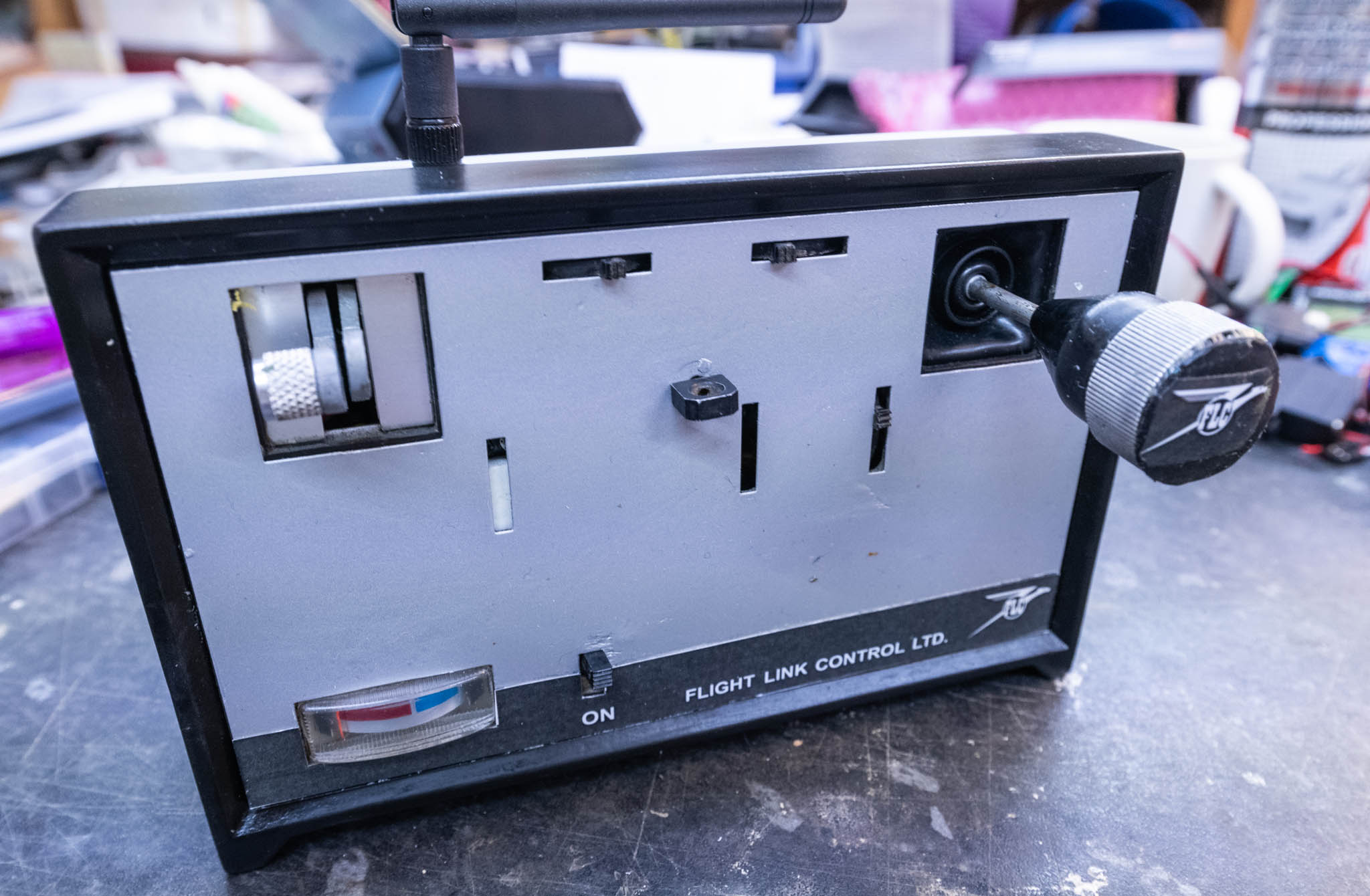

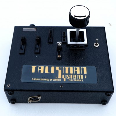

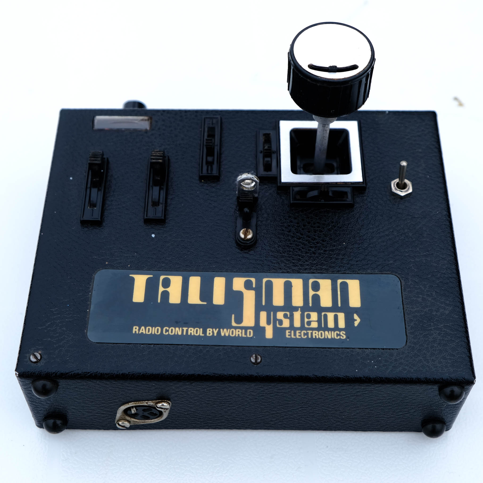

Another variation on the Mick Wilshere/Pete Christy World Engines UK Talisman.
This is a one owner example that dates from 2000 (?). It is one of three owned from new.

Wow! Haven't seen one of those in a while! In good nick, too!

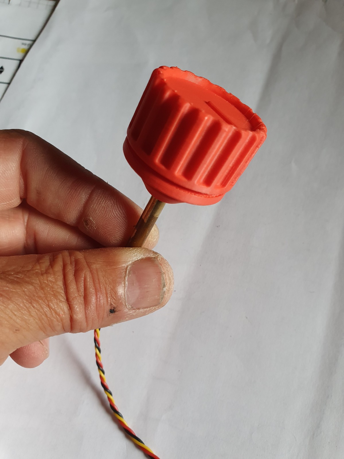

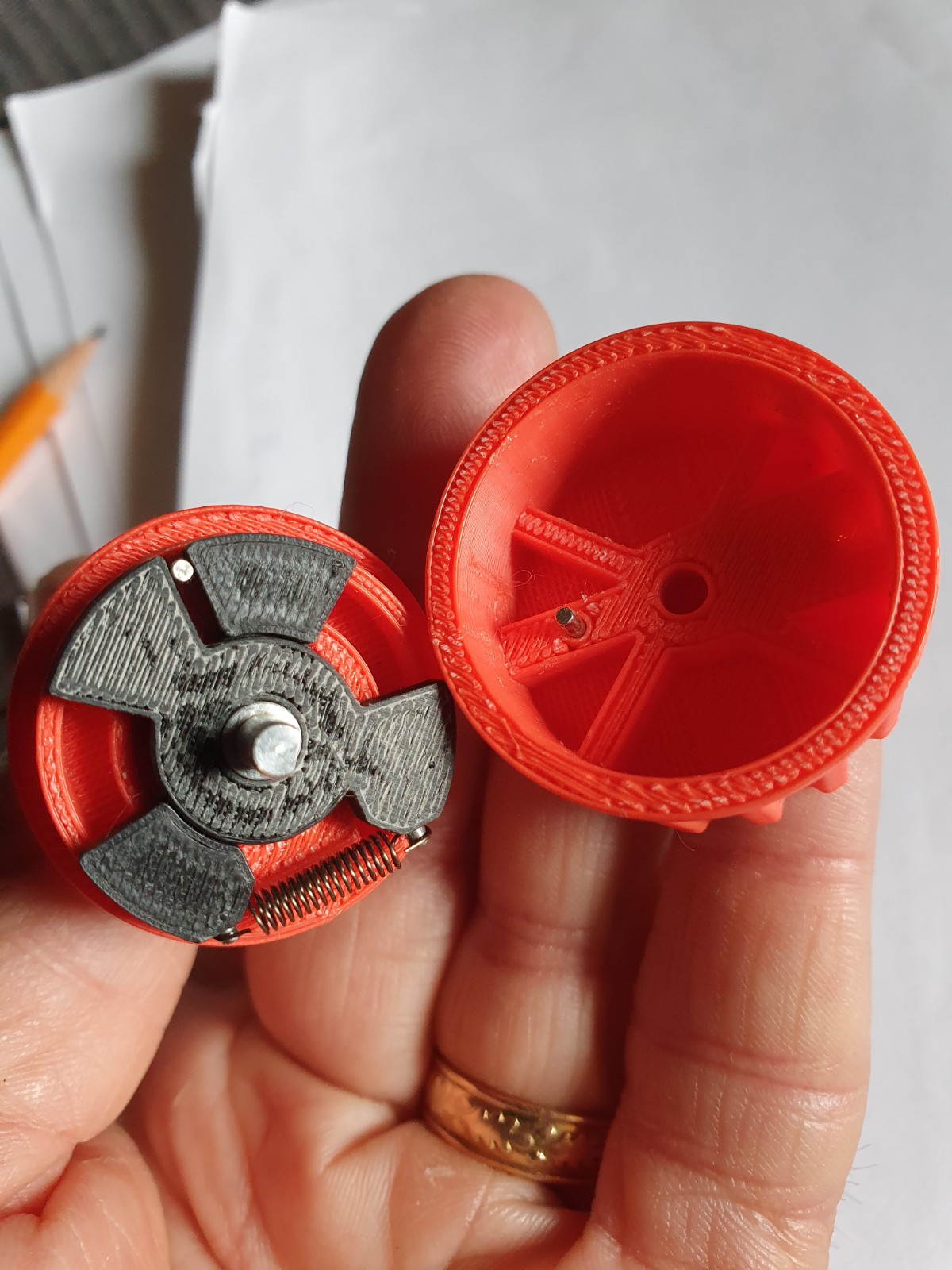

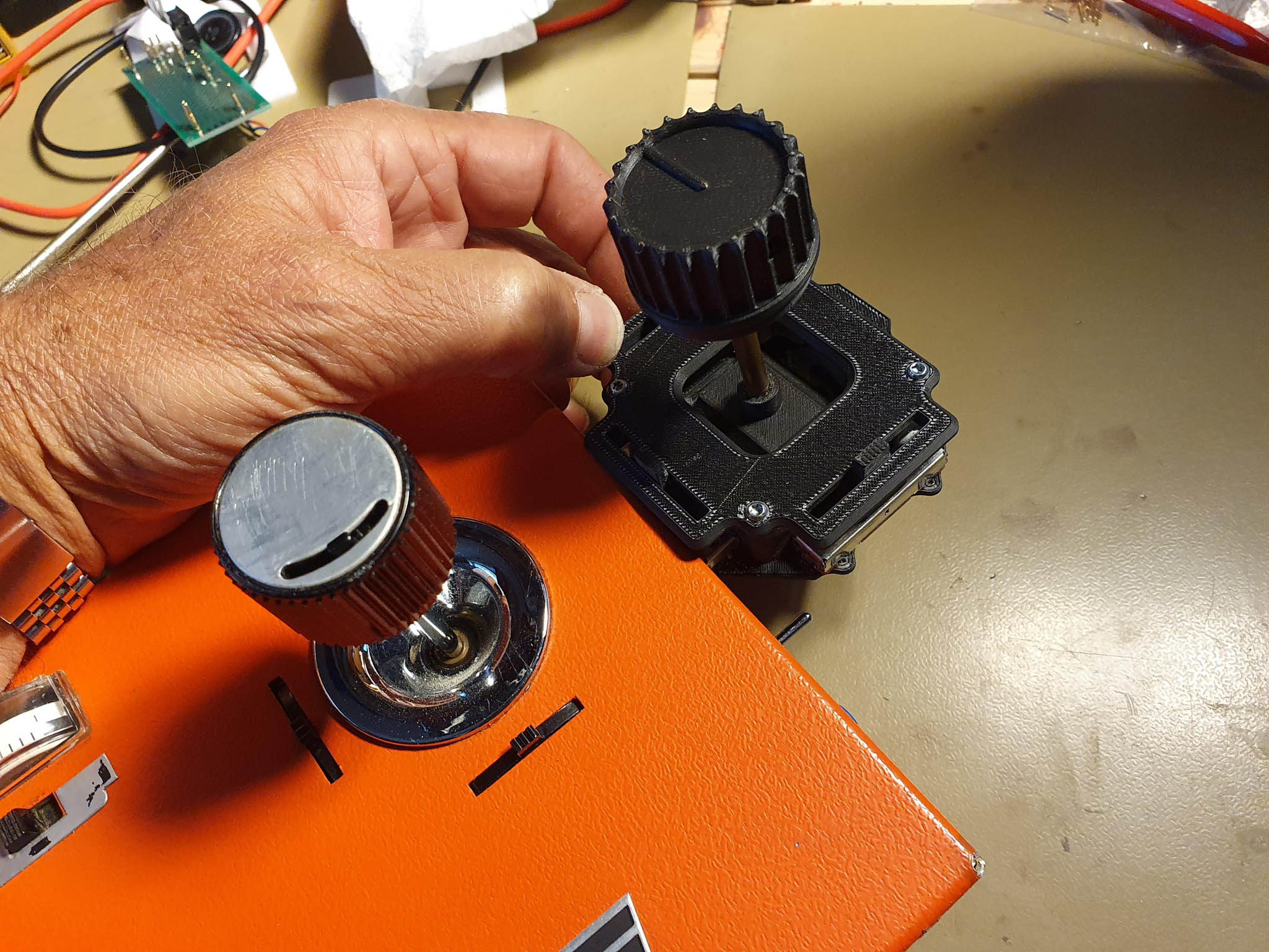

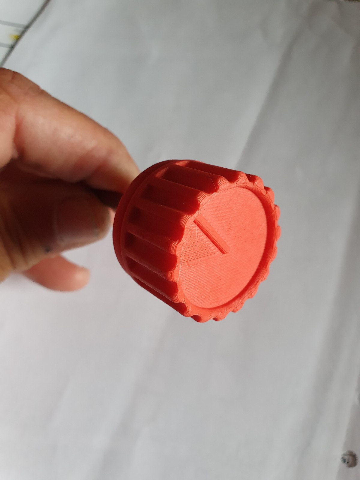

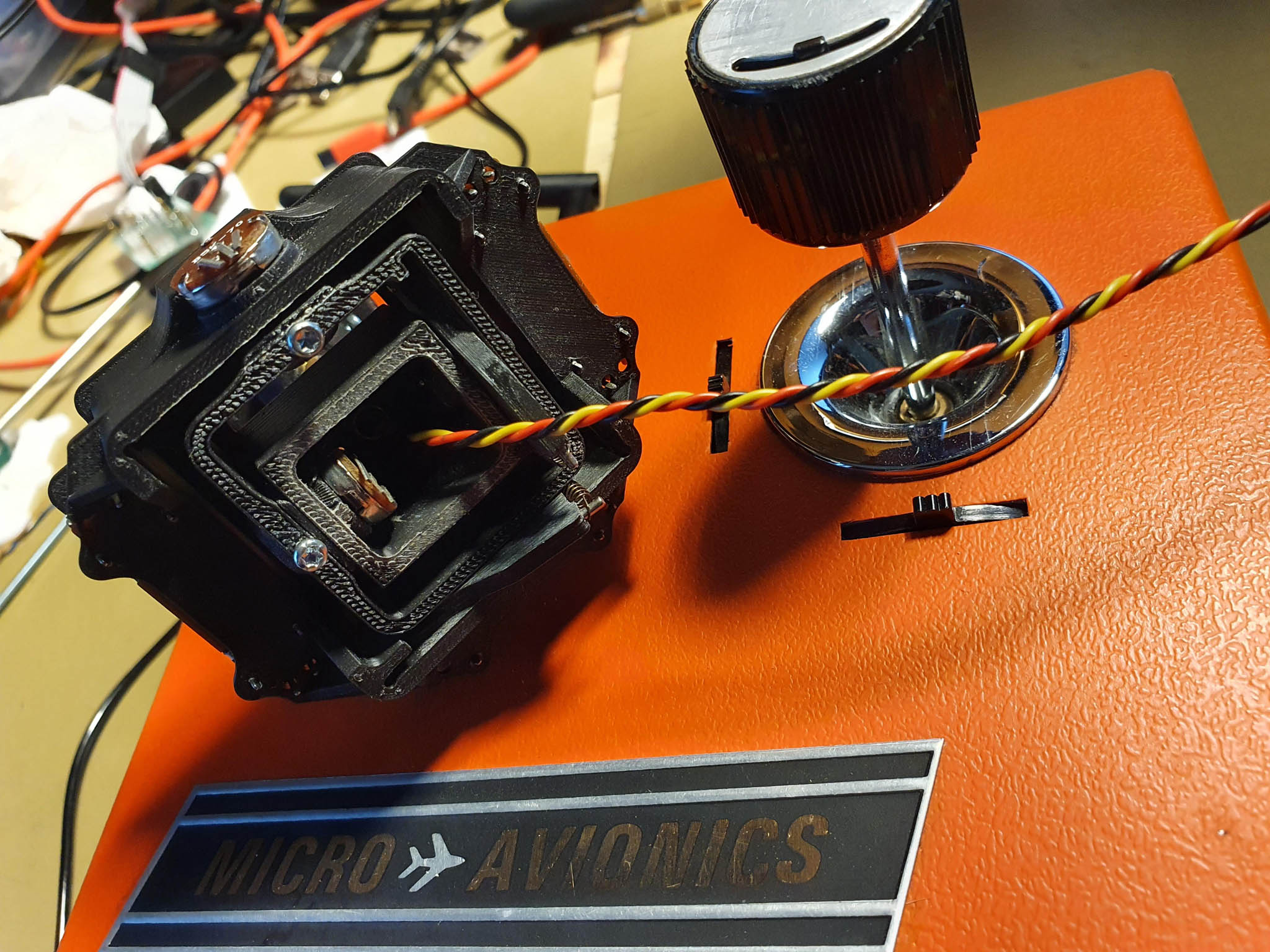

I still have also a few single stick Tx left like a Micro-Avioninc and a Kraft but I had to do this!
The knob fits nicely on my stick project

Wayne: Yes, its a 5044 encoder. These were good little encoder chips, once you managed to suppress the RF pickup they were prone to - especially at 459 MHz! We had to build them with a double sided PC board, with an earth screen under the chip!
There is a switch marked "throttle mix", another unmarked switch, and a pair of sliders and associated trims on the top of the Tx!
I think it was intended for a twin-engine setup, with the ability to separate the throttles if desired. But I could be wrong!

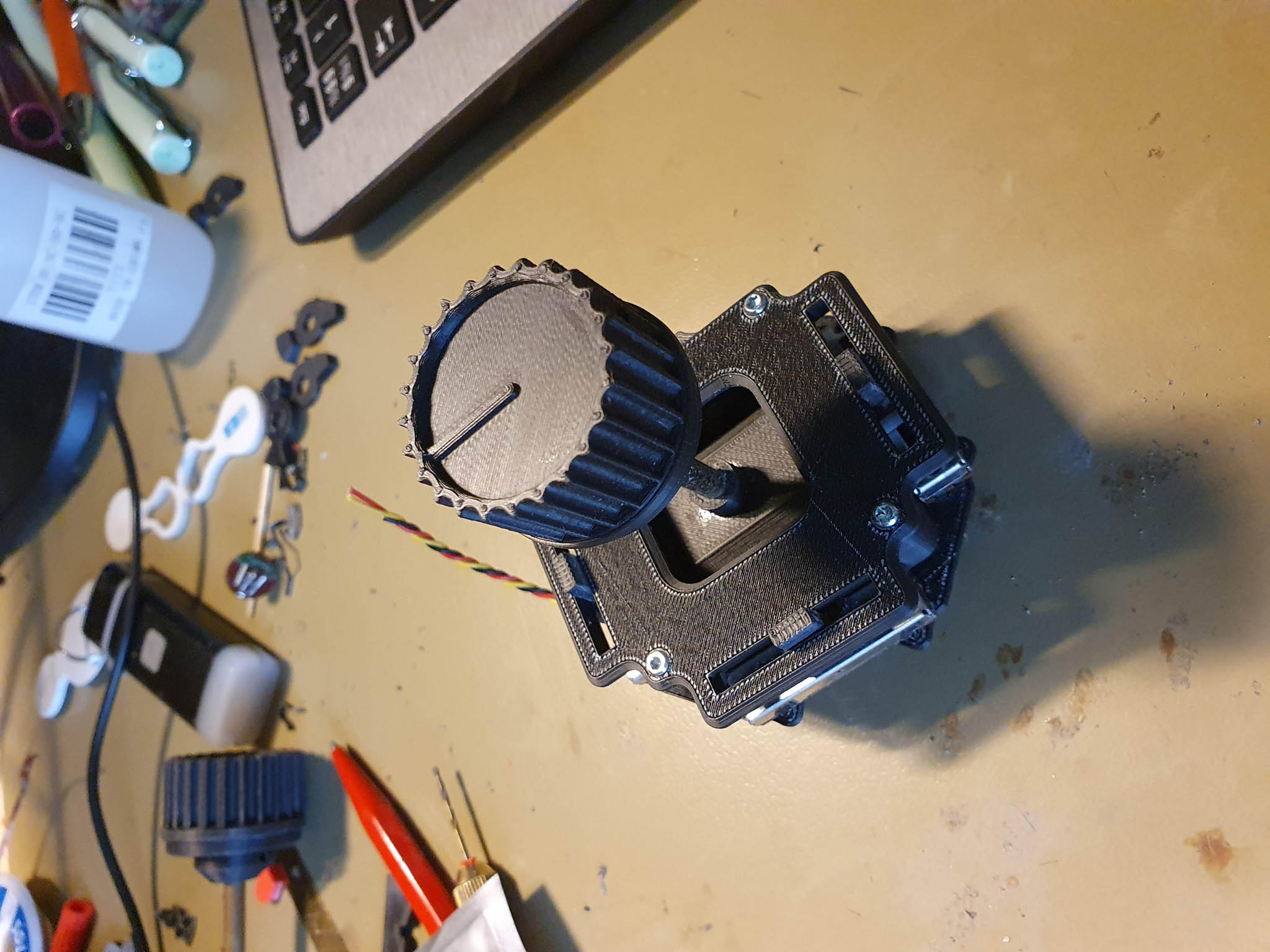

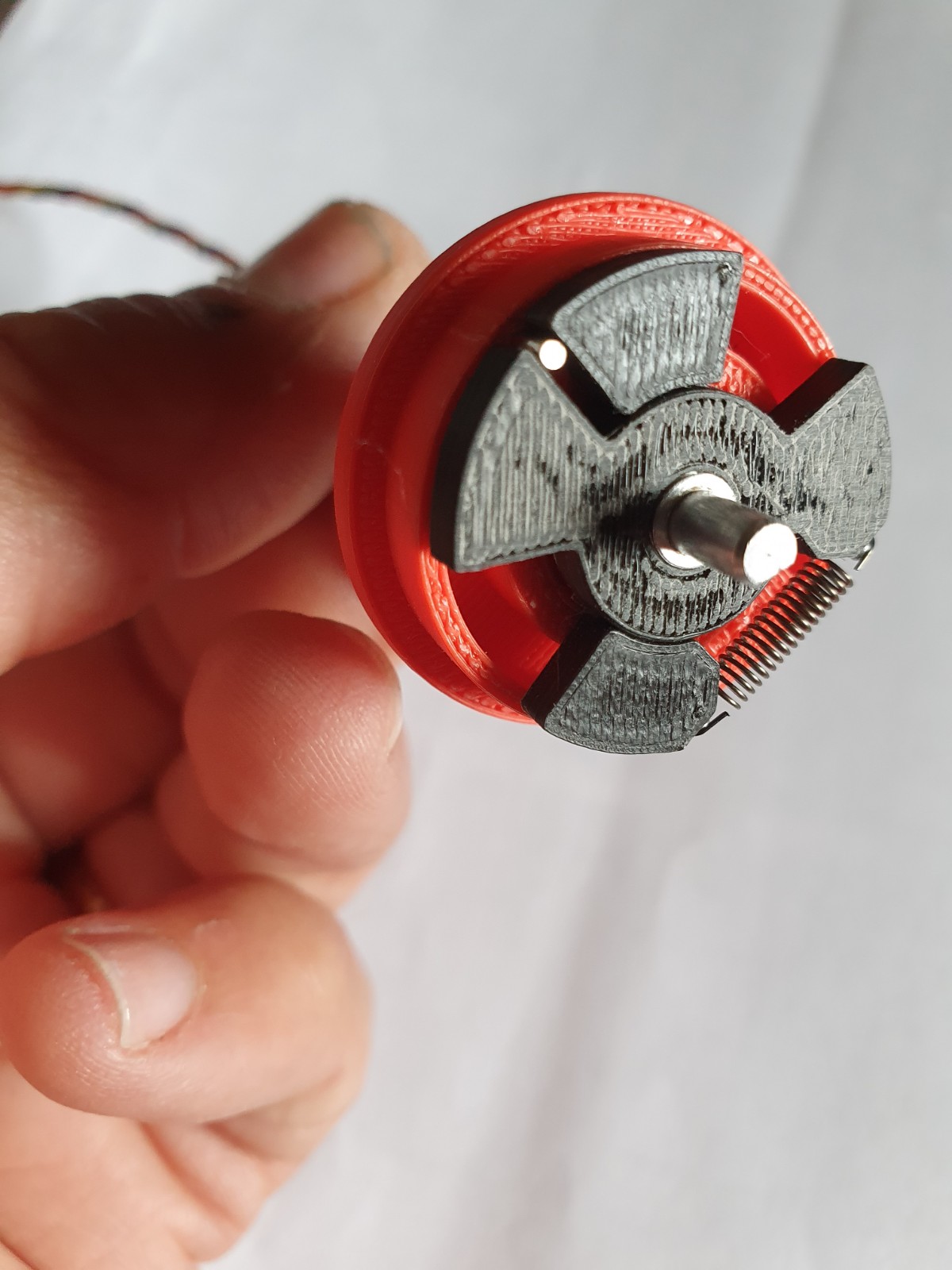

Tobe's Odd Ball is awaiting to get a case so tomorrow it will be time to cut & bend some 1 mm aluminum plate but first I have to decide the layout. Standard like the Micro-Avionics or narrower like the old Heathkit. Need also to make a decision concerning the springs to be used. The rudder trim is the 3rd trim around the stick.
Size wise the Single Stick is comparable to the one on a Kraft or the Micro-Avionic but slightly more shallow.

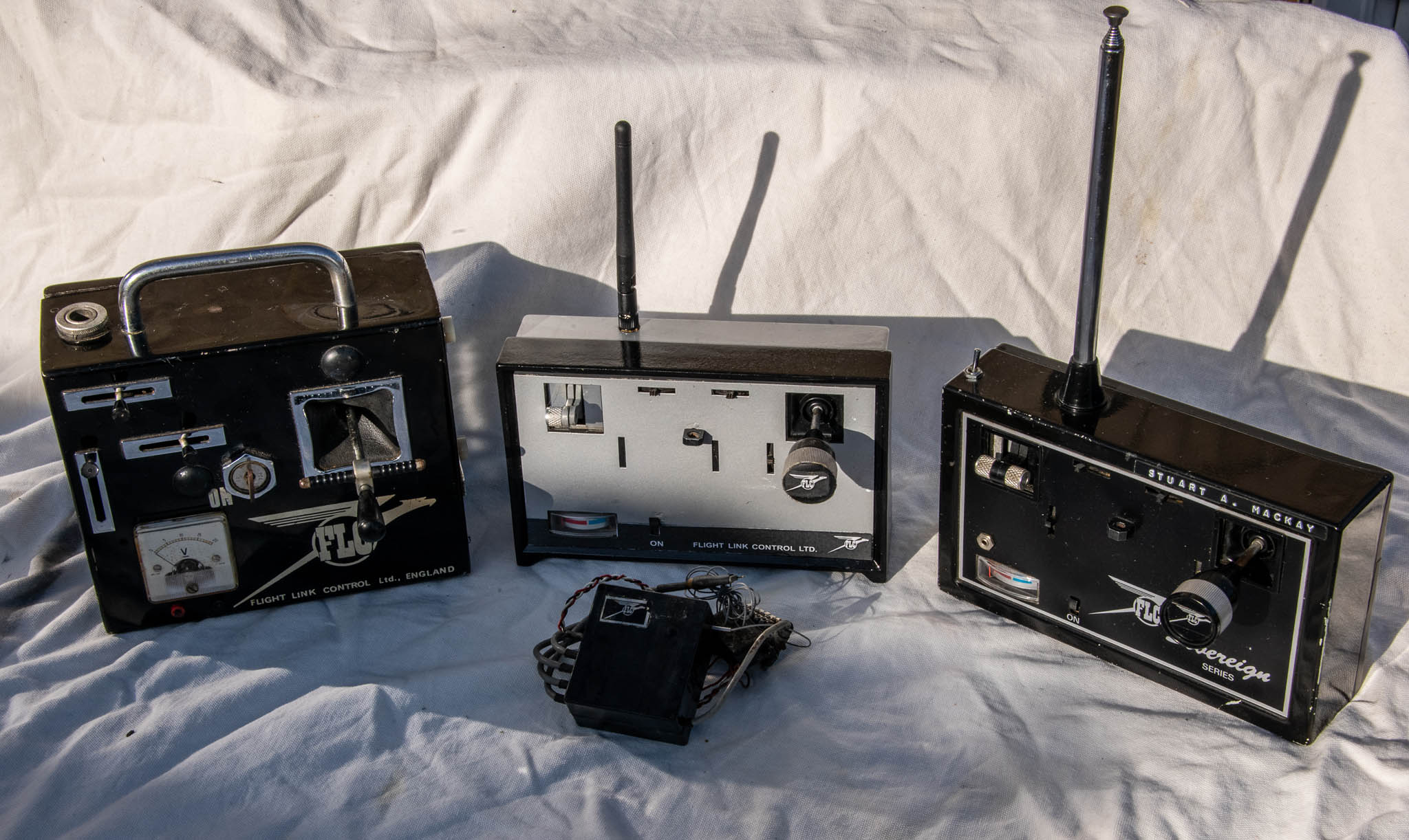

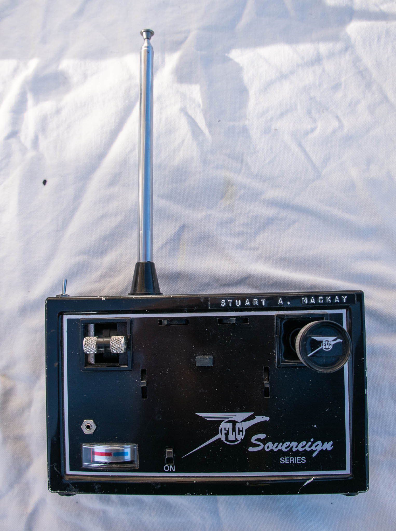

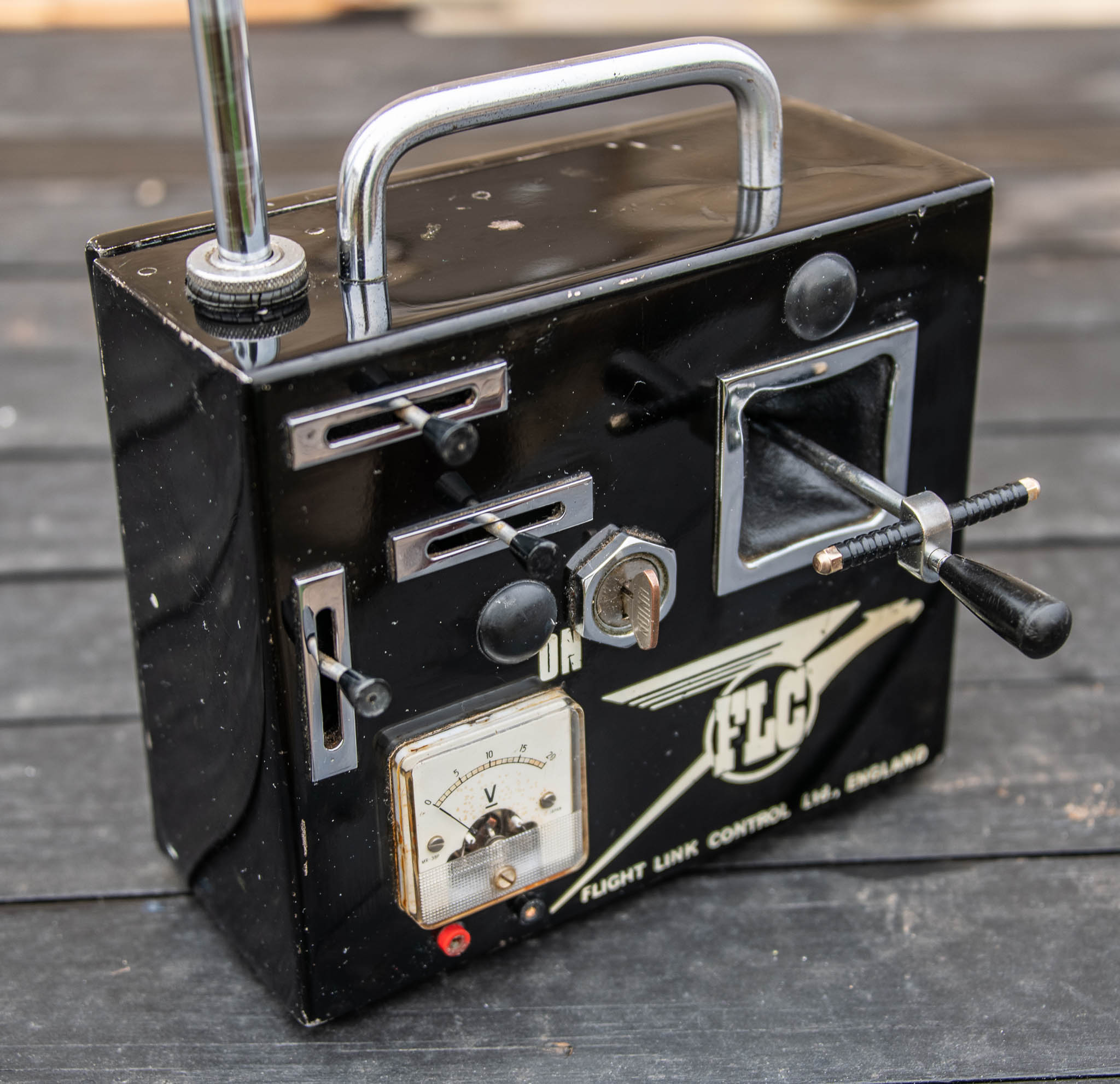

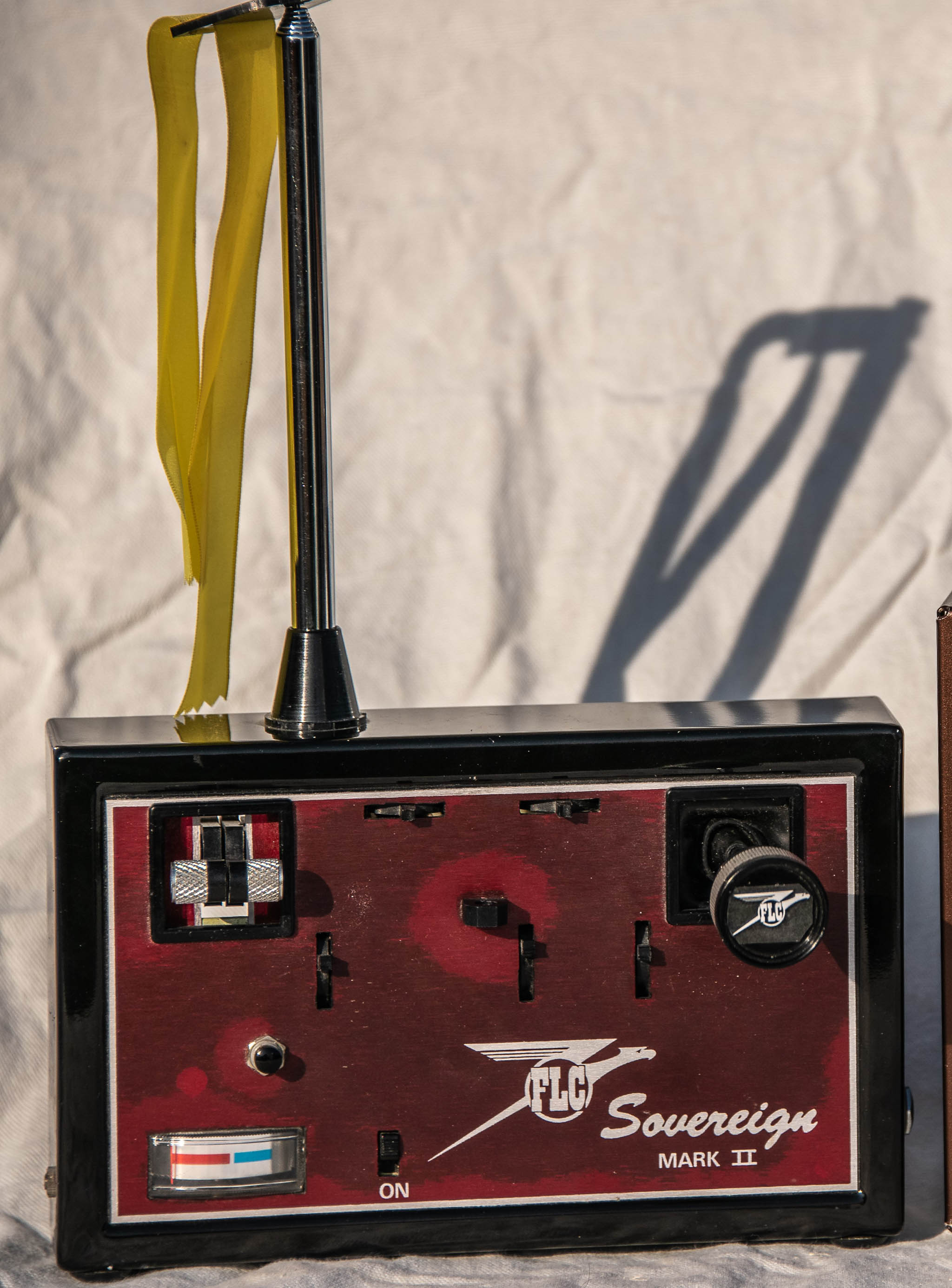

Flight Link Single Sticks from Series 3, Series 4 Restomod, Sovereign Mark 1 and Sovereign Mark II

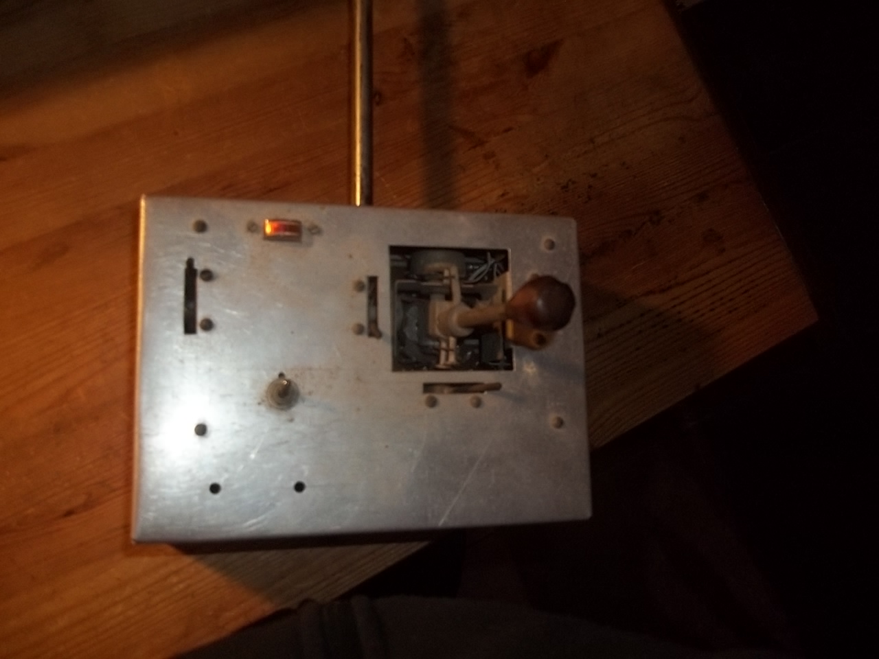

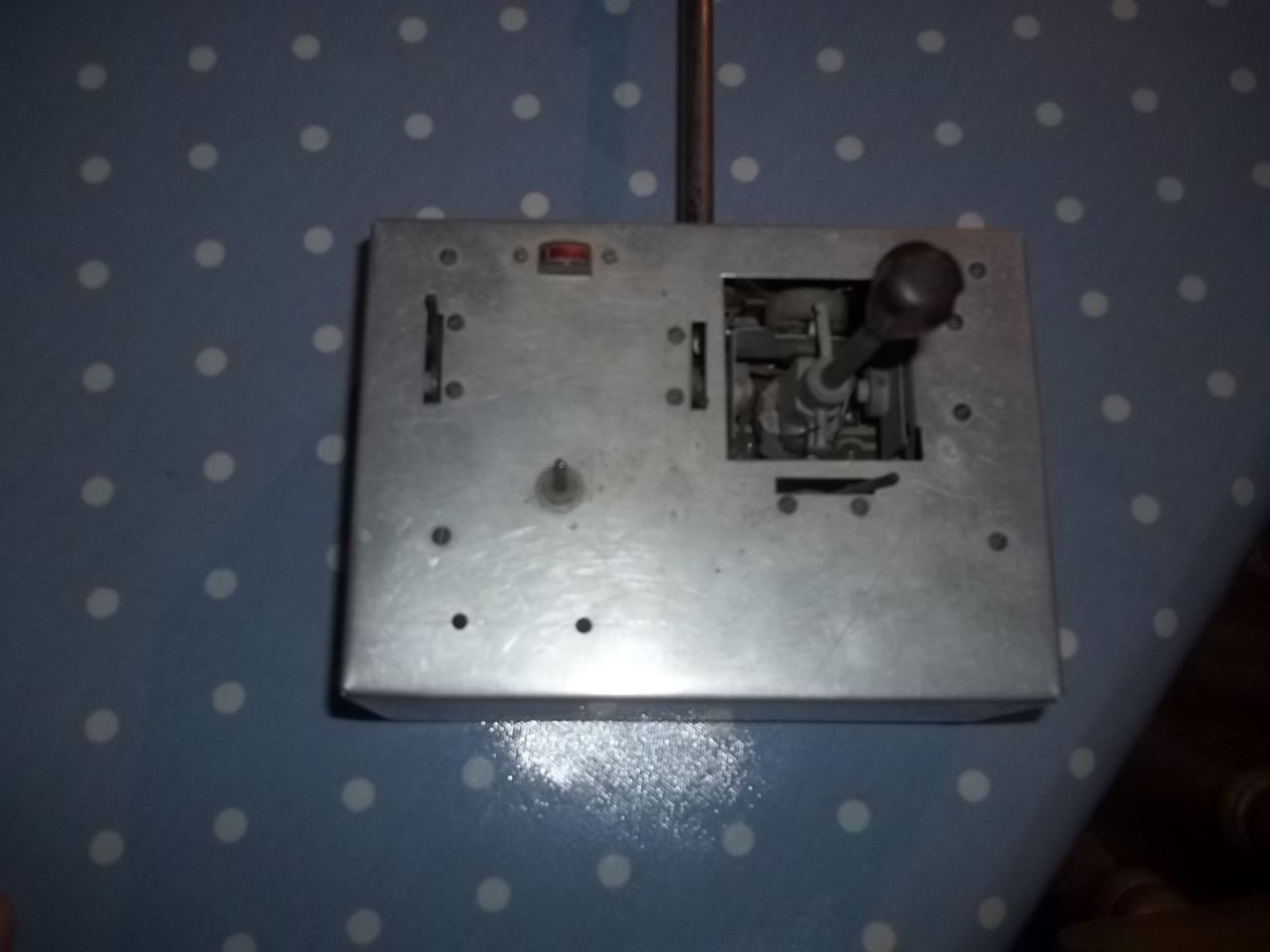

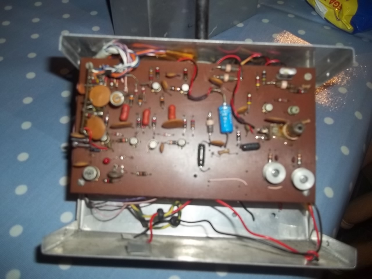

In the hunt for a rumoured Flight Link radio for Stuart belonging to one of our club members who passed on some time ago I have come across this single stick radio with a couple of flight packs, I think the deac might need to be cycled a few times though, luckily the batteries had been removed from the TX so no corrosion! . I have to assume it is completely home produced even including the stick units. Unfortunately the Flight Link set has not surfaced and none of us in the club who are left alive including those who cleared his kit can remember it. I would off been the one who would of recognised it and would have asked for it but I was not a member then having left the club to go Classic Scrambling. Perhaps one of our more learned members might recognize it and fill in some more details. Also a rather tidy REP Gemini TX and RX has turned up, also with the battery removed!

The receiver and servos are Sprengbrook. The Tx is either home design, or possibly a Digitrio? The Digitrio was a project in the American RC Modeler magazine. The Tx exterior bears a strong resemblance, and they did do a four channel single-stick conversion for it. All the plans and circuits were in the magazine.
That Sprengbrook receiver was one of the best 27 MHz receivers of its time (I have two of them). Its only weak spot was the SCS devices used in the decoder. These were very temperature sensitive, and were prone to stopping working in sub-zero temperatures (don't ask how I know!).
The servos were originally used in the American MicroAvionics sets in the late 60s. Brand Microprop in Germany took over production for a while and supplied them to Sprengbrook.
