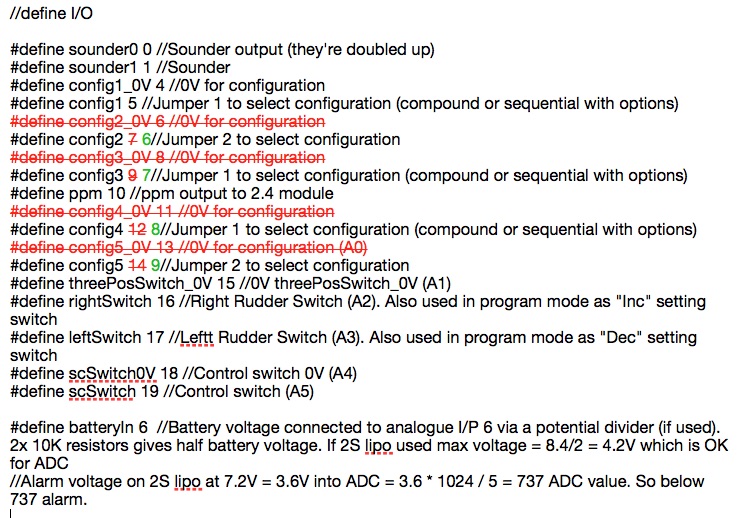

Question for Mike. I am not keen on the jumpers to set the programming/operation mode, I did order the wrong ones without a proper grip, and generally don't like to have to keep them at hand for changing settings.
I am considering fitting dip switches (5 or 6 fold) instead, soldering them directly on the ProMini (pins 5 thru 9) with one side and connect the other sides together to pin 4.
For that, I need to make some changes to the sketch. Now, i know a bit about coding, but it doesn't go very deep.
This is what I had in mind, can you please check and confirm that it is all I need to do?: Thanks,
Max.

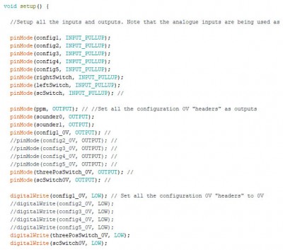

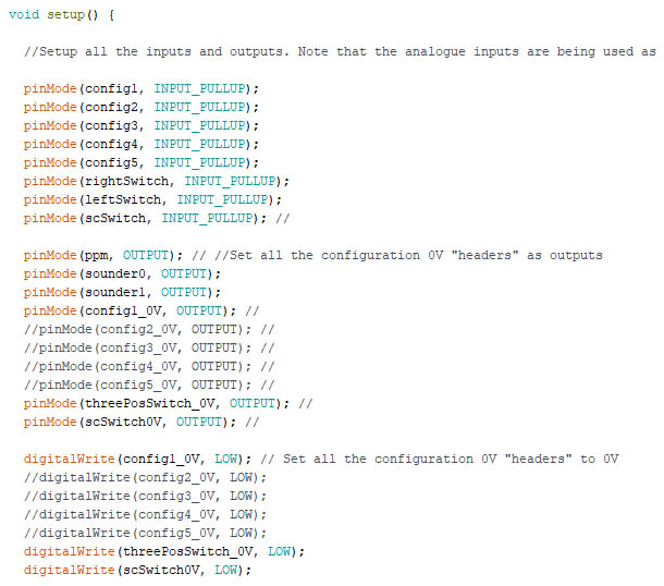

You will need to make a few other minor alterations for the Arduino program/sketch for it to compile properly. You will need to comment out the "pinMode" and "digitalWrite" for the redundant config*_0V outputs as in the attached screen-shot.

I am altering ( a copy of) the sketch for the use of DIP switching in accordance with your instructions.
All is well, but line 36 caught my attention:
#define batteryIn 6 //Battery voltage connected to analogue I/P 6 via a potential divider...etc.
I know this is pin A6, but is the pin number defined correctly? It seems to conflict with line 21 which defines the 0V for jumper 2. Or does the analogRead statement further down looks for A6 automatically? Trying to learn here....
Max.
Max.
- Posts: 776
Re: Yet another Single Channel Encoder
Hi Max
With the Arduino Pro Mini (and Nano or other ATmega328P based Arduino's) you define the digital inputs 0 - to 13 and 14 to 19 if using the analogue inputs (A0 to A6) as digital inputs. The analogue inputs (ADC) are defined 0 to 7. A6 and A7 can only be used as analogue inputs and are only available on surface mounted ATmega328P chips (Pro Mini and Nano, not Uno).
So you can define both digitalRead and analogRead from 0 to 7 without conflicting.
