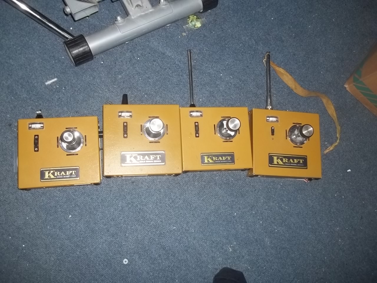

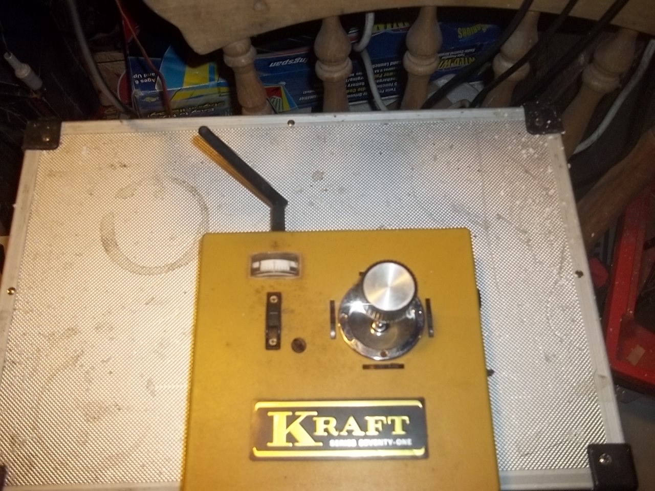

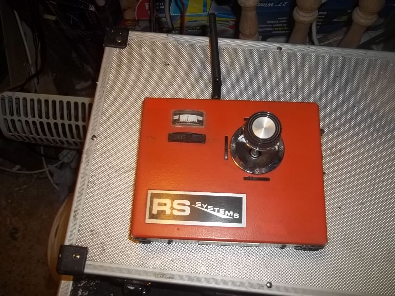

A few more single stick radios I have acquired over the years.

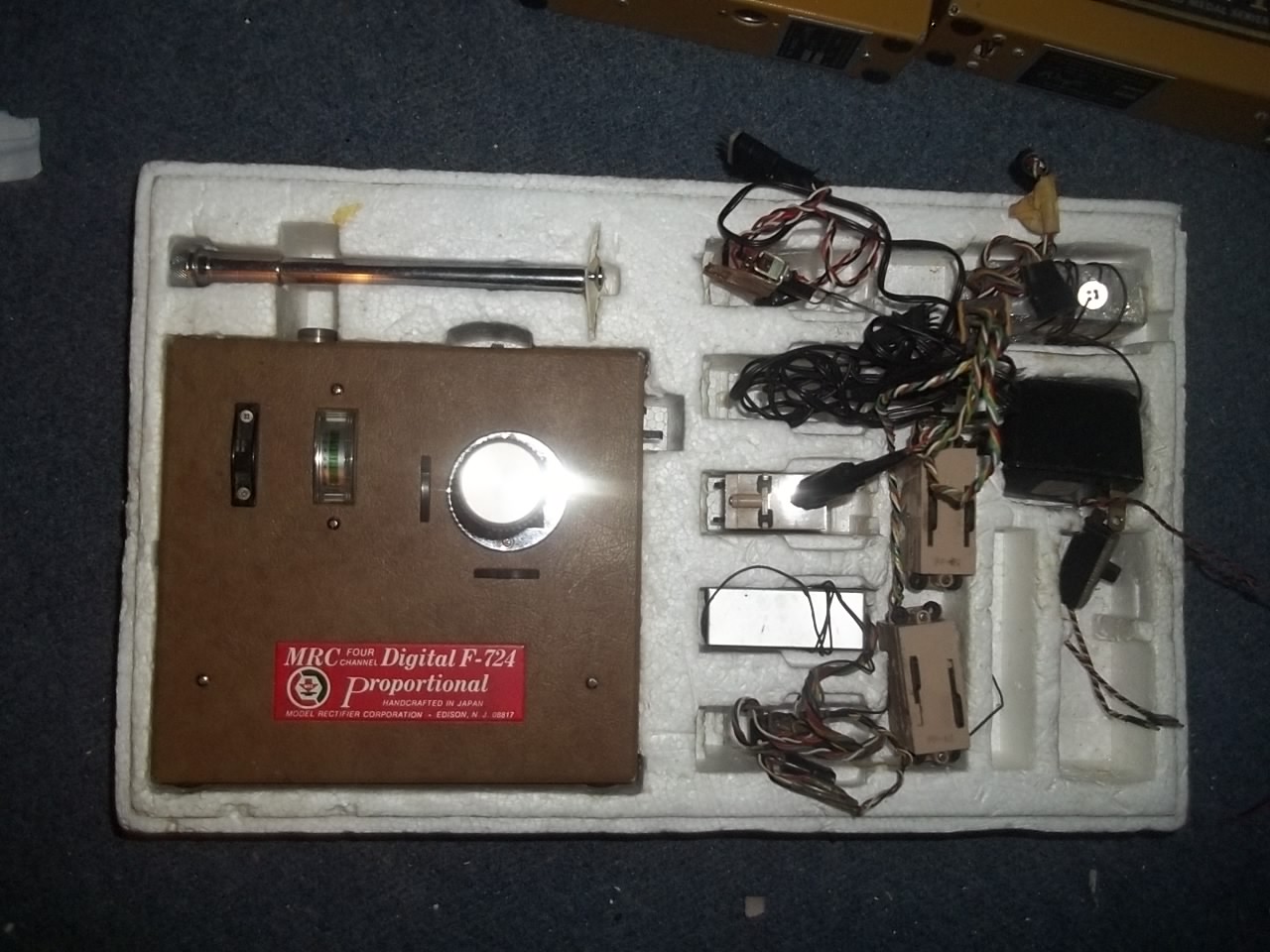

And another one, quite a few more to come yet!

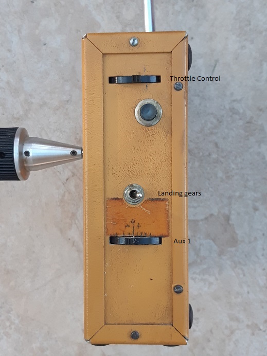

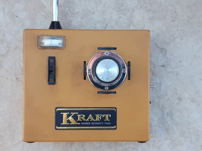

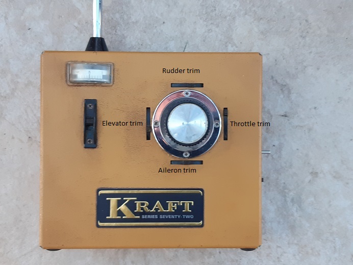

Ah! :P Stormer, I have just aquired a Kraft single stick similar to those in your picture.
It has been well used and is a bit grubby but I think it will clean up OK and make a nice conversion. However it is not in working order so.......... Can you please confirm what all the various "trim levers" do? The Elevator, Aileron and Rudder trims are obvious but what is the trim on the right side of the stick for? On the side of the box, I think the top trim lever must be the Throttle control(?) but what are the button, switch and lower trim lever? (Channels 5 & 6?).

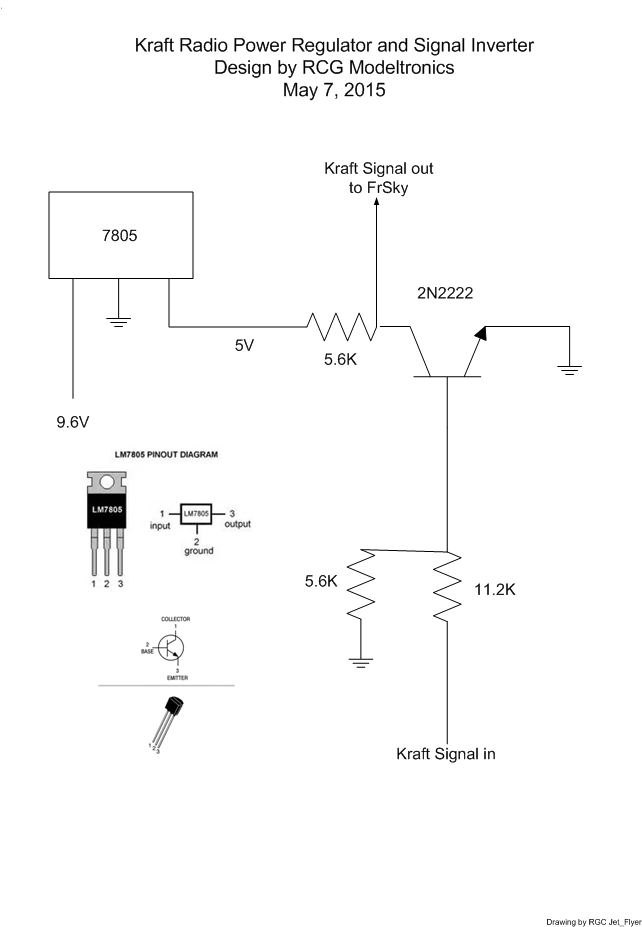

See pictures. I have included a few manuals...if I dig deeper I would probably find more! Used to service Kraft in the early 80's
If you make conversion of a Kraft Tx keeping the original encoder you need to invert the PPM signal thus I have included schematics for an inverter.
To remember also the channel sequence don't follow todays standards so to benefit of a Rx fail safe you would need to remap the channels and this needs to be done not by switching just the wirering but at the encoder IC as Kraft balance many functions with several resistors of very high tolerance.

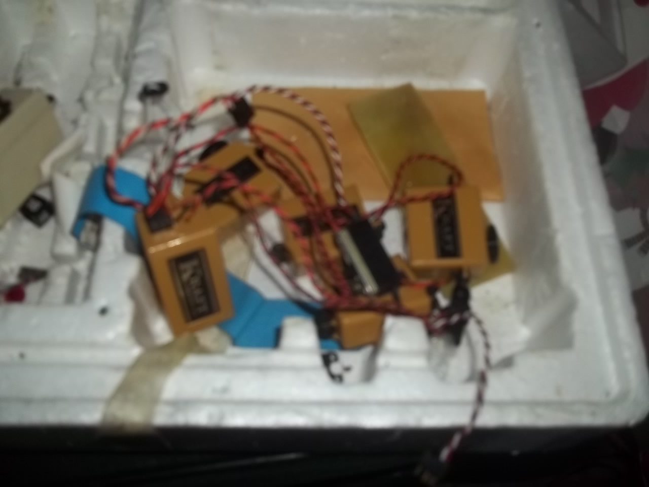

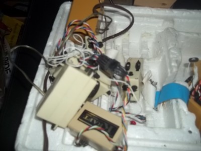

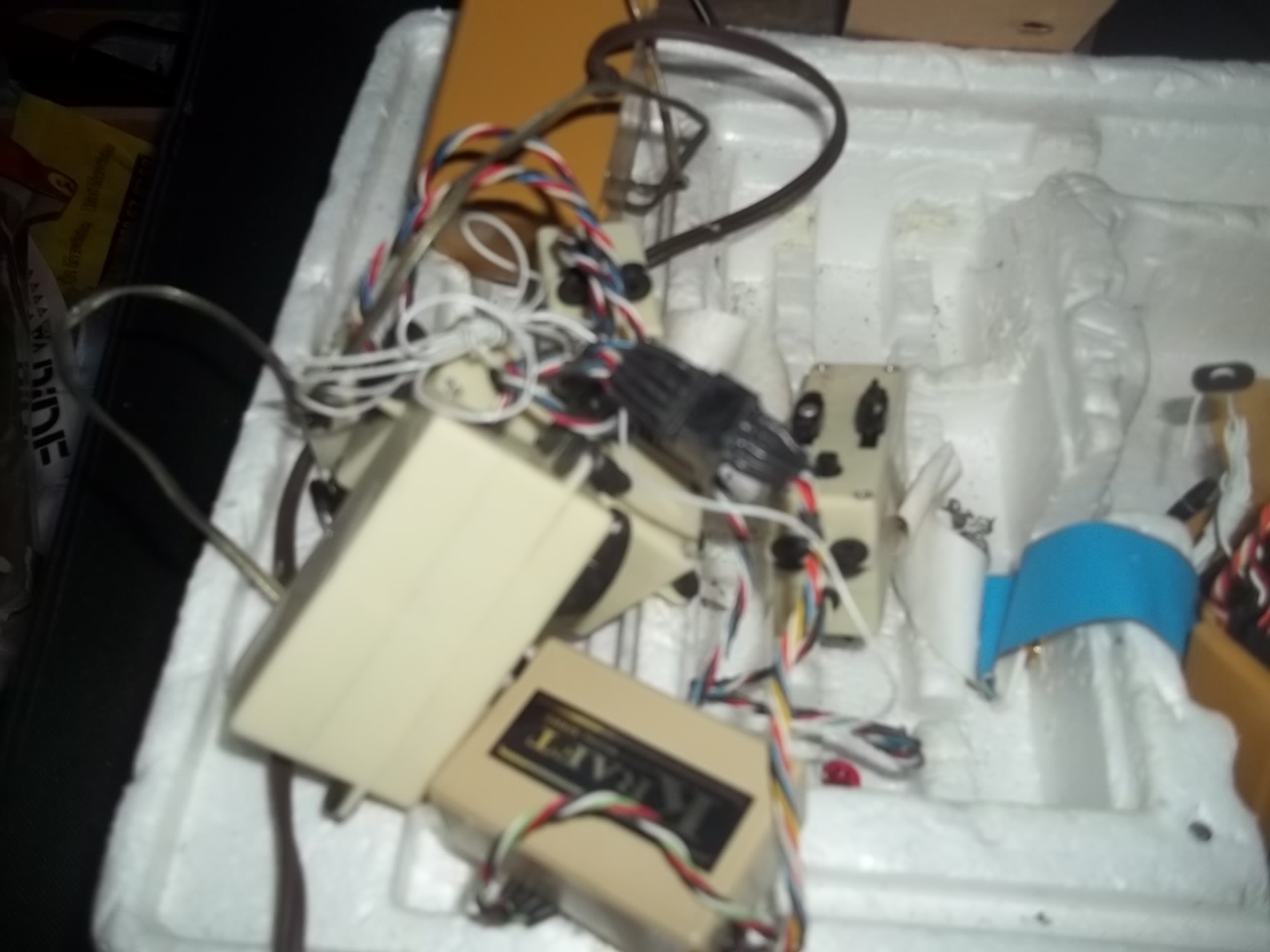

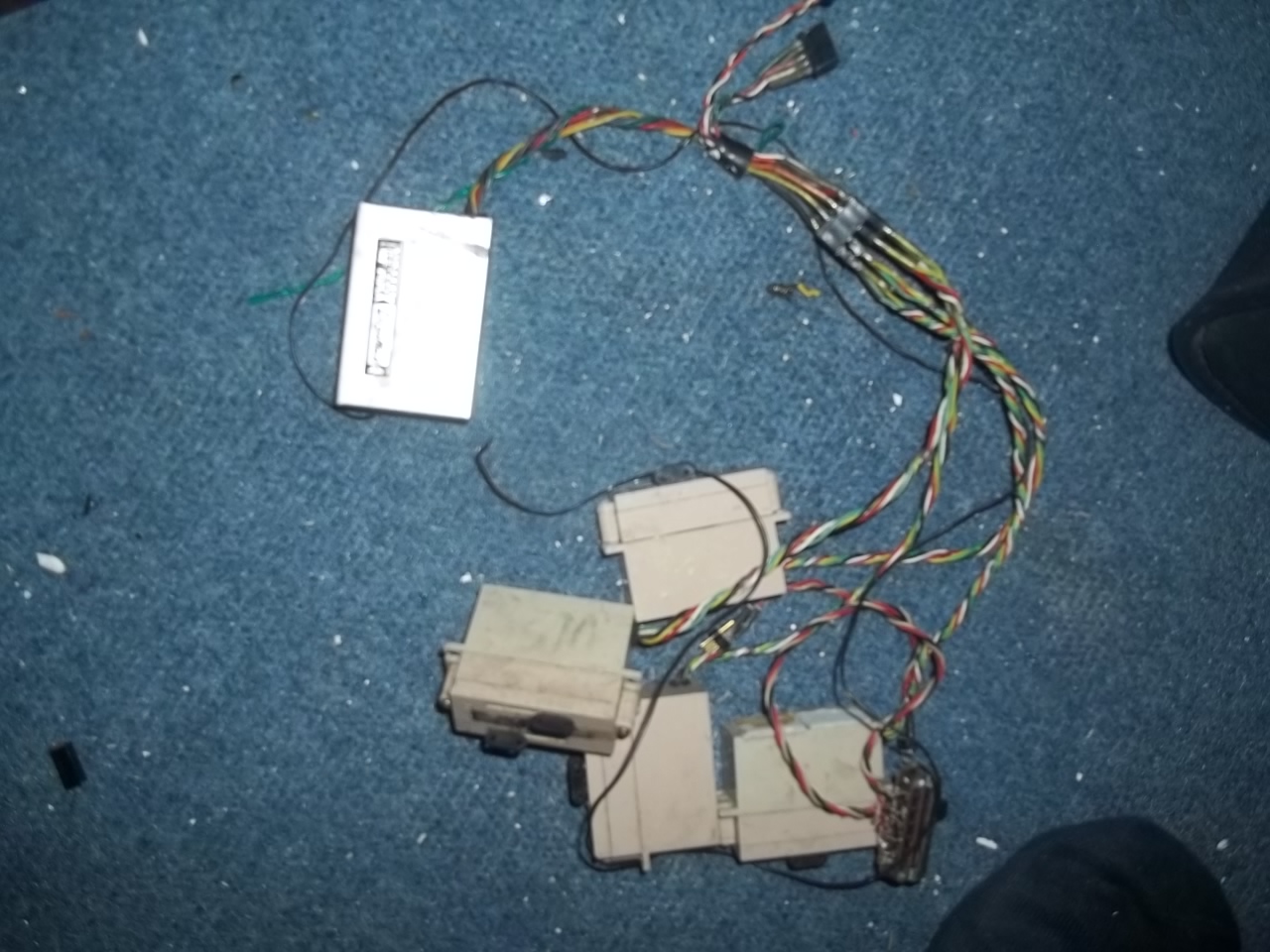

[attachment=2] Assorted flight packs

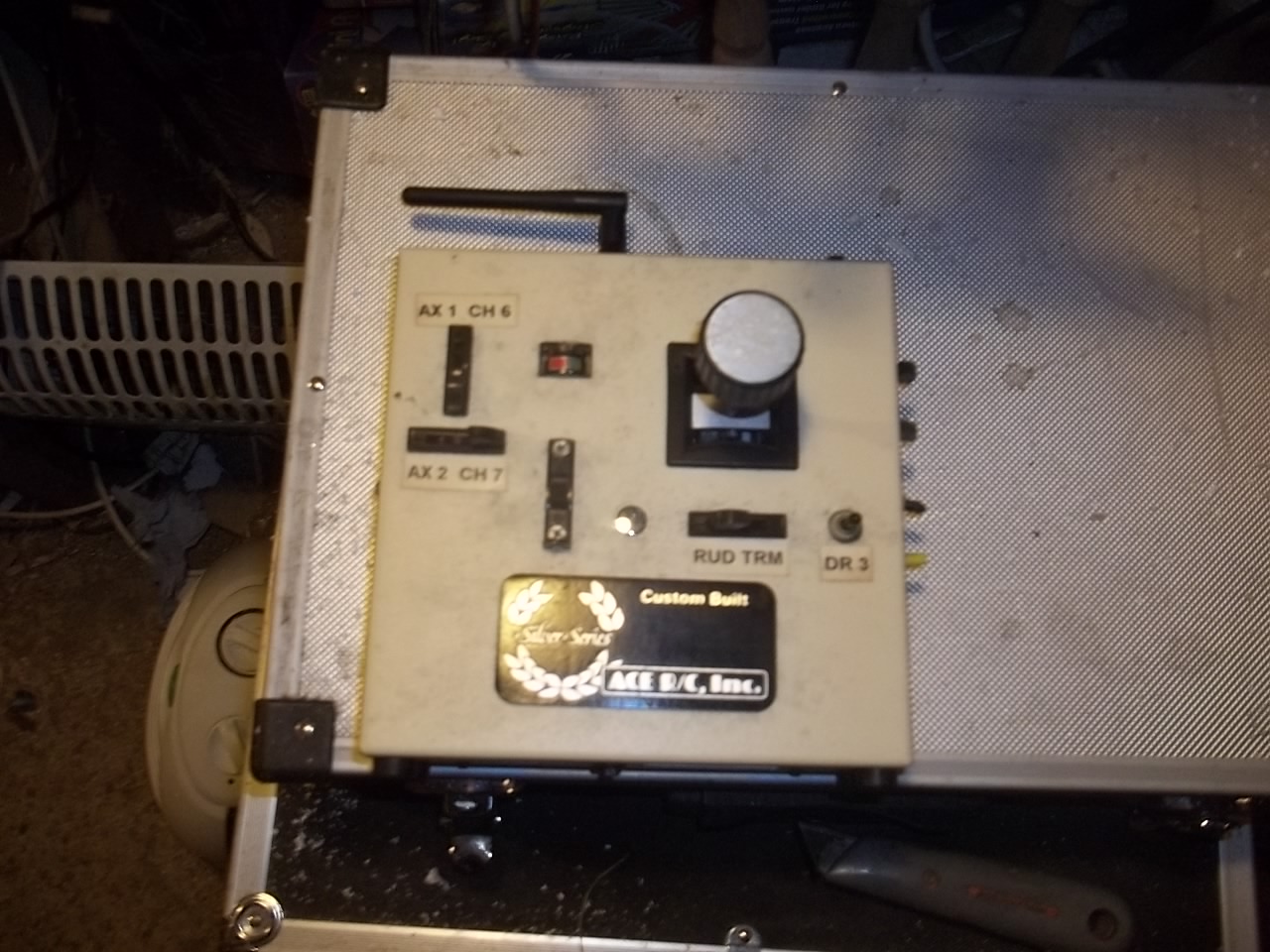

And a few more, these are 2.4

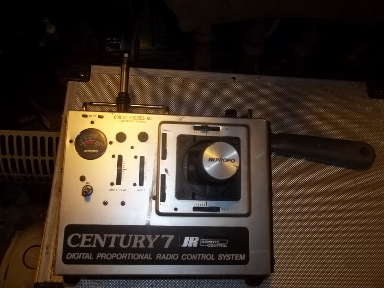

Another 2.4 conversion, the two JR have a module hole

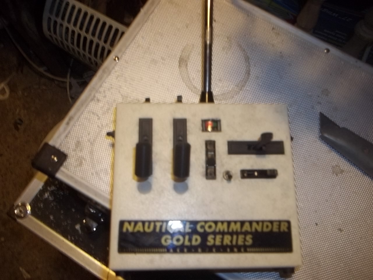

Not quite single stick
